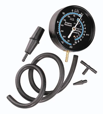

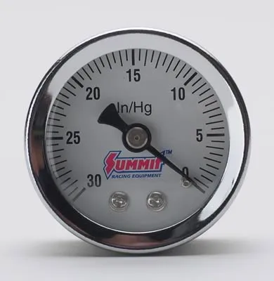

how do u check for vac. numbers? i just dropped a 347 with ford racing x-cam with 1.7's. idle is supposed to be fair, but at idle sometimes the rpm tach is all over the place and wants to shut off. sometimes the rpm shoots up to 1500 then drops then back up again. i dont have a/c, smog, air canister i think thats what its called. any help would be appreciated....thanks
Vaccum/Pressure tester at summit/autozone or a little gauge
