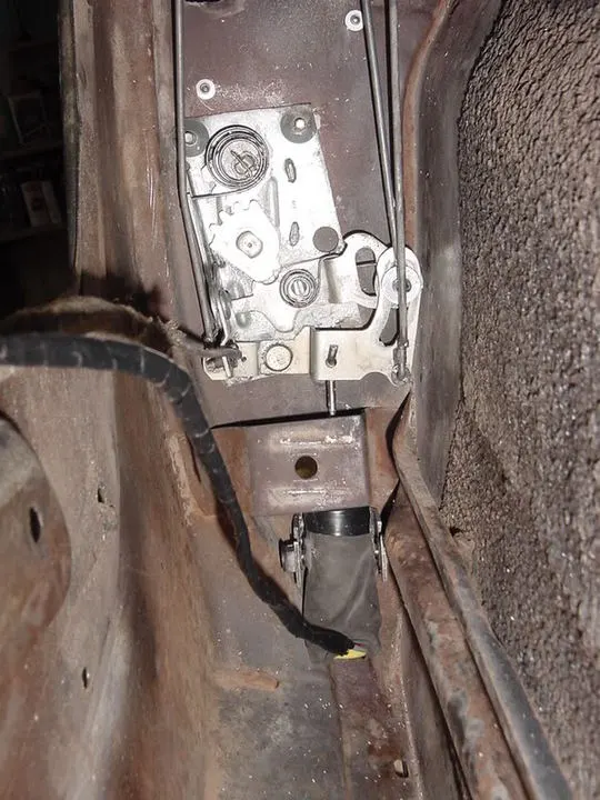

I installed a keyless entry system from Electric Life. Here is a photo of the bracket I made to hold the actuator to the door, there are other photos of the install on page 7 of my CarDomain photos. I used a plate instead of the straps to eliminate any chance of the actuator moving around after install. Once you've gone thru the pain of making the actuator rod and getting it adjusted correctly, you will understand what I'm talking about.

We are currently in the process of installing the Electric life kit in our 65 Mustang (AdanInChains). I wanted to simplify the adjustment process, so I fabricated a small bracked that mounted the actuator and was able to be screwed to the new door latch by drilling and tapping 2 8-32 screws into a small flange on the door latch. On another thread, the poster comented about the fact that the actuator had a longer throw than the locking rod does. How I dealt with that was by adding two small "cable stops" to the rod you use to connect the actuator to the lock rod and allowing the actuator rod to move freely thru the small clamp assy which attaches the actuator rod to the lock rod on the latch. By using the stops, you can control how much throw is provided to the lock rod. This also allows you to adjust the actuator/rod easier and allows for intial adjustment out of the vehicle. You do have to be careful when drilling the holes. Unfortuantely, I am on travel for the next month or I could post pictures. The Autoworks kit is $300 and does NOT include a remote entry. I bought ours throw A1 Electric and got all of it for about $100

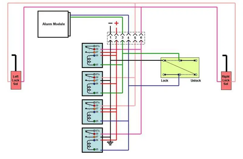

Here is how I wired mine.
The relays are standard Bosch type that can be had from eBay for about $10
The switch is a standard 80's Ford type lock switch
F

You should be able to do it with only 2 relays. (At least I did). Here's the schematic:
Tim65GT: Looks like you used seperate relays for the alarm locking/unlocking or the switch locking/unlocking. That isn't necessary with the correct switch/wiring.
Brilliant!
Where were you when I was wiring mine? lol
I got the 4 relay setup idea from 12v.com. It seemed to make sense at the time and I didn't try to simplify it any.
So the wires from 87A don't go to anything?
Do you just split wires A and B that go to the actuators or is this schematic for only one door?
87a goes to chassis ground (battery - ) that what that symbol means.
And yes, you just split the wires. You could use this same schematic for 4 door power locks.
