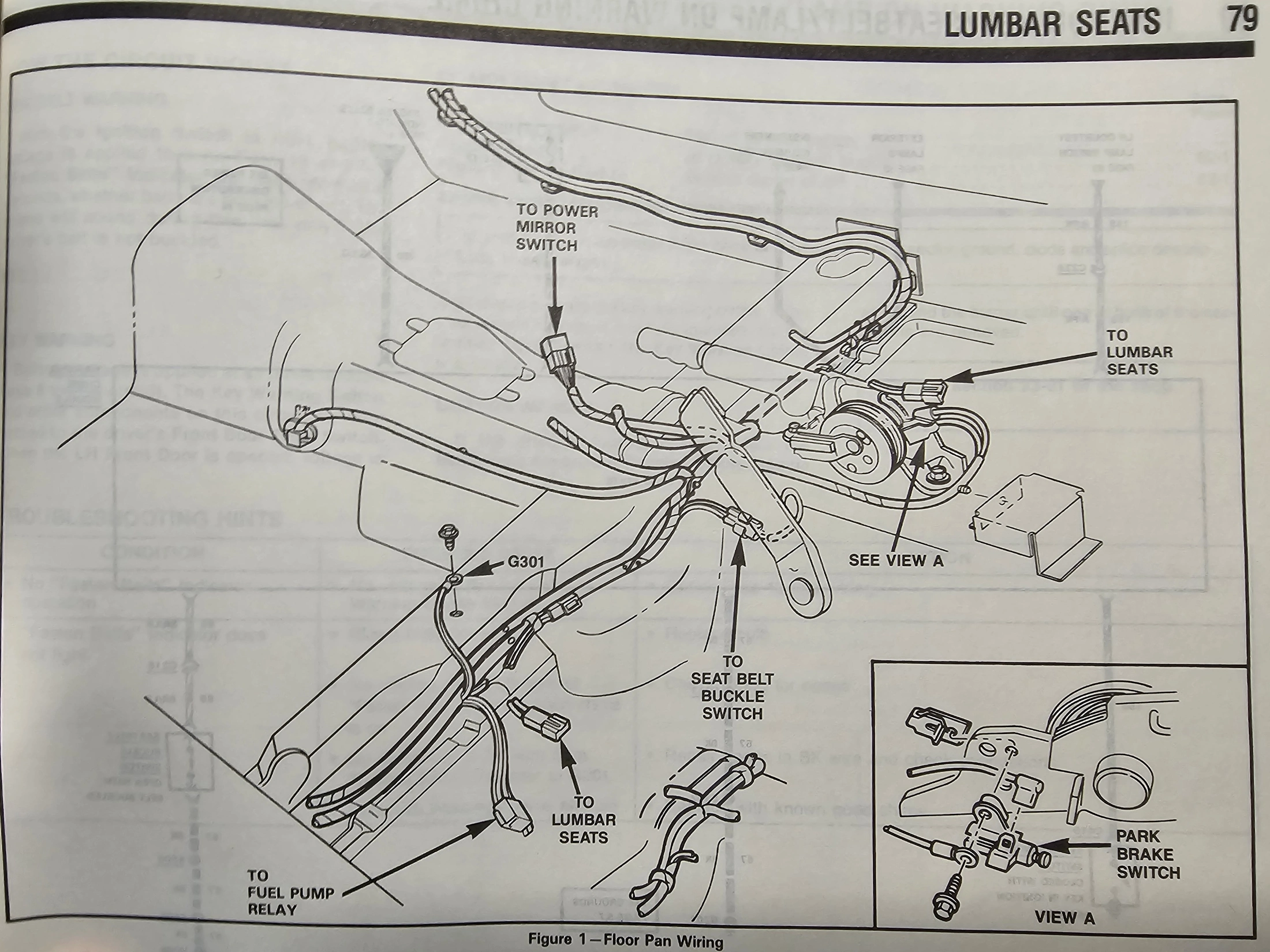

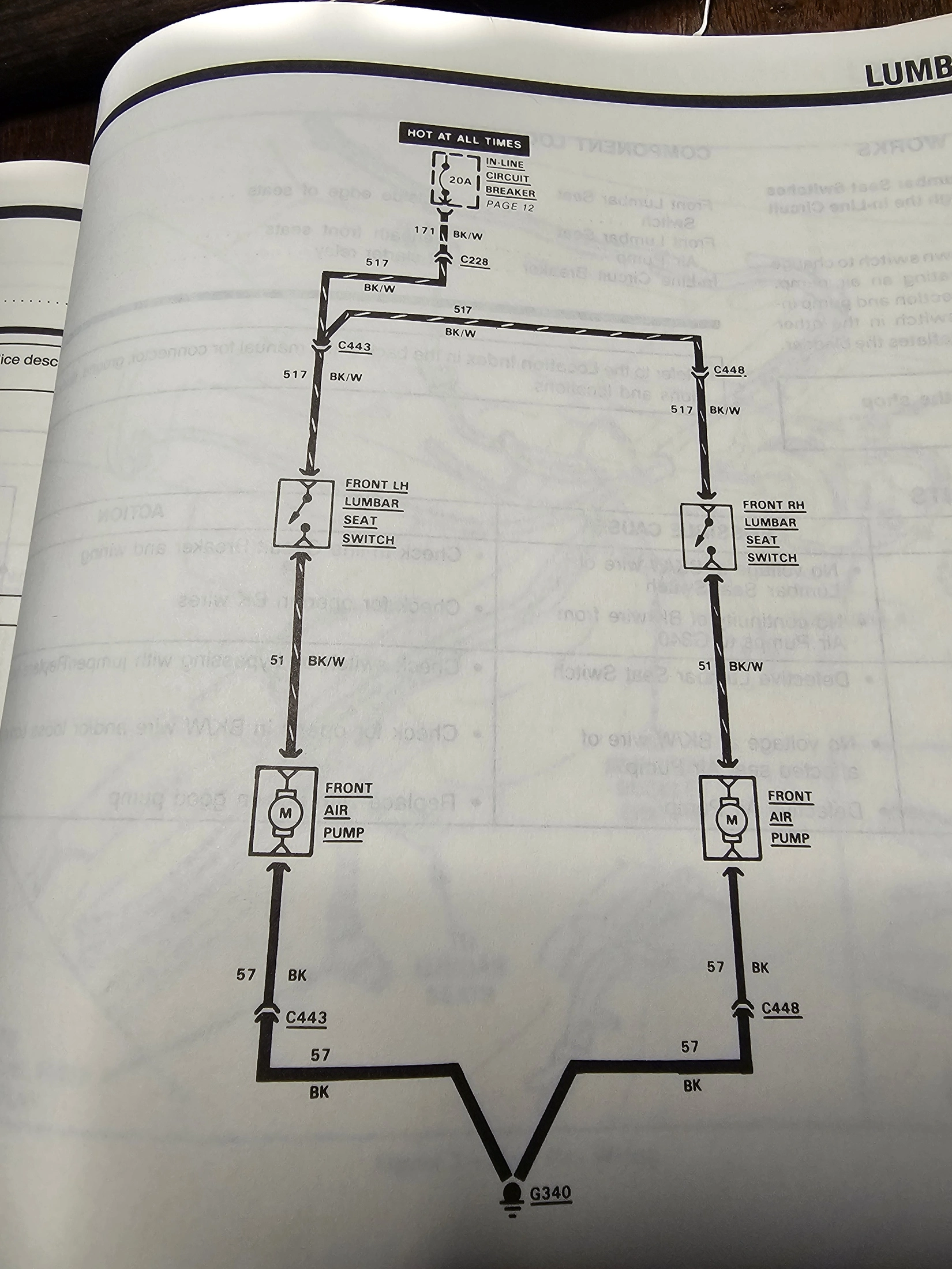

Noobz347 Stangnet Facilities Maint Tech... Er... Janitor Admin Dude Jan 4, 1985 43,587 21,749 234 Box behind Walmart Jun 7, 2025 #2 Jun 7, 2025 #2 Reactions: Mustang5L5 and Mcmahst
