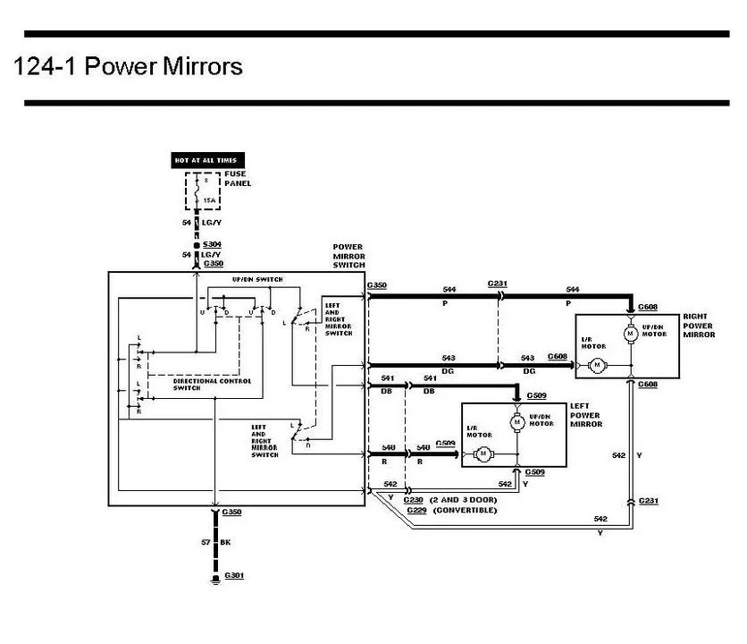

I HAVE A 92 GT CONV AND CANT SEEM TO GET THE POWER MIRRORS TO WORK SINCE RECENTLY PURCHASING THE CAR. i USED A TEST LIGHT TO PROBE EVERYWIRE ON THE CENTER CONSOLE POWER WINDOW SWITCH HARNESS. I CANNOT FIND 12+V ON ANY WIRE IN THE PLUG. I LOOKED IN MY HAYES REPAIR MANUAL FOR A WIRING SCHEMATIC BUT CANNOT FIND ANY INFO OR SCHEMATICS ON THE POWER MIRROR CURCUIT. DOES ANYONE HAVE OR KNOW ANY INFO ON THE POWER MIRRORS???? PLEASE HELP.....

has no one had issues with the power mirrors? i really want to get this last electrical issue fixed. so far since becoming a member last week i have had so much help getting all my problem repaired that i have been fighting with. this site is awesome and i thank every one who has been such great help....

Heh mine only worked right to left on one side and up and down on the other. I just replace both now they work fine.
Just to clarify, you replaced both what? Mirror motors? Both of my mirrors only work up and left, not down and right. I'm leaning towards it being a wiring problem but I haven't had time to diagnose it yet.
