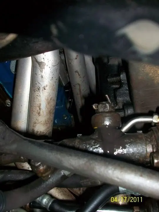

I have a leak where the power steering contol valve and pitman arm meet. There is a zerk fitting for pitman arm joint that goes up thru the control valve - see pic. Its on a 70 v8. I'm guessing there is a seal there that is bad and power steering fluid and grease are mixing and making a mess. I can either get a new control valve or rebuild kit. Anybody have any experience with either. Like to get confimed there there is a seal there and was wondering how difficult rebuild (any special tools). Appreciate any help. thanks
The "seal" is inside the control valve body, not out where the ball stud is.
Yes, a fairly good mechanic can replace the seals, o-rings, and gaskets.
Last thing you want to do is Buy a new control valve, Original Bendix are superior pieces.
Dan @ Chockostang

Thanks - I'm going to tackle the rebuild myself. The rebuild kit is $20 at autozone. If still problems after that I will look at borgeson unit. Plan on putting one in the 66 project I'm doing now.
Whats the best way to remove from pitman arm?

use a pittman arm puller, do NOT use a ball joint separator, u will ruin your valve...heres on on fleabay....your local parts house should have one of these.
Holly goodness are you in for a rude awakening.
You better ask them again what you are getting.
A Quality kit will be around $45-$50.00, which will include the vital pieces, Absolutely necessary to do a quality rebuild.
The issue with removing the control valve is interesting.
The control valve can be removed with one hand, possibly 2 fingers, from the centerlink, once the clamp, and roll pin has been removed.
Yes, Roll pin. These are not noticed, then Folks start Cranking on the control, shear the roll pin, Really screw up All the threads, then can't understand why the Dam Thing is "So Hard To Remove".
Then the next BIG Thing, Reinstall the roll pin, or the steering will be SLOPPY!.
Dan @ Chockostang

Thanks Choco. I can see how people can overlook roll pin. Thaks on heads up. Also I agree on rebuild kit - the autozone parts list looked a little lacking. Ended up buying from http://www.stangerssite.com/CVrebuilding.html (thanks robzz28). They had the most complete kit.
Apprecaite everyone response. I figure if I screw up the rbuild I can also get the full unit from O'Rielleys

Got the old one off - using a lot of the tips I got here. Only issue is that the ford repair manual says that the distance from centerlink and greas fitting is 4 1/2 for mustang and 5 5/8 for montegos and mavericks. Mine was 5 5/8. Who knows somebody may have swapped it out over the last 40 years. I had troubles getting OEM hoses to fit a couple years ago when I changes them. that may explain it. I order a rebuild kit from stangerssite - wondering if I will have any issues. I'll email but does anyone have any insights?

Just rebuilt mine. No Leaks. http://www.stangerssite.com/CVrebuilding.html is class act - highly recommend.
