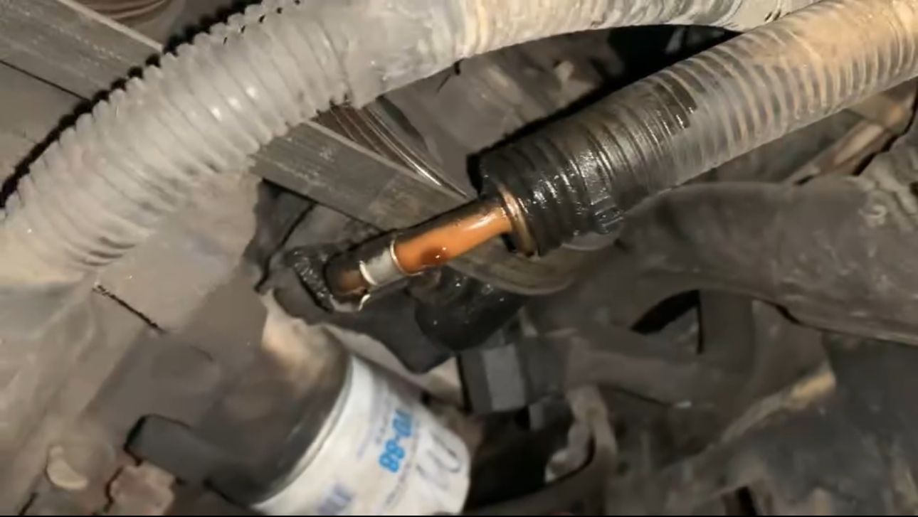

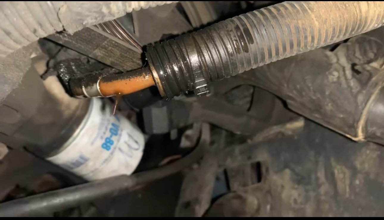

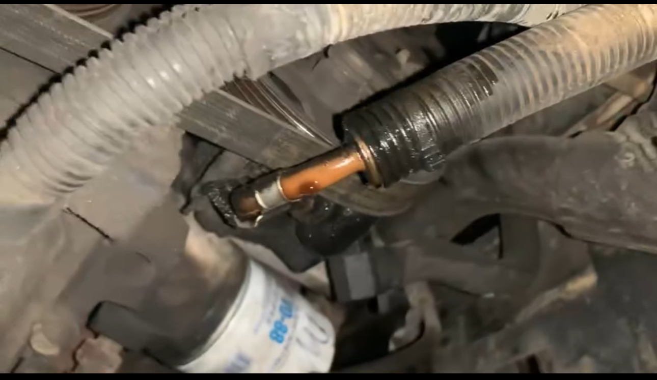

just got the car its a 2000 manual mustang gt only issue ive had is that its leaking all of its power steering fluid. I am new to cars and im hoping anyone can narrow down what my issue and if it isnt to hard to work on myself
Start by tightening up the two ends of your P/S lines first. Mine were leaking, I tightened them up 2 years ago AFTER buying new lines. The new lines are still sitting in my garage 2 years later and not a drop has leaked since.
