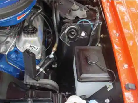

If I'm not mistaken, the power-steering pressure-hose on 71-73 (probably the same on all years with power steering) is/was intended to be attached to the top of the export brace as shown in this picture (note: this is not my engine bay) and the looped portion of hose has additional foam insulation.
I assume this routing has something to do with cooling, but I see many (if not most) engine bays routing this hose, unattached, under the export brace. What are the prose/cons of pressure hose placement?
The long hose was to prevent pump harmonics in the steering gear, to smooth out the boost. Imagine pump vibrations transmitting straight to the steering wheel via the about 9" hose they could have used. Ford gives nothing away, if they could have saved 5¢ per car by using a shorter hose, (not to mention the cost of the bracket) believe me, they would have.

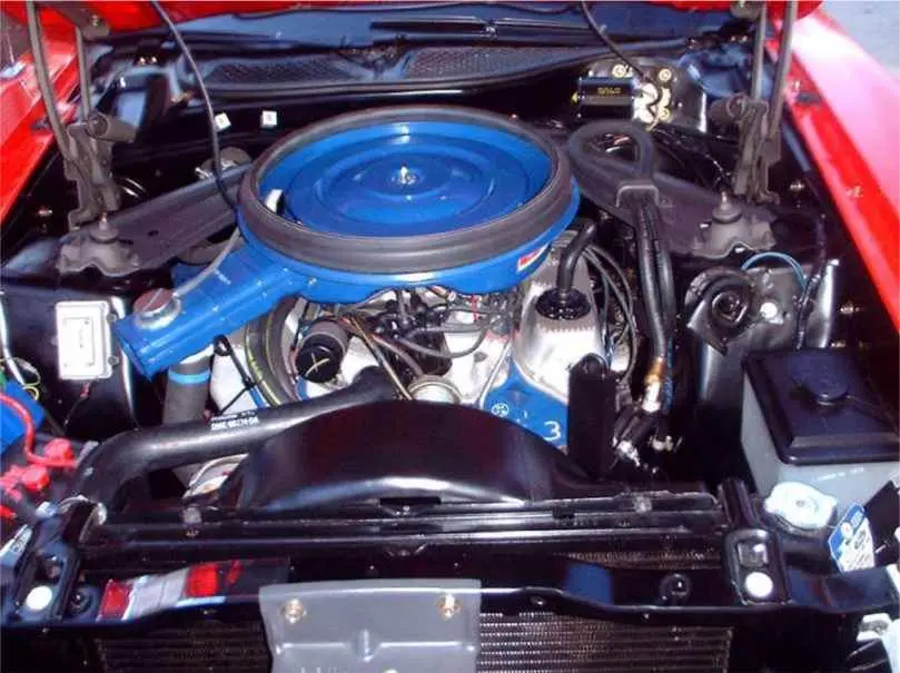

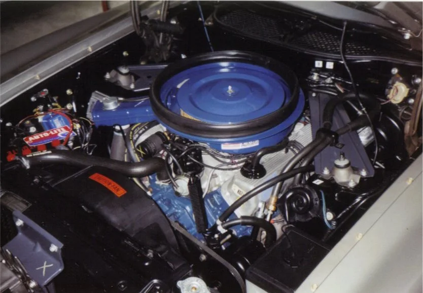

You got it from the wrong place. Call Glazier's, tell them you need the long one. If you need the insulator or bracket for the top of the brace, they can do that too.
Wow, nice clean engine bays (puts me to shame). Thanks for the pics! Certainly leaves no question to the routing or hose length. The pressure hose I got from MU is their #3718 (which is the only one they list for 73). Upon very close inspection of their newest catalog, I see there are 2 different pressure hose lengths available for 72 with 302/351, which makes no sense to me at all. Why wouldn't they all have the same length pressure hose? Same engine - steering pump - steering box.
