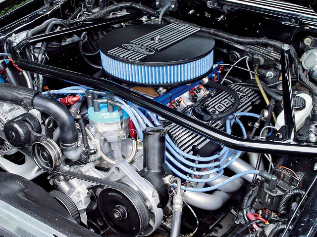

That why you use the relocation style brackets... Majority of the fox stuff isn't designed around the early brackets but the later model stuff, and it raises the power steering higher. Your trying to use the delete idler pulley and change the pump bracket at the same time neither where designed for the 82 brakcets, you need a pump bracket that works with the stock tensioner system by raising the pump location, there's multiple ways to do it and using an idler is the worst of them but there cheap so ppl do it.
He's the ford racing / lmr power steering relocation bracket adapted to an 82 power steering pump bracket. No idler pulleys used, there like $80bucks these days.
https://www.motortrend.com/uploads/f/9910707.jpg
