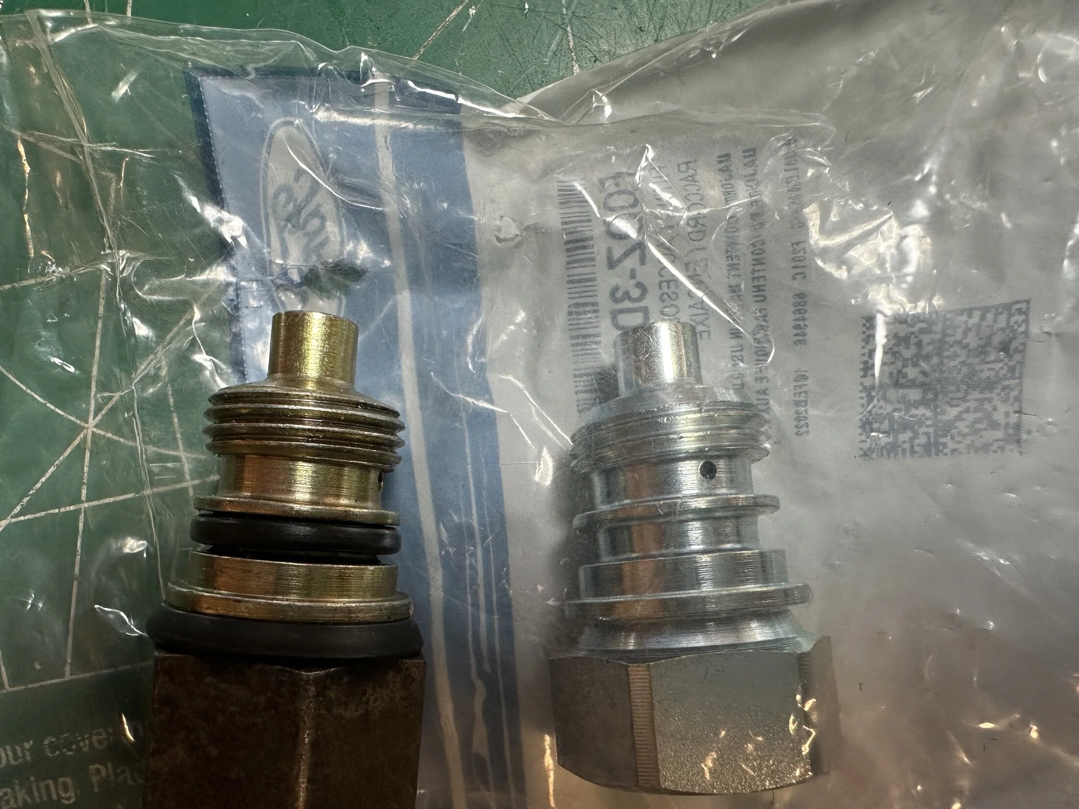

I do believe the fittings on the pump can be changed.
Fitting off my ‘88 pump on left, and 90+ fitting on right. Looks to be the same interface.
Part number on 90+ fitting is F0DZ-3D654-B
