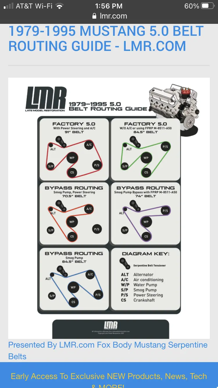

Looking to move my power steering pump up. I have no ac in the car. Ac delete pulley in there in place of the pump. What will I need to move the ps pump up? I have underdrive pulley and smog delete. Belt size and routing? Thanks

If I remember correctly with underdrive pulleys its a 73.5 belt that fits, and this is the correct routing guide.
