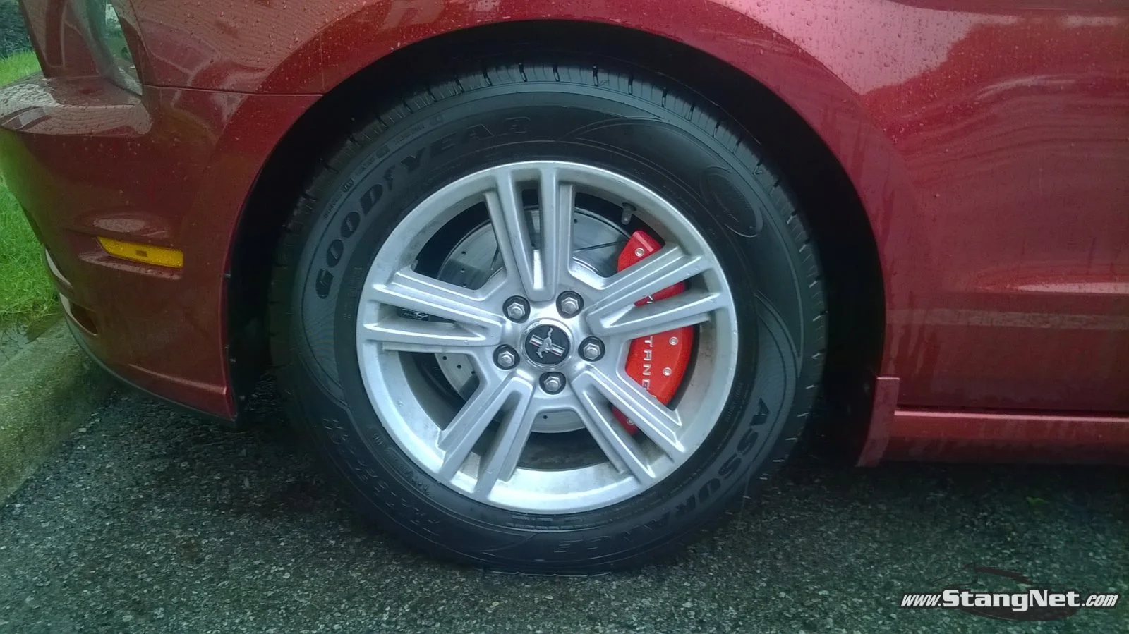

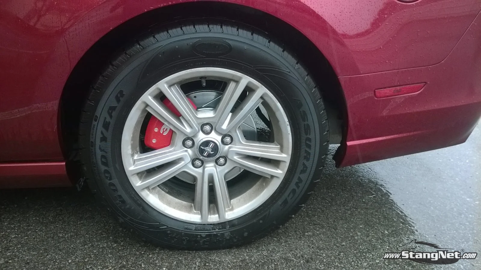

Hey I just installed the Power Stop Z23 rotors/pads set for both axels yesterday, actually Midas did the work, and was wondering what experience the rest of you had with them. I also have MGP 'Mustang/3.7' front/back caliper cover set on there. Everything went as planned thus far except when I went out to the work parking lot for lunch my right/rear rotor has streaks from the pad as well as some clear spotting action all throughout, the right/front has some streaks, the left/rear has minimal streaking, and the front/left has none at all. I've just had these since Saturday and have driven the car 3 times. After the 2nd drive/break-in process the rotors still looked cleaned. Now each one looks different from the next. Anyone have these? And if you still have them did you experience this? Did it go away? Thanks.
P.S. The brakes stop really well.. better than I recall my Mustang braking before. There was just one noise during my 1st stop today, but that's what happens in the rain.
These are my photos the day of after my 2nd drive/break-in = left side front & rear
Well.. I looked at them this morning and everything was fine! So I guess it does go away. Never mind! Was just worried is all. Thanks for your support. LOL Yeah.. love the brakes yo.
