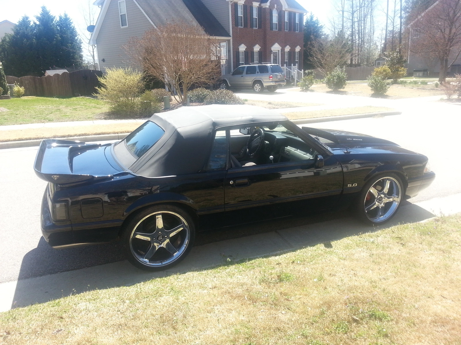

here's a pic since I can't remember if I've even posted one on the site yet. the 20inch rims are only temporary. They ride real stiff so I am getting draglites for daily driving it. But I will keep the 20s for car shows since they get so much attention and compliments for some reason
