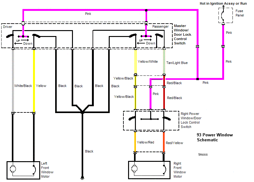

I'm in the process of repairing or replacing my door panels. When I re-installed the door panels, my passenger window is now dead. Wiring seems ok, and I tried swapping switches around and they all seem fine. Passenger window does nothing....from either switch.
