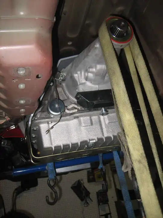

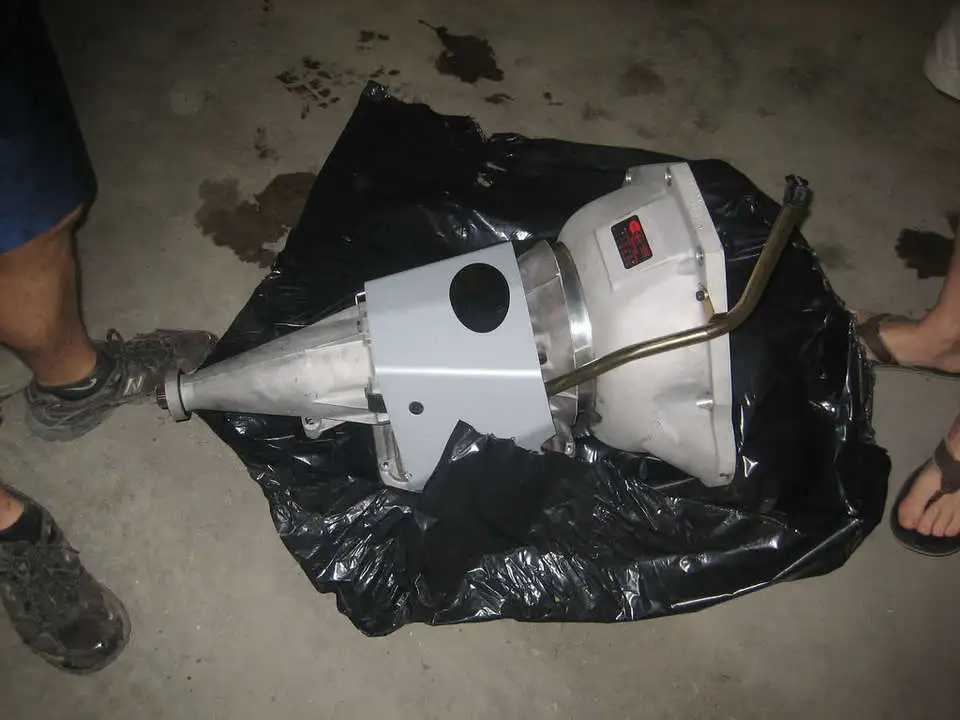

We have just installed a powerglide transmission (2 speed). Custom brackets and driveshaft are being fabbed to get it working on an S197. Pics show glide, scattershield and C4 bell housing.

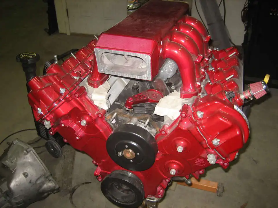

also pic of rebuilt motor
Don't pay too much attention to dyno numbers. We're looking for the lowest amount of power to get the car into the mid to low 9s. Car was running poorly when it hit 10.0 last november. That was at 22 lbs of boost. Think we're going to stay around 22-25 lbs of boost. Weight reduction is 250+ lbs with the rebuild and with some extra ponnies, should lower ETs a lot.
