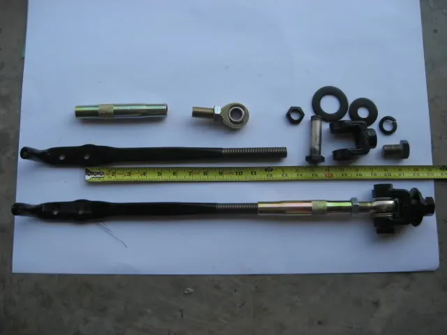

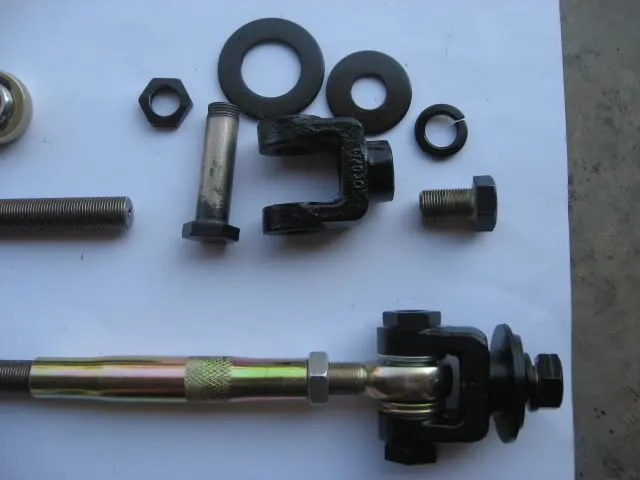

I followed Daze's instructions but didn't want to machine my strutrods any thinner than necessary to thread them so I went with larger heims, tube and bought the next larger clevis from the same co. he mentions. I had to grind off the top part of the bolt head but it fit between the front mount with a little grinding. Here's some pics to give you an idea of what I did.
I installed them but haven't driven the car as I'm still installing the drivetrain.
The larger clevis fit into the front mount hole perfectly with just a little polishing this avoided having to make the pipe piece and odd sized washer to make the smaller clevis fit. Don't know if this'll be any better/worse than the Daze version but it was less work/adapting for me this way and less material was removed from the original strut rod thickness. I did shorten the length of the bolt threads but once installed there is no room for the nut to back off.
I may get flamed but this is what I did and will monitor it closely once the car is on the road.

JonK- thank you for the pics. Most likely I'll be following your setup because your steering rod is exactly the same size as mine. It looks like you used a 5 inch steel tube? Do you have pics of the strut rods on the car? I might do what Tim65GT did with the clevis. Get some steel and weld it together.
Thank you both for the good idea. I'm pretty sure both setups are fine.

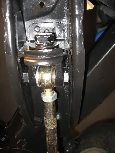

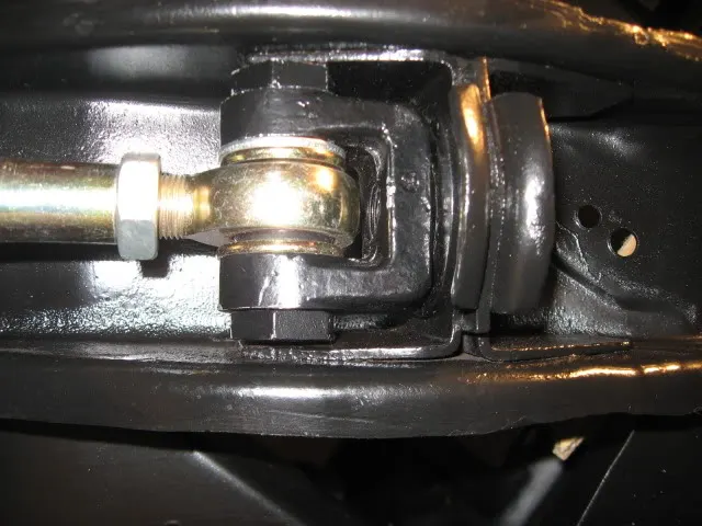

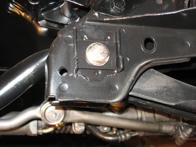

Here's some pics on the car, the adj. tubes are 6" long:
Eccentrics installed:
