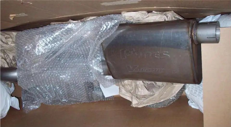

pretty shiney things that the brown bus left for me.
aar0s
Dec 20, 1998
1,015
55
69
pretty shiny things that the brown bus left for me.
:nice:
shipped wed. morning and on my porch today before i got home from work, LMR FTW!:nice::nice:
now as soon as i shake this cold I'm putting the car in the air and installing, i may go ahead and start, f' the flu.
you mean the tube that goes from the h pipe to the muffler? no its not, its in the box. that reminds me, should i get a bunch of stop nuts (the kind with plastic in the nut to keep it from backing off) to use in the clamps or will the supplied non stop nuts hold with out me having to get under there and tighten them once a month? we sell the stop nuts at work so i can get them pretty easy.
Might be a few days before i can get the sound clip, i think this flu is going to keep me in doors for a few days. well, the garage is technically in doors...

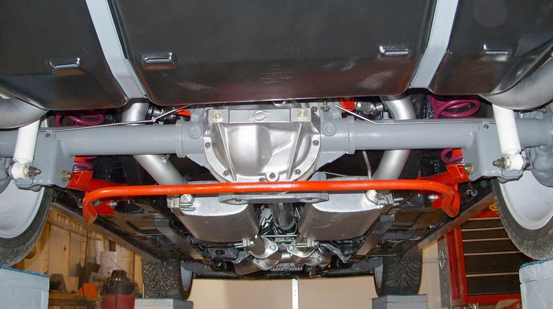

OK, got it all on today. and nic this is the second cat back i have put on in 13 years but non of the bolts on my old set up were to hard to get off.
ok, first off after i got my head out of my ass and got the weight off the rear end and was able to get the pipe over the axle i had the problem of the flow tube on the drivers side being to long. I tried to beat the muffler on the tailpipe thinking that maybe i could get some more room but it was no dice, broke out the circular saw with a metal cutting blade and took about an inch off of it and got it all together. i used some SS stop nuts on the clamps.
passenger side the tail pipe didn't want to stay in the front hanger grommet and the flow tube was about an inch and a half too long. got it all together and noticed that the top of the pass. side tailpipe is against the rubber return fuel line. I tried to move the pipe around and even tried to beat the muffler on it and pull it forward some but it didnt work. I know this isn't good, maybe i can zip tie it off to something and get it off that pipe. Passenger side sticks out from the rear valance maybe a 1/4 inch, not much and I'm not going to worry about it tonight.
Is it possible that i got the tails switched and put the passenger on the drivers side?
oh and they sound SUPER AWESOME, ill try to post up some clips tonight.
Nah, I doubt you got the tailpipes reversed, as it's pretty much impossible to get the right on the left side and vice-versa; the FLOW tubes, however, there's a chance you might've gotten those mixed up, since one is longer than the other. Look at the H-pipe or X-pipe you're mounting them onto and you'll see one of the flanges is farther forward than the other one - the shorter one, of course, gets the longer flow tube. But even then, I'm not sure you could really get the two mixed up as I don't think the muffler would even fit up in there if you used the short flow tube on the shorter flange side because it'd be too far forward to tuck up under the chassis. :shrug:

I think that the hangers are on the wrong side and thats pushing the tails over and out of place, ill take the blame for that but.
A buddy of mine had the same problem with the return line with his flowmasters. Im going to change and put on some warmer clothes and make a clip or two.

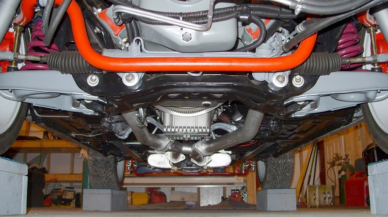

At least with a GT bumper you don't really see the tailpipes, so you don't have to worry as much about them being uneven. With LX tails, I get completely anal about the alignment of those things, and ever since I had to cut up my flow tubes and tails to make those extra-long early-production Pypes Violators fit on there, things have never quite looked right. :(
Yeah, I like the way the Pypes guy blames fitment issues on improper installation, but he would change his tune if I threw the kit I got on the floor and said, "Now YOU install it correctly and watch the circus as he runs into the same problems I ran into. I wish they would just admit there is a problem and correct it. When I dicovered how far from right mine was I talked face to face with a guy at a Pypes vendor at the all Ford Carlisle and he told me I must have gotten a knock off exhaust that had their name on it, because a TRUE Pypes kit fits perfectly. When I told him it came with all the proper literature, stickers and such, he then said it was because their catback won't work with other manufacturers X pipes.... then I told him I bought a COMPLETE kit from the headers back from them and it still didn't fit. I actually ended up using a Mac H pipe I had sitting around because it helped the crappy fit of the rest of the Pypes stuff. I hate to knock them so badly, but they really need to address the problem and stop making up excuses if they don't want to be cut up on the forums. And if the Pypes guy comes in here and questions my ability and opinion, below is a pic of how my set up turned out after all the extensive modification I made to make it fit.
Damn, dude, that is one clean undercarriage. :drool:
