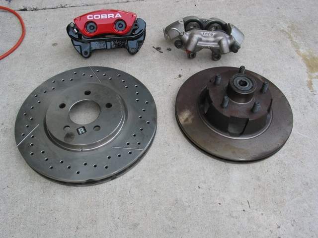

So do you think that two larger pistons in a floating design are better than 4 smaller pistons in the classic design assuming toal bore size is equal? If so is it the floating design that makes them so or does it have to do with too many moving parts in the 4-piston design?
I ask because I just put the Cobra (PBR) calipers on my project (http://www.edbert.net/brakes.htm), and although they are lighter than the factory units they just don't "seem" to be as well engineered, I mean the outboard pad does not press inwards at all. I daily-drove a 97 Cobra for almost 9 years and loved the brakes, I'm not regretting the swap or even second guessing it, the 13" rotors will be much better than my factory 10" could ever be no matter what caliper I used. But the single pad-clamp thing has me scratching my head.

Edbert,
The pistons in the four pistons original are known to freeze up. The floating caliper from the Granada is similar to the PBR caliper in that piston(s) are on the inboard side and the outboard pad is fixed to the caliper housing. These are more reliable because, as you state, there are fewer parts.
Having the pistons on only one side is equivalent to having them on both sides. The caliper housing is free to move. So when the piston presses against one side of the rotor, the housing along with the outboard pad attached to it, moves inboard and causes the outboard pad to contact the rotor. Under these conditions, the two systems are equivalent.
True the 13" rotors are generally better than 10" rotors. I am reluctant to suggest putting them on the small original 65-69 spindles.
