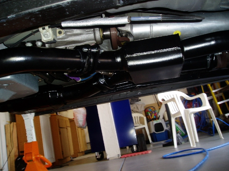

Keep at it, you'll get it and the Mac Pro-Chamber is a great mod.
