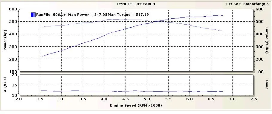

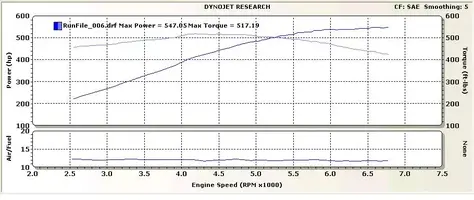

The performance shop sent me a file with a .drf file extension and i can't find anything on the net to open and view my Dyno run. Does anyone have a software package that can read this file?
Thanks
I took a screen shot of the Dyno graph. If you need the file I can still send it to you if you like..

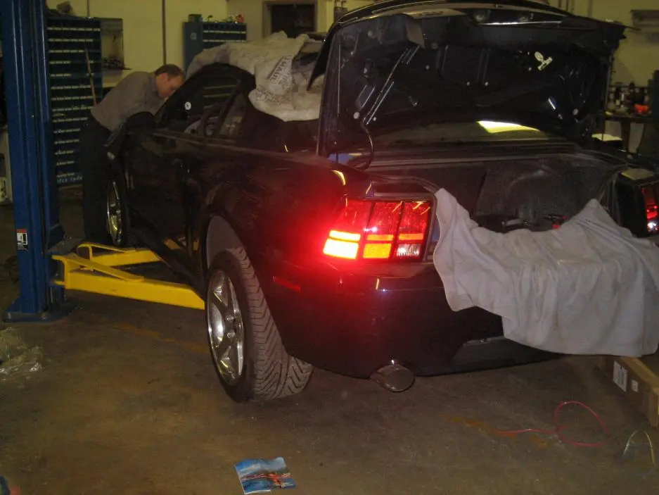

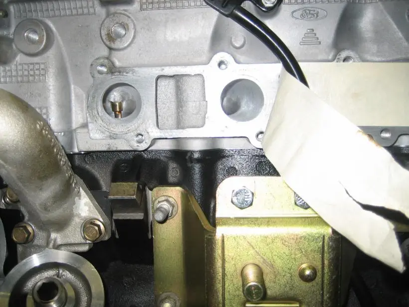

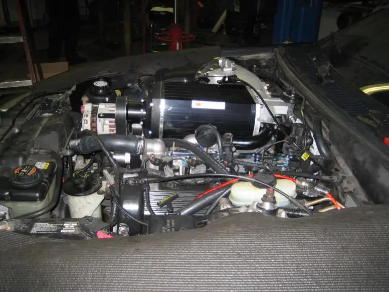

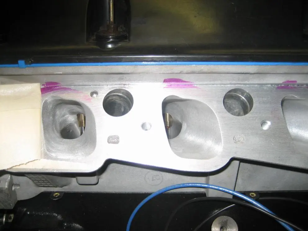

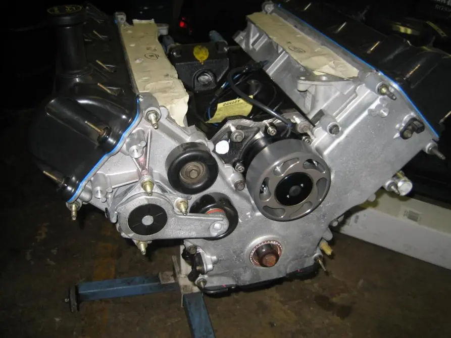

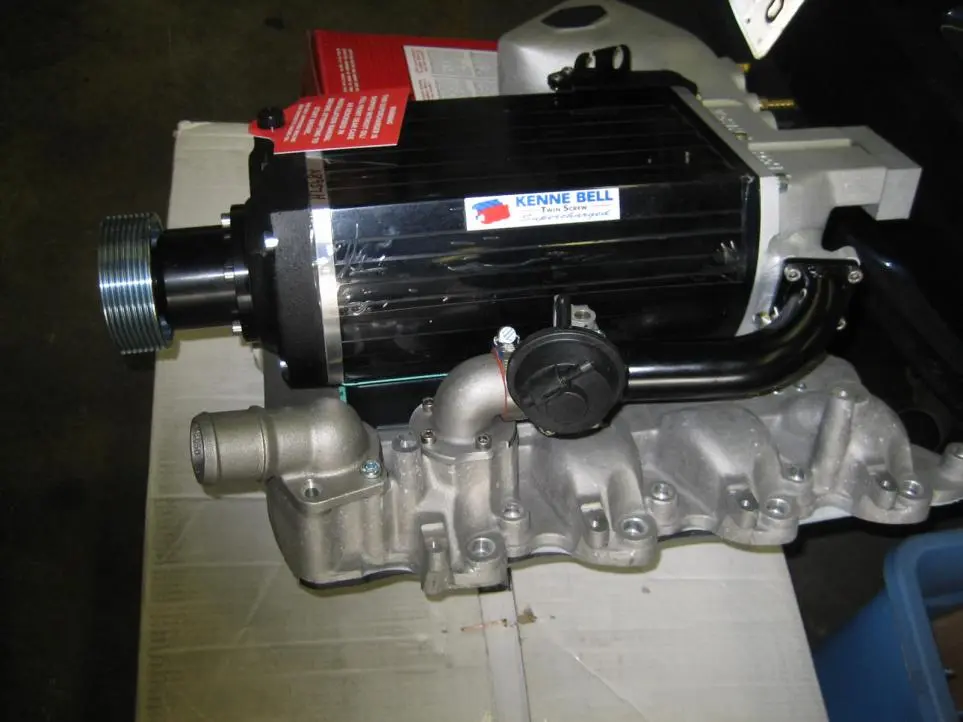

Thanks for the compliment guys...
The good stuff listed below:
Cobra Tank
Dual Focus Pumps
Lethal Perfomance / Fore Precision Cobra Billet Top Hat
Mezier Electric Water Pump
Innovators West balancer 4.6
Remeo block, Cobra crank, Eagle Rods, Diamond pistons, w/ ARP stuff
Houston Performance Full port job
VT Stage II Cams
3 bolt front cover w/steel tensioner
KB 2.6H w/8 Rib upgrade, 3.5 Blower Pulley, Big air kit.
60lbs Injectors
Spec Stage 2+ Clutch
Billet Steel flywheel
Dual FPDM wire harness
Full Bassani Exhaust w/ cats
Still waiting on the hood to be delivered so that I can bring her home... :D
