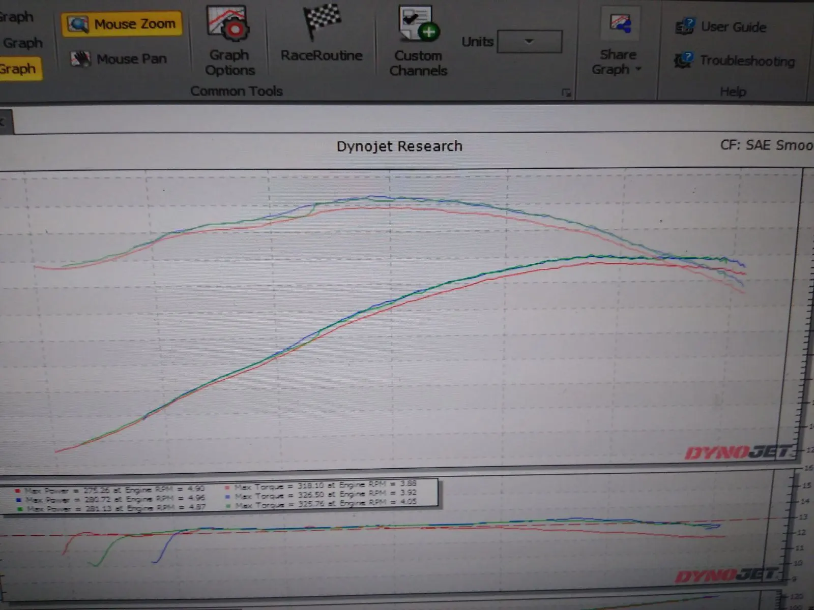

I disagree on the WOT cells. this response actually surprised me. AFR is around 13:1 up to around 5500, dyno sheet shows this as well. WOT is spot on. Bumping this to 11.5-12:1 will reduce performance.
There is an area around 22-2500 that the AFR is a touch rich (14-14.2:1), it's an area where the exhaust drone occurs.
The lean on tip-in is very short lived. If I reduce the TPS dot on this the accel enrichment is too aggressive and triggers early.
Here's the dyno sheet from that tune and datalog. The blue/green lines are from 9/7/23, the 281/326 results.
Reactions: X-cam34

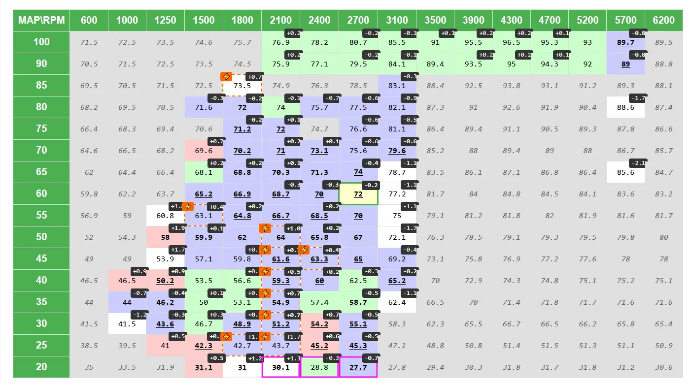

Alright here's your corrected table. Before I ran this I spent about 12 hours last couple days hunting down and killing bugs in the correction logic. Every fix was verified against actual data before I moved on.
This correction uses only the most trusted data from your log — EGO-primary at 85%. What that means: your ECU was already telling us exactly where your VE table was off by adding or pulling fuel in real time. Instead of relying on the wideband AFR reading (which can be noisy and lag behind), this uses the ECU's own correction signal as the primary error source. Where the ECU had clean closed-loop data, we applied 85% of what it was telling us.
Look at the AFR Error column in the report — most of those cells are within ±0.3 AFR. By AFR alone your tune looks fine. But the EGO column tells the real story. The ECU was pulling 2-4% fuel across a big chunk of your table to MAKE that AFR look fine. If you turned off closed loop, those cells would be running rich.
The corrected table bakes in what the ECU was already doing so it doesn't have to work as hard. Your EGO correction should settle closer to 100% across the board after flashing this.
41 cells corrected rich, 1 lean. Your table was consistently over-fueling in the 1500-2700 RPM cruising range. That tracks with normal driving — those are the cells you spend the most time in and the ECU had the most data to work with.
Flash the corrected table, drive it for a session, and send me another log. We'll see how much the EGO correction tightens up on the next pass.
