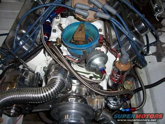

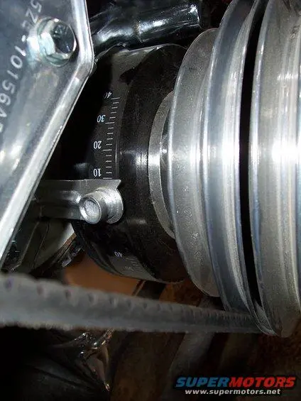

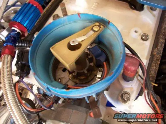

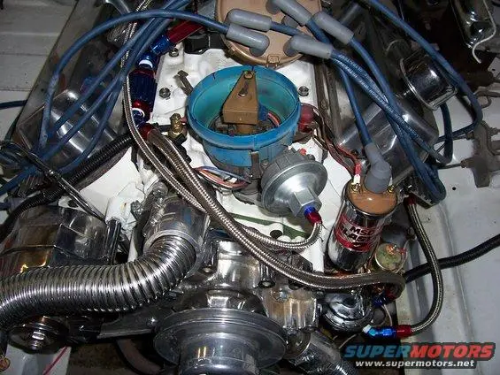

So I checked a couple things out. I removed the valve covers and rotated the engine by hand and verified the standard 15426378 firing order and set the timing at 10 degrees on the balancer with the magnetic pickup lined up firing on #1. I also checked my MSD box and coil using the instructions I found on the MSD website. With the ignition OFF I pulled the coil wire from the distributor and placed it about 1/2 inch from the block (ground), then turned the ignition ON but no cranking I used a jumper wire between the green and violet wires at the connector on the MSD box which causes the coil to fire and spark jump the 1/2-in gap at the coil wire. I did get spark so it appears my coil and MSD box are working properly. My new fuel pump is supposed to come in later today, probably hold off on trying to start it again until tomorrow.
Timing set at 10 degrees
Distributor set to fire on #1

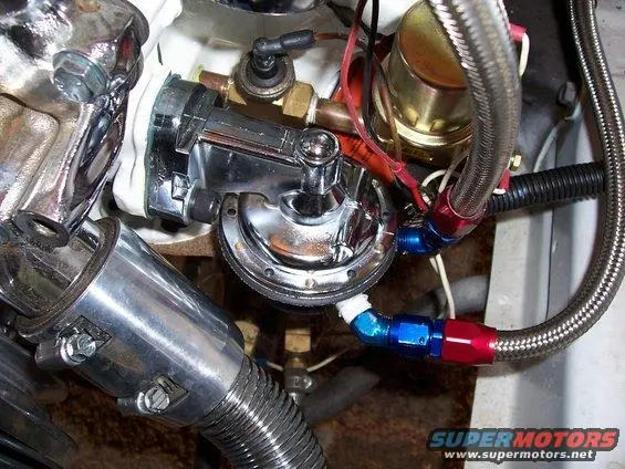

New Pump installed

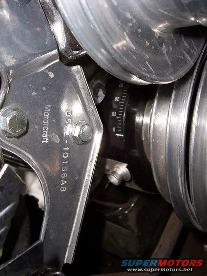

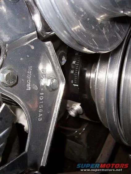

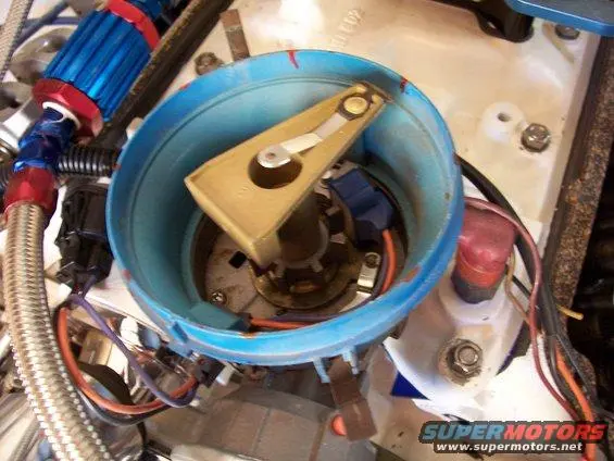

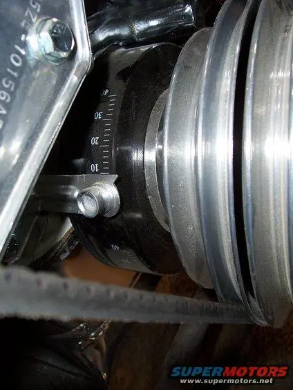

Finally some good news, I got it started today but could only let it run for about 5-6 minutes at 2000-2500 rpm because it started overheating. I had the cap off the radiator to verify flow and before we got it on I lost about 1/2 of the coolant and the temp went to about 210-220 and I shut it down. It also appears I can't go by the timing marks on the Professional Products balancer either as I had it set at 10 degrees as shown in the picture but to get it started we started rotating the distributor until it fired and we checked it after I shut it down and the pointer is about 3/4 inch to the left of the zero mark on the balancer and the distributor pointing way right of center. So I think when all is done I'll mark and pull the ditributor and rotate it to the next tooth on the cam to bring vacuum can on the distributor back towards the engine centerline.
After letting it cool down I fired it back up it ran for about 1 minute before the alternator belt snapped and I had to shut it down again. By then it was 6:30 pm and I figured if I went and got a new belt the neighbors would linch me because the open headers at 2000+ rpm is loud as you know what. So I'll get a new belt in the morning and try again late morning while most are at work.
So have I done any damage only letting it run a few minutes at a time? I did see 50 psi oil pressure and have 2 gallons of Rotella and 2 bottles of Crane breakin lube in the pan.
Let me know your thoughts.
Thanks -Jeff
Here are pics of what I'm describing above.

Shutting it down and starting up the motor again later and immediately going to 2000-2500 rpm will not hurt the cam during break in. Letting the motor sit at idle during that time will be much more harmful.
Fill the radiator. Keep a garden hose handy and dose the radiator if the car starts to get hot. Might mar that pretty paint but it will help to keep the motor cool during the cam break-in.
