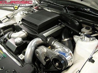

This appears to be a wicked combination, and everything seems to fit nicely. I don't know if there have been any adjustments, but at least we know it's possible. I see a Steeda Bar and I'm pretty sure that's a procharger, though please correct me if it isn't.
Wow, that's pretty impressive! Is it available with the provision for the procharger already? I might consider using that instead of the Steeda Cowl hood. Anyone have more info?

That's my car see at classic designconcepts.com
Yes, Classic Design Concepts has a shaker system for the 2005 Mustang. Wheel to Wheel Power Train handled the install of a Procharger, Stainless Works long tube headers, off road X-pipe with 3" exaust and 4" tips. We also put most of the steeda catalog on it including Front and rear strut tower braces,Panhard bar and brace, lower control arms,4:10 rear end with axle cover and race motor mounts. The guys and girls (Kim) at Classic Design Concepts have some great stuff including Duck tail spoiler and an agressive front end splitter that trows air at prochargers intecooler.
