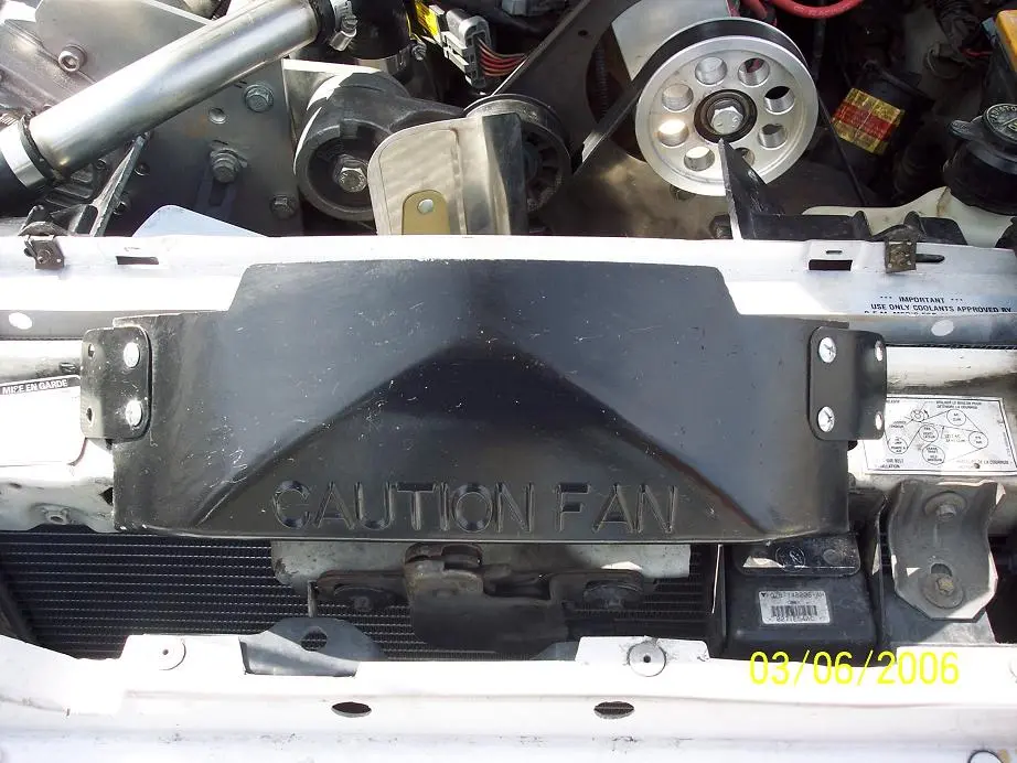

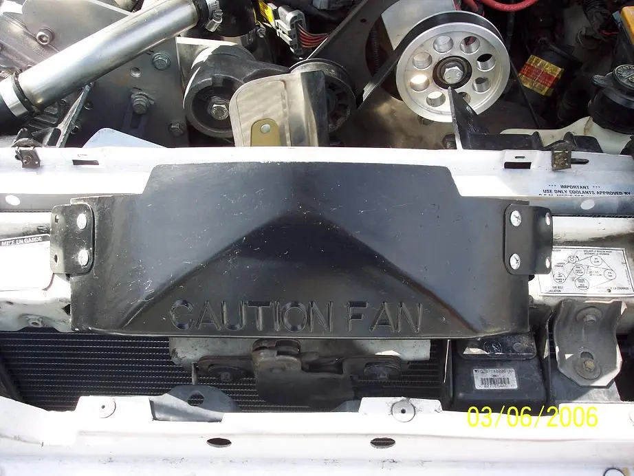

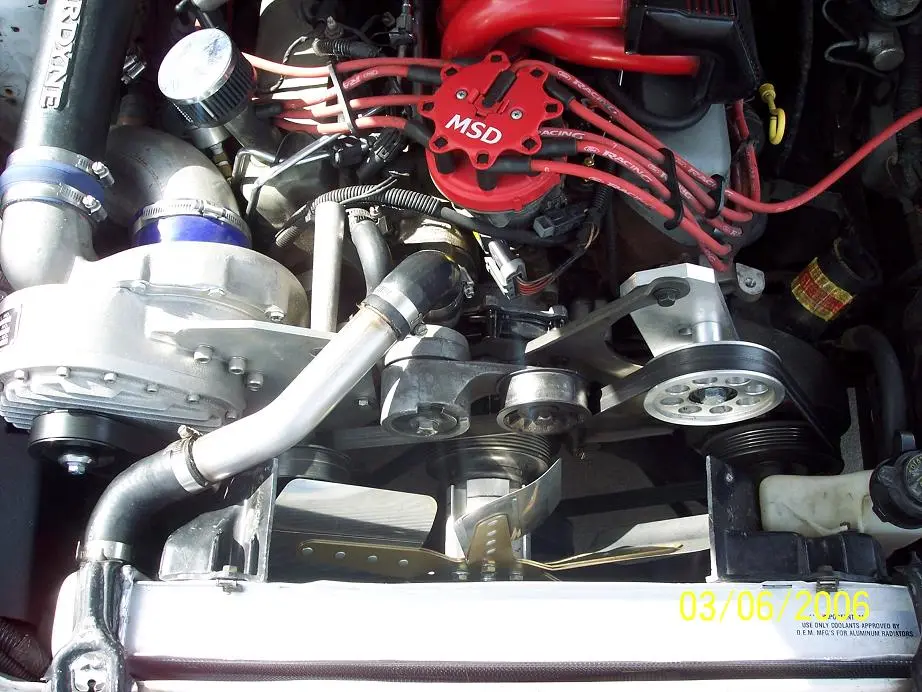

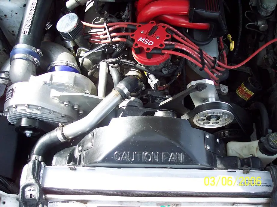

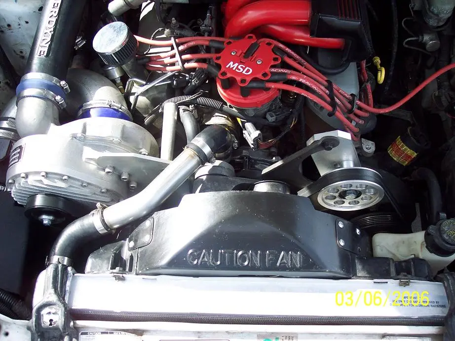

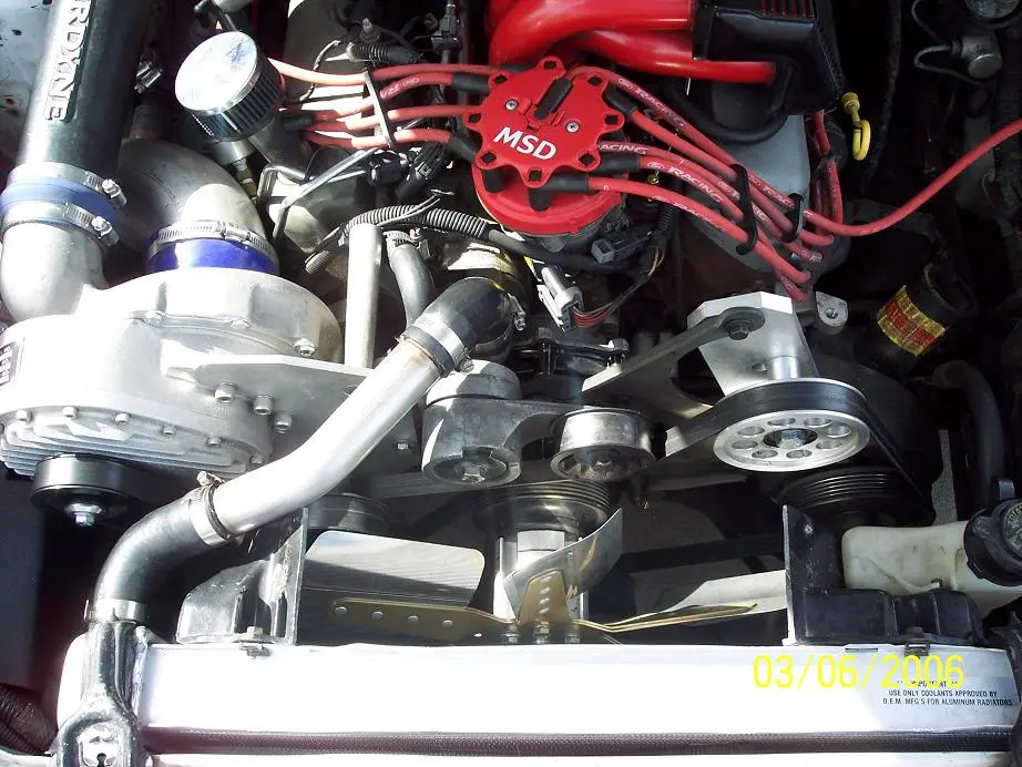

If you are still using the stock fan shroud like I am you could do what I did. I cut the top part of the fan shroud away. the part that say caution on it. then I added sheet metal tabs to the part that was cut out and used 2 peice cap screws to bolt it on and off. After I put my new radiator in I had some small clearance problems and notched the shroud in the areas where the belt ran. If you want I can take some pics in the next day or two and post them.

here is a pic of my fan shroud mod. If you look close you can see were the mounting tabs are. Believe me it makes gettin to my belts so much easier. If you need better pics or more info let me know. All I could post was link for now.
I will try again later, sorry
here are those pics, hope these give you some ideas.
