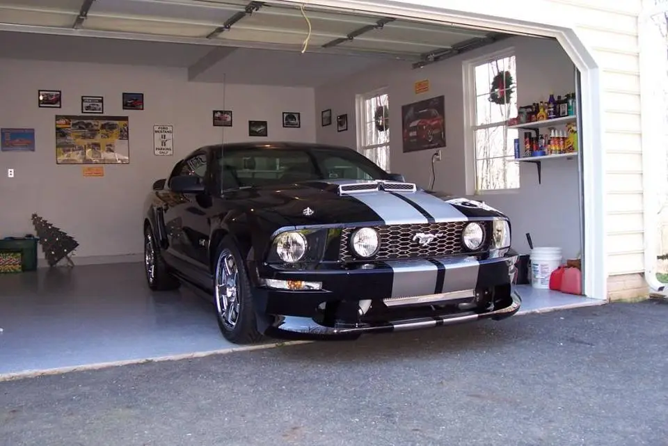

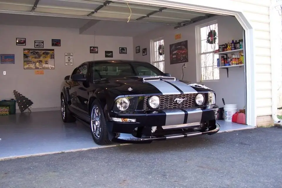

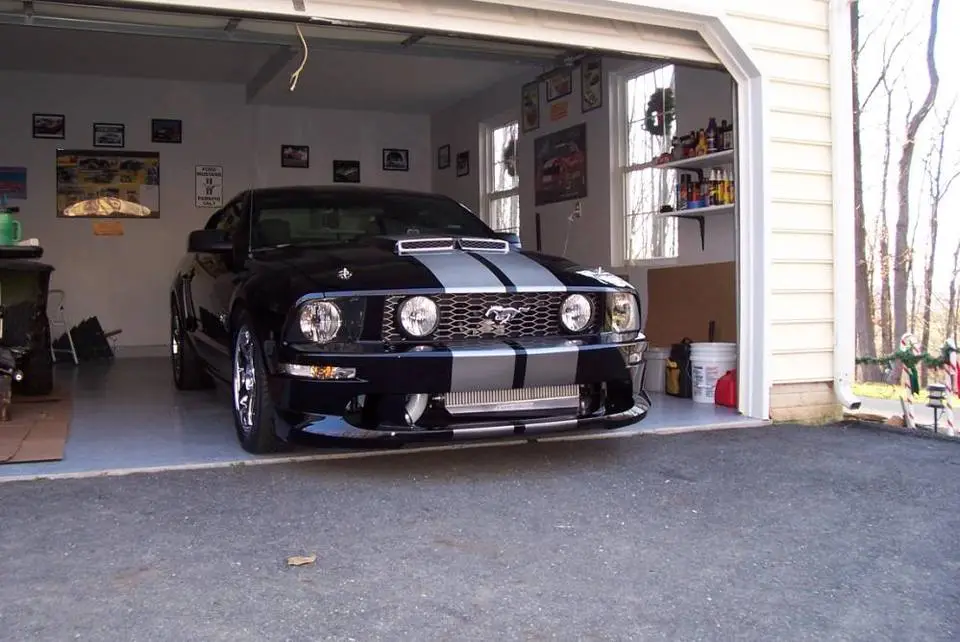

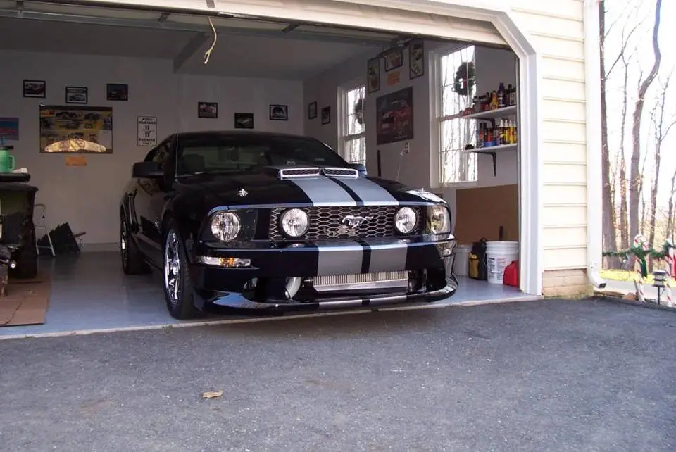

A couple of guys on here like bigcat suggested that I lower the Procharger intercooler. I decided to do it today.
I pulled the front fascia, fabbed up a new top intercooler bracket out of 1/8'' aluminum only 2'' longer than the steel one. Did the same thing for the driver's side bracket and I was able to bend and reuse the passenger side bracket. Very easy job. If you have a Procharger, not only does it look menacing, but it will grab much more air.
BEFORE AND AFTER

Much nicer looking! Have you taken it out for a SOTP test yet?
(I mean between the original intercooler mounting and the "adjusted" postion)

100 times better! nice job, how long did it take from start to finish, including R&I of the bumper?

Fantastic work!

I can't really say if I notice a power increase, but cooler air is a huge plus. It has to help for sure.
It took a couple of hours taking my time making sure everything was fitting properly. The fascia is easy to get off and on if you know the drill.
