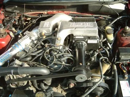

Is the procharger harder to install in our cars than the vortech? What all do you have to move to put the procharger in our cars and what does it look like installed? Also what does the kenne bell look like on our cars I've never seen one and have given it some thought

here's a KB
