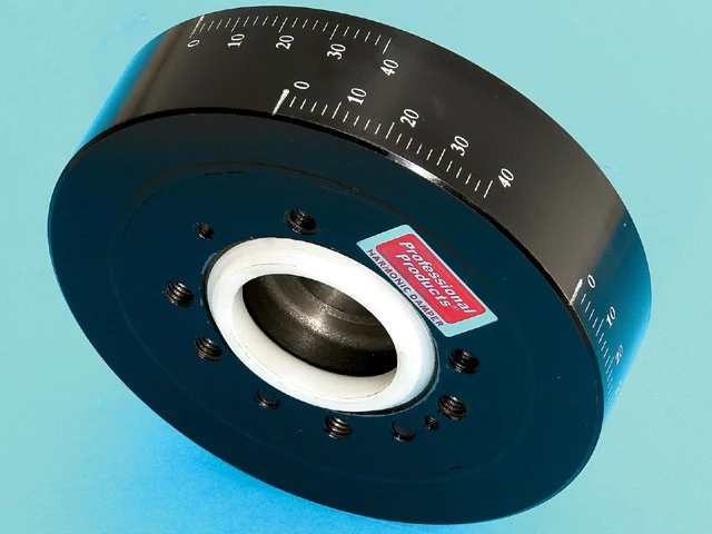

When buying the PP harmonic balancer, I know I will need the .950" spacer. Do I need a new bolt when using stock size crank pulley or can I reuse the stock bolt? If I do need it, is it some standard bolt where I can get it at a local parts store?

I just did this yesterday The big bolt that hold the balancer to the crank will work but the bolts that hold the pulley to the balancer are too short. I went to lowes and picked up 4 grade 8 allen bolts i think they were 3/8x16 and they were 1 and a half inches long they fit perfectly the 2 inch bolts i tried were too long and bottomed out

The timing marks on mine lined up perfectly with my stock one. I lined up the keyways and it was right on the money. And it fit real good anything has to be better than a stock one

ARP balancer bolts are cheap. I bought a cheap Summit balancer and after a year of use (3000miles) the ring became unbonded from the hub and started spinning. Took me about 3 months to figure out what the hell was wrong with my car... So don't buy a cheap damper!

Oh, one more question, how do you lock the engine from turning while removing the bolt?

put the car in 5th gear should do it.

I also put it in 5th to lock the motor from turning, the car might try and run you over a little but the torque will get there soon if you're using a big breaker bar or torque wrench. I believe the torque is 70-90 ft lbs too.

Using a torque wrench to break bolts loose will make it inaccurate. I would put a breaker bar against the frame and bump the starter.
