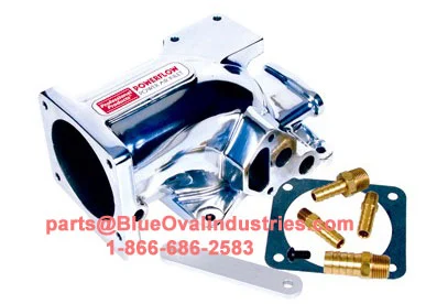

I just finished installing The professional products Plenum and 75mm TB.215.00 shipped for both. The polished would have been 245.00 shipped
I'm very happy with the product for the money. My only complaint is the finish on the inside of the plenum could have been smoother but not terrible.
The throttle response is good and idles fine. I definitely feel some extra hp. :nice:

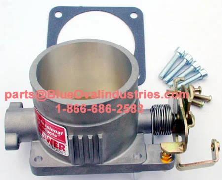

looks can be deceiving, but it looks like the basic stock upper with some added bling. It may flow better. Do they provide flow sheets for the combo? take away the tags and the TB especially looks a lot like the factory stuff.
There are no instructions or flow sheets that come with the plenum. The install is basic so you won't really need instructions anyway. The fit of the plenum is great but the rough finish on the inside could use some work. I paired mine up with a 75mm Accufab TB because of personal preference.

A pretty polish job doesn't mean more power. I'm wondering if there are any flow charts or dyno sheets for these pieces. The price seems great if they produce power.
It says on their site it flows 100cfm over the stock intake system, and it will work with a throttle body size of up to 75mm, which they sell as well. I wonder what the cfm airflow of the other upper intake plenums are ?
I had it out again today and I know that response is alot better than before. The more I use it the better I like it. The TB's finish is nicer than the plenum's. But if you seen the how much bigger the inside of the the plenum was not just the TB opening you would know its not anything like a stock piece. Also there is a difference in the radius if the inside elbow that should promote a lot better flow of air. Even with it being a little rough on the inside it was not as bad as the stocker.
