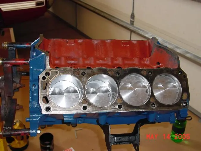

Hey guys I have begun the great fun of assembling the engine for the last time and will be dropping it in tomorrow if I can get this one problem sorted out. I have painted the block ford dark blue the correct color, its just the flash on the stupid camera that makes it look so light. I also painted my engine bay and installed my hydraulic clutch system and will hook it up to the slave when we drop it all in. K I put the harmonic balancer on and guess what the damn thing has to touch the water pump. Now I want to know what the minimum clearance should be between the balancer and any other part I was going to go 1/8-1/4" whichever works so i can grind it off of the bottom of the water pump. It is just a stupid corner jutting out that is in the way. Also my old flexplate had a a little ring with holes in it for the bolts to go through Im guessing it is reinforcment since the flexplate is so thin. Will I need that on my flywheel for the T5 or not. And how do I bolt the flywheel on, do I need the counterweight lined up in any specific way or do i just put it on despite the location of the counterweight? Thanks and enjoy the pics.

And Now The Engine!!!!!

Now the flywheel will only bolt to the crank pattern, that matches up the weights. Make sure the ring if you use it does not block the pilot hole.
For grinding the water pump casting, just make sure that it has room to move plus a little.
