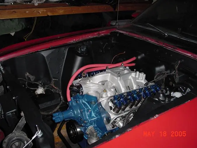

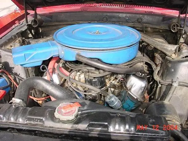

Well guys after 4 times of taking her out and putting her back in we finally got it done. SHE IS BEAUTIFUL!!!! Compare the before and after pics and you guys decide.
