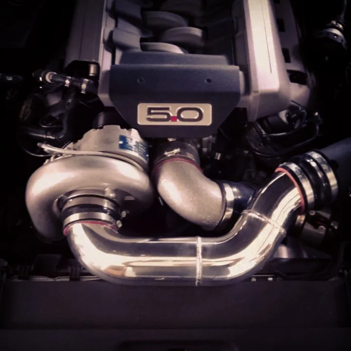

I finally got around to fabbing the new polished aluminum blower inlet this weekend.. I'm pretty happy with how it turned out, just need to decide if it will stay polished or if it will be powder coated?

Damn that is nice! I bet there will be others with their thoughts, but if it were mine, (oh God if only it were mine, lol) I think I would powder coat it to match my valve covers. Or whatever they're called these days.

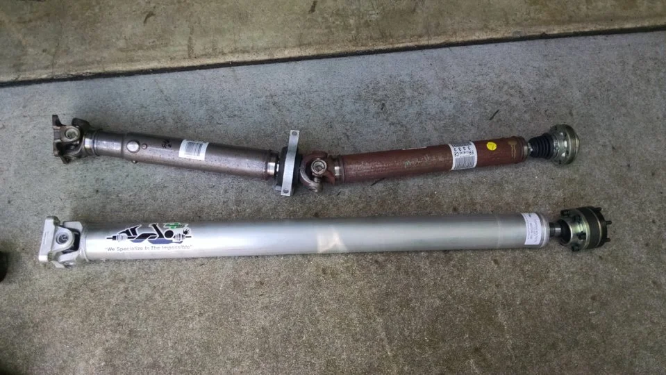

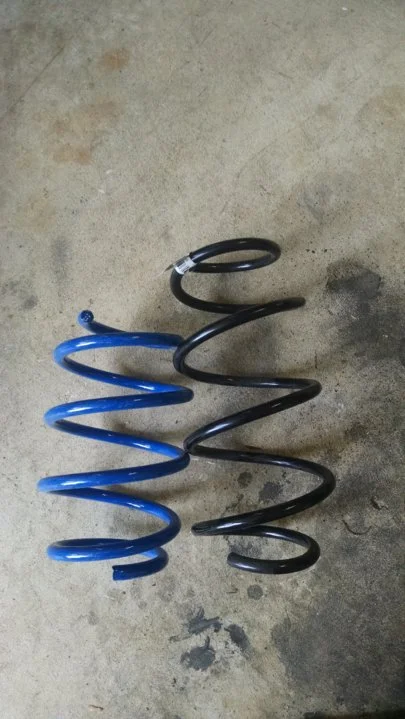

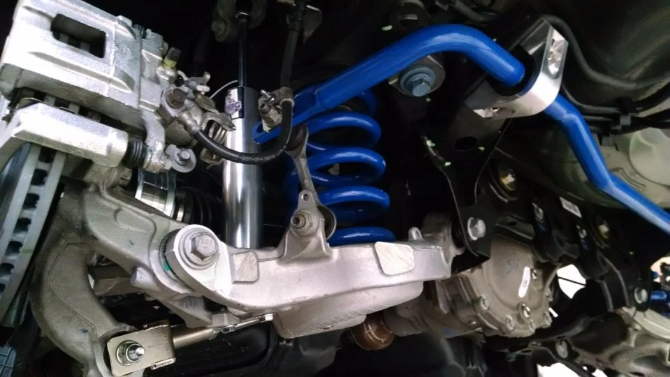

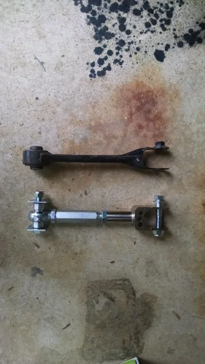

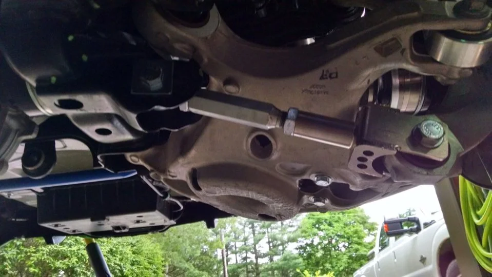

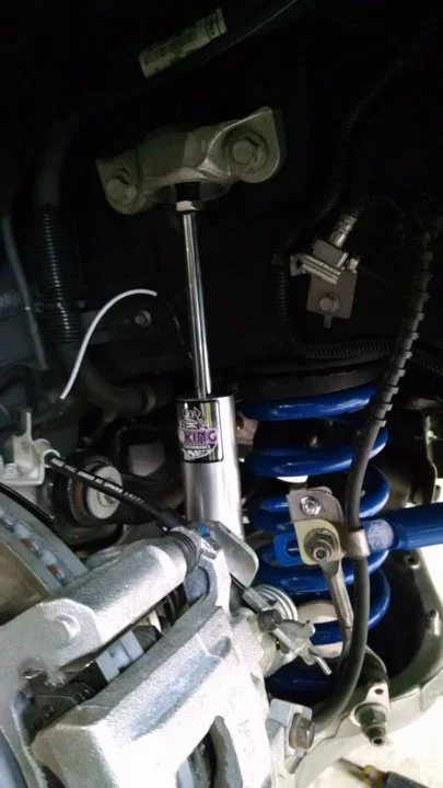

Well it is finally time to make some changes to the suspension of the car. I've rocked the stock suspension for 1,700 miles now and enough is enough...
What's being upgraded?
Steeda Sport Springs
New Sway Bars front and rear
Billet Sway Bar mounts
UPR Adjustable toe links
UPR Drive shaft loop
Viking Rear Double Adjustable Shocks
Steeda Vertical Links
Polyurethane Differential Bushings
Rear subframe locators and aluminum bushing supports
Rear subframe connectors
DSS 1400 HP axles
DSS Aluminum 1 piece drive shaft

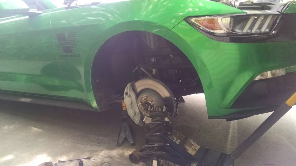

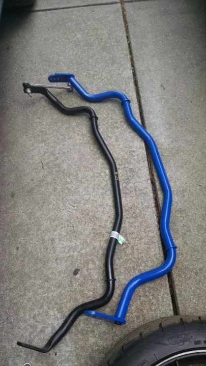

The front, this was easy.. Straight forward easy install with a minimal amount of tools and know how. The spring compressor is a little fun to work with but otherwise no problems. The sway bar required a bit of patience to fish out of the car and to fish the new one back in place but so far so good.
Obviously the factory parts are black and the new Steeda parts are blue
84Ttop
5 Year Member
Jul 2, 2009
5,222
3,254
204
South Jersey
Jun 29, 2015
#150
  • Jun 29, 2015
  • #150

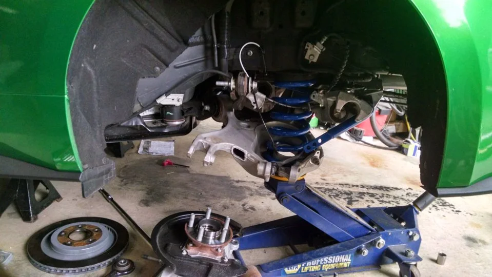

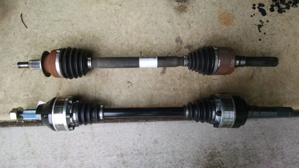

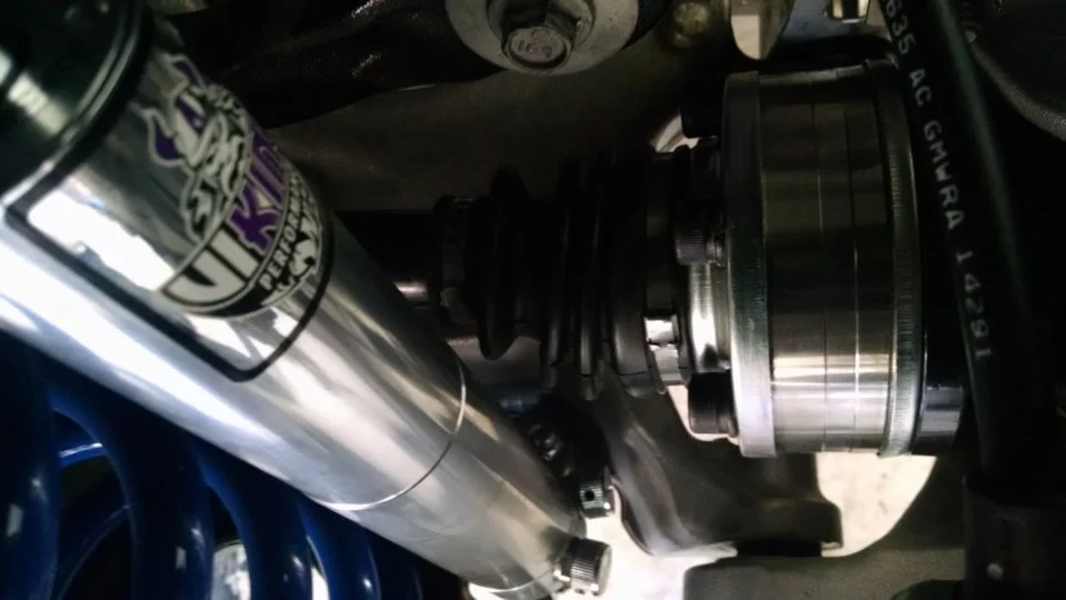

The rear suspension was a little more involved but didn't require anything more than basic tools and patience. The axles required a bit or work but again were very straight forward, the only issue I had there was needing a 1 7/16" socket to tighten the axle nuts.. somehow I had one rolling around the back of my work truck. The one thing I can say for sure is the quality of the UPR toe links really shows! These things are very well made and beautifully finished, not to mention they fit great. I can say the same about the Viking shocks, almost too pretty to bolt into the car. All said and done I'm really happy with the way the suspension turned out and am looking forward to getting out on the track!
Reactions: Sharad

Some side by side comparison

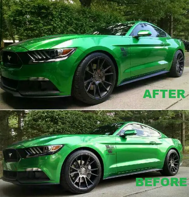

While there isn't a huge difference to the stance of the car, it was lowered 7/8" on all corners. I'm expecting it to settle slightly in the next week or two. After that happens I'll have the alignment gone over and should be ready to hit the track! The car handles on rails as compared to before and the suspension upgrades are already proving to be worth the effort and expense!
