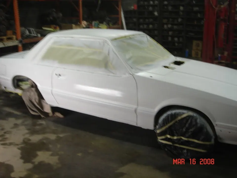

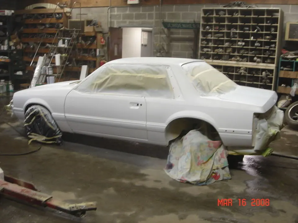

Project 81 HACK JOB....getting PAINT right now!!!
Just laid the sealer, and I gotta wait about 20 mintues before I can top coat. Here are some pics guys.....stay tuned!!!!!!!!!!!!!!1
Stay tuned.....My damn camera battery is about to die!!! NOO!!!!! If I can't get them all on here, I will do it at home for all of you!!!

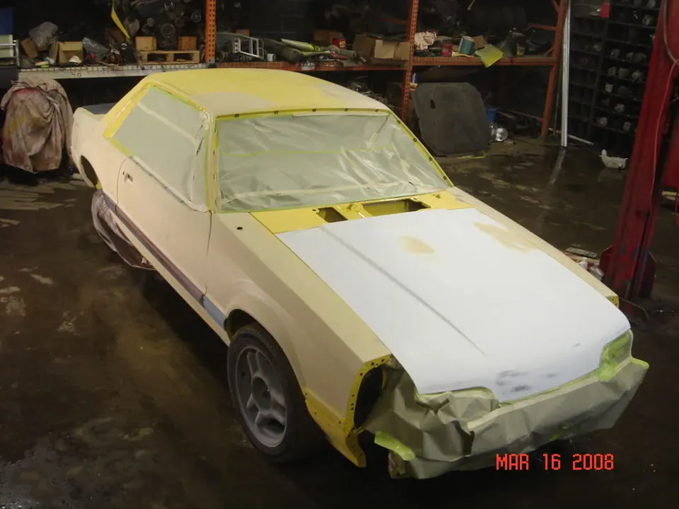

1st coat. It went on really well. I am very nervous because I just installed the Devilbiss rebuild kit in my gun. It is spraying fricking awesome, and I have been used to it spraying really bad. Also...I have never done an entire job in this single stage paint. It looks rough at first, then it seems to flow pretty well. I am never happy with the first coat, so no close ups.... I am anxious to see it after 3 and maybe 4 if I ahve enough paint.

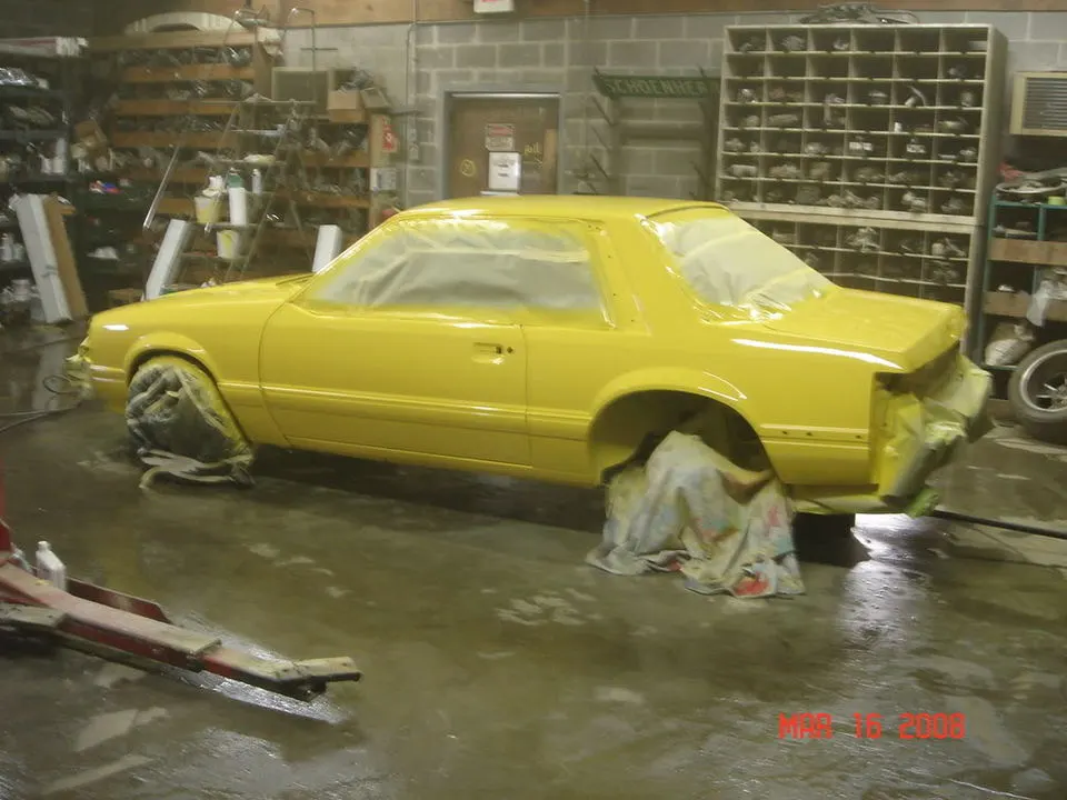

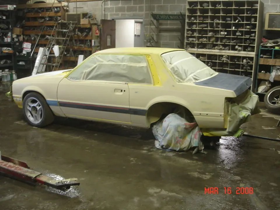

Just layed the second coat. Much better. It is looking good, and of course I am still wetsanding it this week. You really have to be carefull with this paint. I put one small run on the drivers side door and the right rear quarter well. They will wetsand out, but I should have waited longer between coats. It says 10 minutes, I am waiting 20 this time.
2nd coat...Sorry for the crappy pics. They won't come out better with all the fumes in the air. I have the exhaust fan running the whole time.

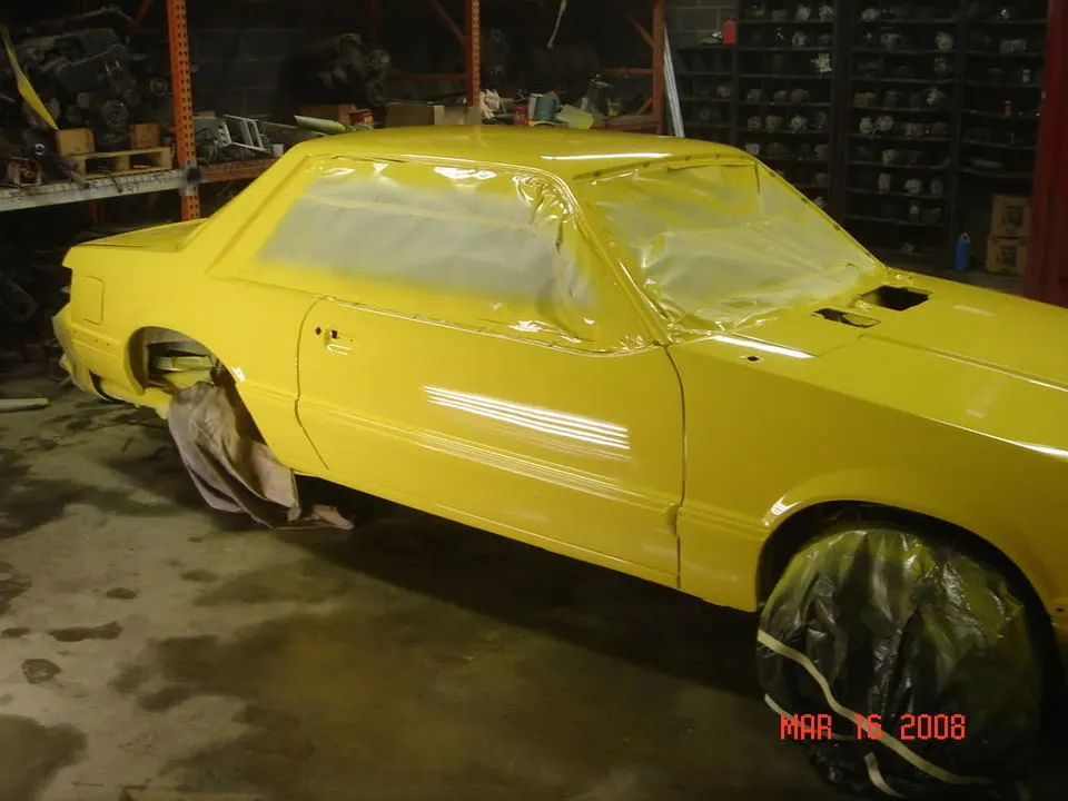

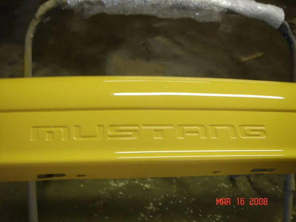

3rd coat. All done. I still have a lot of paint left. I didn't do the front bumper cover because it needs to be sent out to get stripped. I didn't get a chance to do it this week. Overall, I am happy it is painted, and I am happy with how it came out. This coming week will be wetsanding and rubbing time.
Here ya go. Time to go home and rest!!
I am pretty happy how it laid down. This paint dries super slow and it keeps geting smoother everytime I look at it. Can't wait to hit it with 1500 and 2000 and rub it out!!
