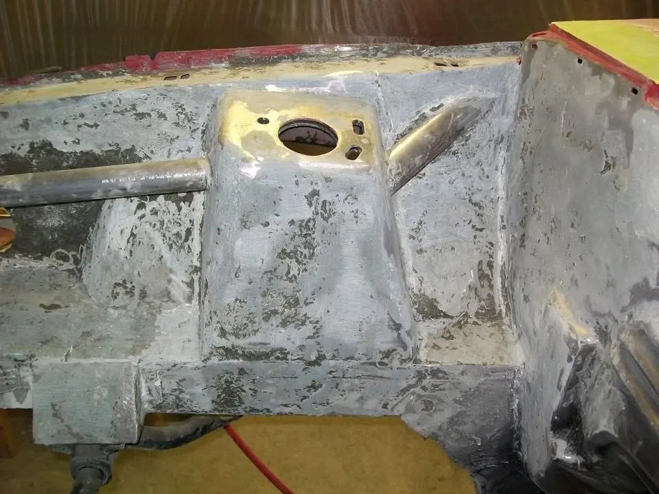

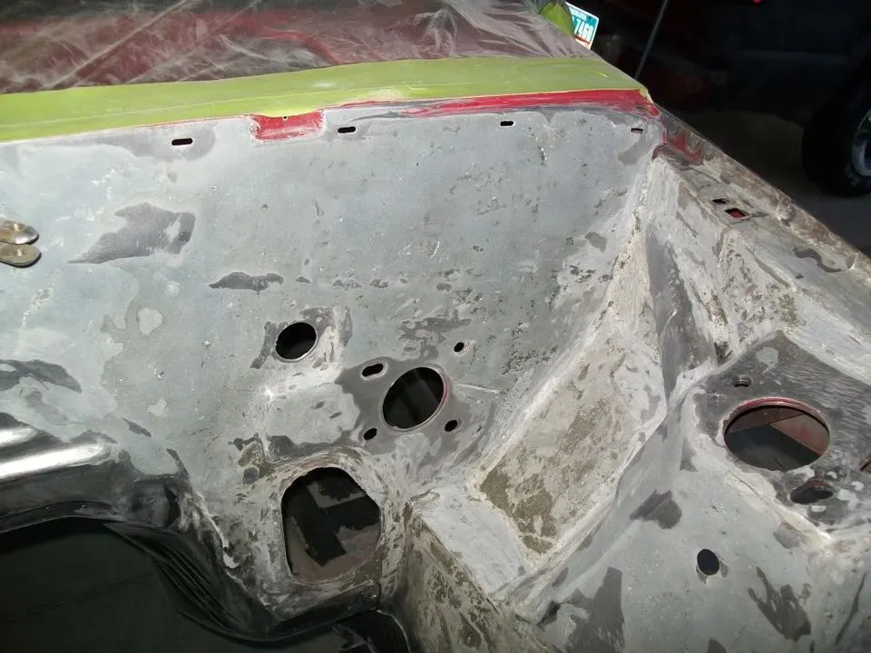

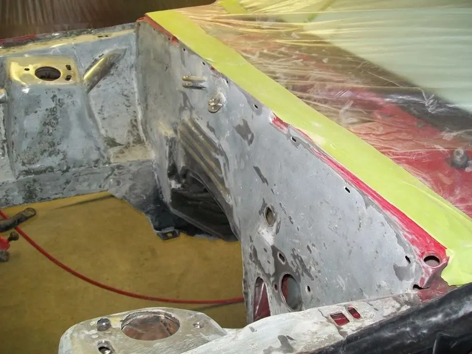

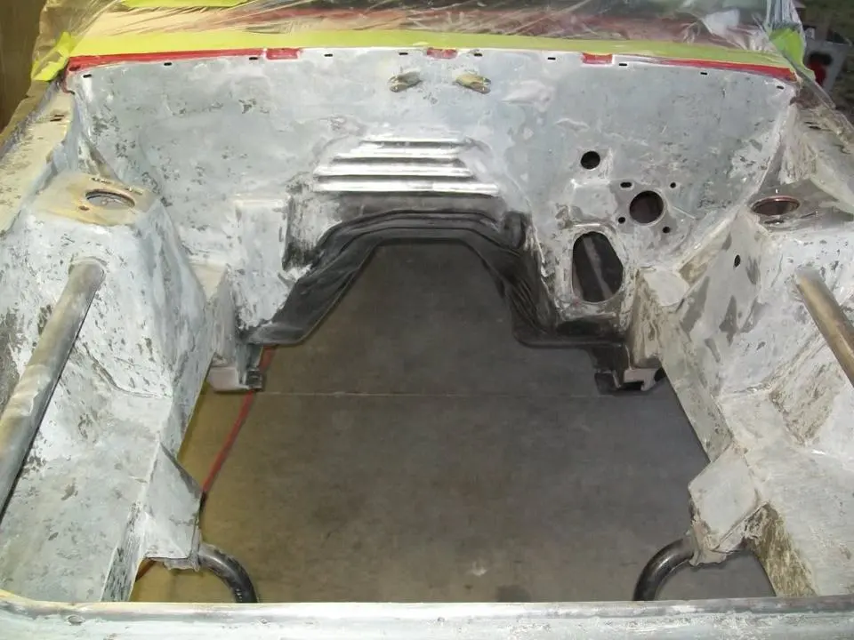

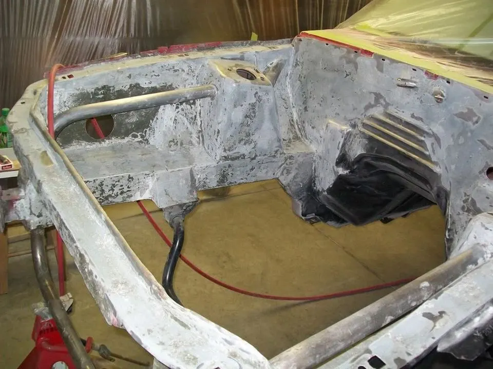

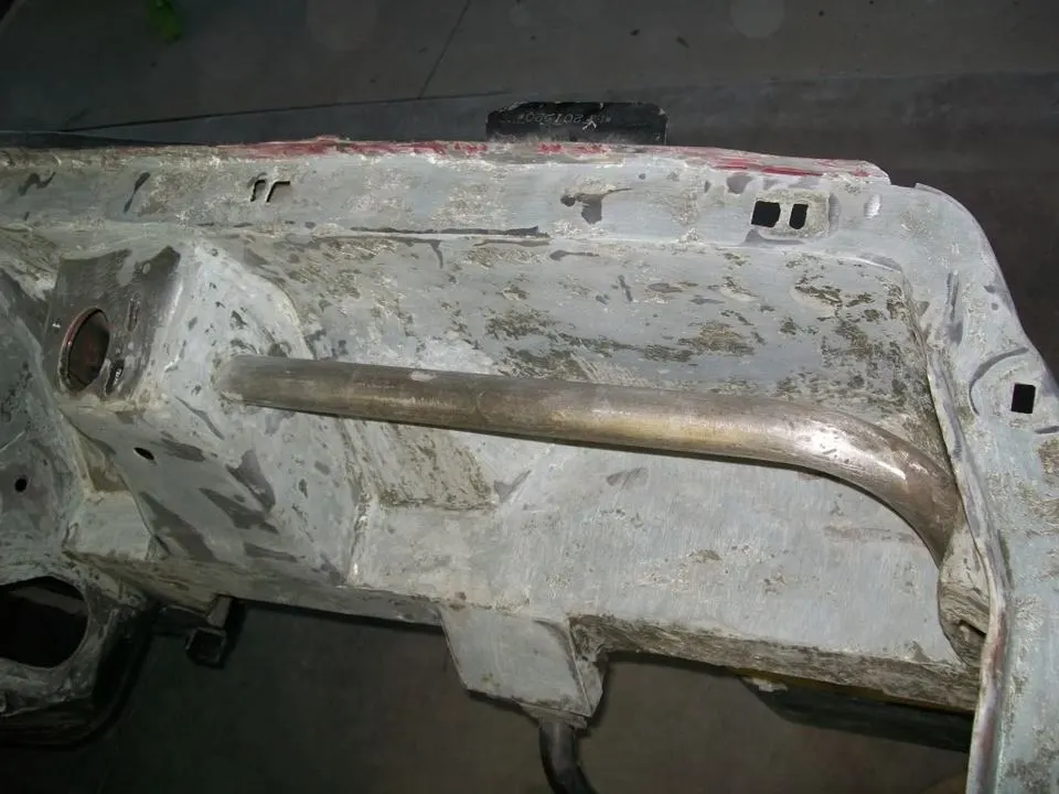

Started working on getting engine bay knocked down. going to be some serious sanding. First step is to get all the duraglass knocked down, then do a skim coat of some filler, then back to sanding. here are a couple pics

Custom,
Question,--- Did you weld the holes in the engine bay or did you duraglass over the entire engine bay or did you weld and duraglas the bay.

I'm sure hr welded up the holes. That engine bay's scary, I'm done with engine bays for a while lol.

90silverstang said:
Custom,
Thanks
Good question All the big holes had patches made and welded in, all the small holes were filled by holding a piece of brass, or was it copper?, behing the holes and welding them shut. The reason for the kitty hair/duraglass, whatever you want to call it, was to smooth everything up. Mainly the seams and whatnot. Most of it will be getting sanded off, then a skim coat of lightweight filler will go on, then we will knock that down and see where we are at then. Probably didn't need to use the kitty hair, but i don't like using bondo to fill in seams and to build the surface up. The firewall is going to take the most work, since we eliminated the pinch weld. But this is all well worth the effort, the end result is going to be outstanding.

Welding Holes
First I want to let you know that I am new to welding. I just purchased a Hobart 140A mig welder. Put some .025 wire in it with Stargon gas. I got a scrap fender from a local body shop that I will practice on.
So with that said, when you use a piece of brass to put in back of the hole, how do you keep the brass piece in place?. Does the brass piece stay welded on the back of the inner fender after the work is done?
How big are the brass pieces do you cut for the holes?
Can't wait to try this welder out and practice.
Your comments will be much appreciated.
You got the right idea, practice on scrap fender That welder will get you by to do a engine bay and other sheet metal work, but don't plan on welding anything thick, you can't get enough penetration with a 140. But from the sounds of it, you are just doing sheet metal. Its actually not brass, but copper, sorry i was really tired and couldn't remember what it was. But anyways, You are NOT actually welding the copper, just use this for filling small holes, holes that you don't need to cut a patch for, like screw holes and such. The weld will not stick to the copper, but gives you a backing to fill the hole in. The way we did it was, one of us would hold the copper on the back and the other would weld. Most of the time, you won't be able to do both, but here is something i found that would work if you didn't have anyone to help
Eastwood Co. - Magnetic Plug Welding Tool Horizontal
That would be a good investment
Then make patch panels for all the bigger holes and weld them in. Practice makes perfect. At one time I couldn't weld, but i was probably like 4 or something Hope that helps ya out

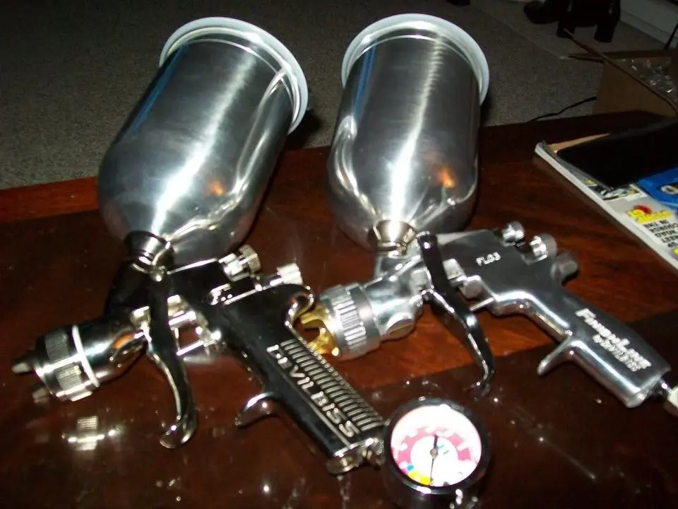

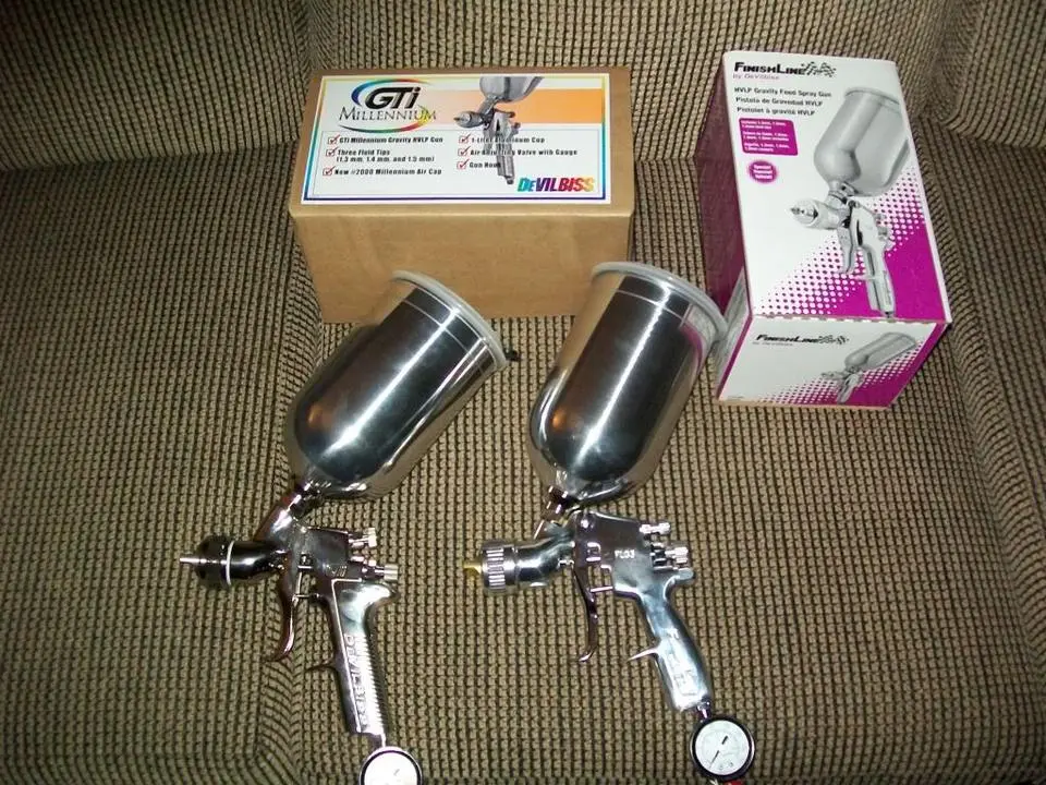

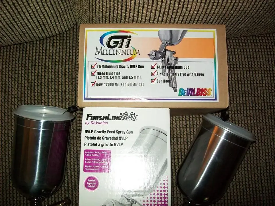

By the way, I bought some new guns!!! Happy day for me

Very nice paint guns. Looks like your gearing up to shoot the engine bay.

Thanks, yea, got the stang cage and motor bay to paint. I also have a few other things to paint this spring, dads 67 camaro, at least one of my camaros, the girlfriends jeep. Oh, and dads s10, thats going to be satin black, with a 383 tunnel ram, dual carbs, 5 inch cowl hood. going to be a nasty lookin little truck I really like to paint.
