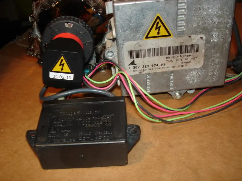

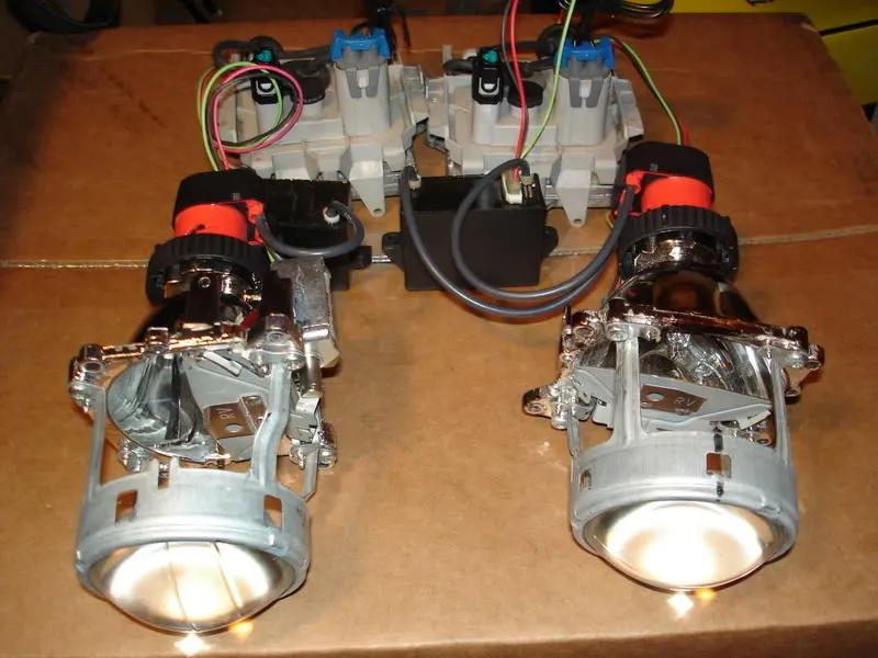

I bought them off ebay for $287 they are e46 hid lights the kit included: 2 ballast, 2 igniters, 2 ds2 bulbs(true HID bulbs), and 2 projector, and luckly no cut wires:D

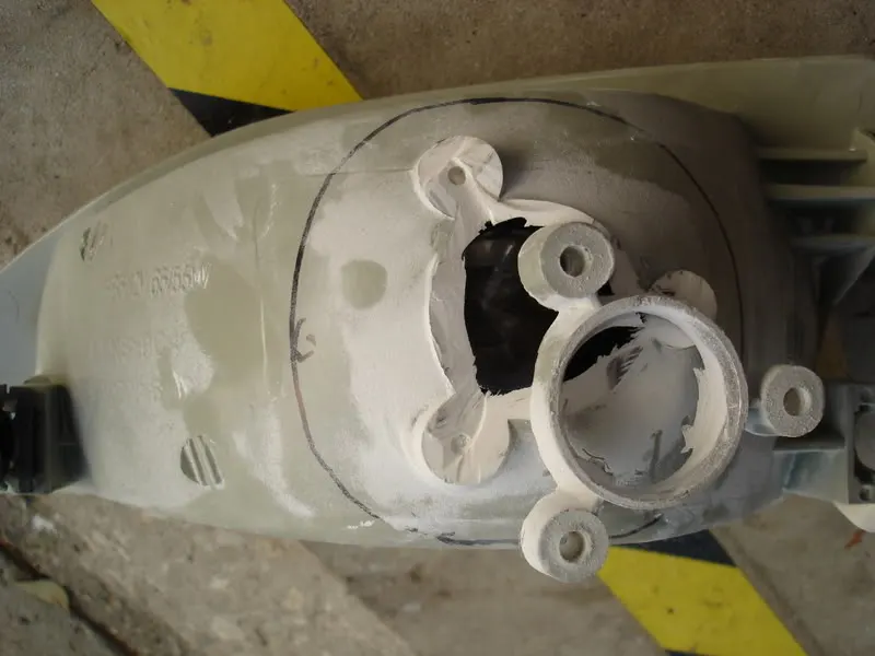

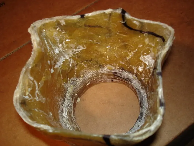

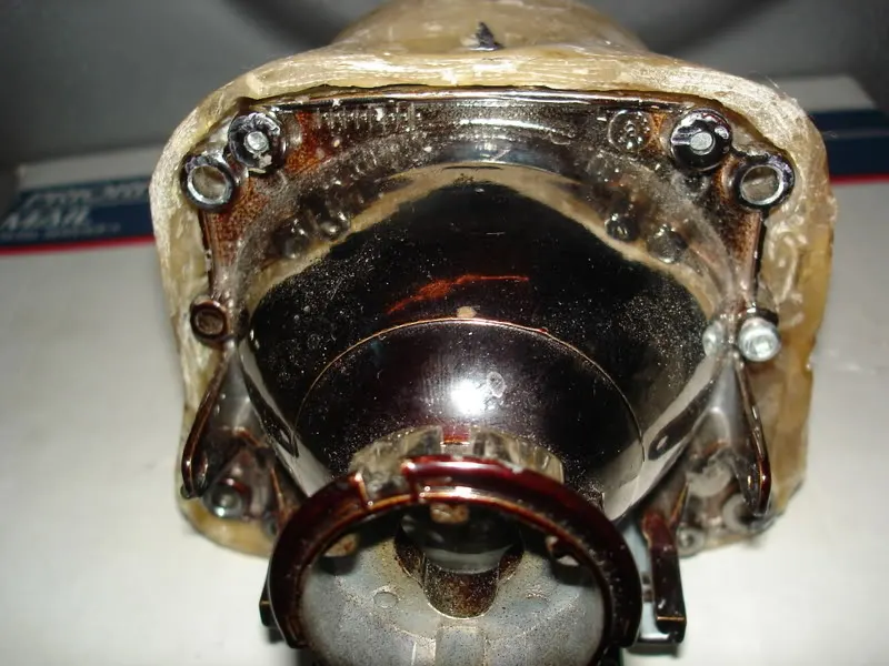

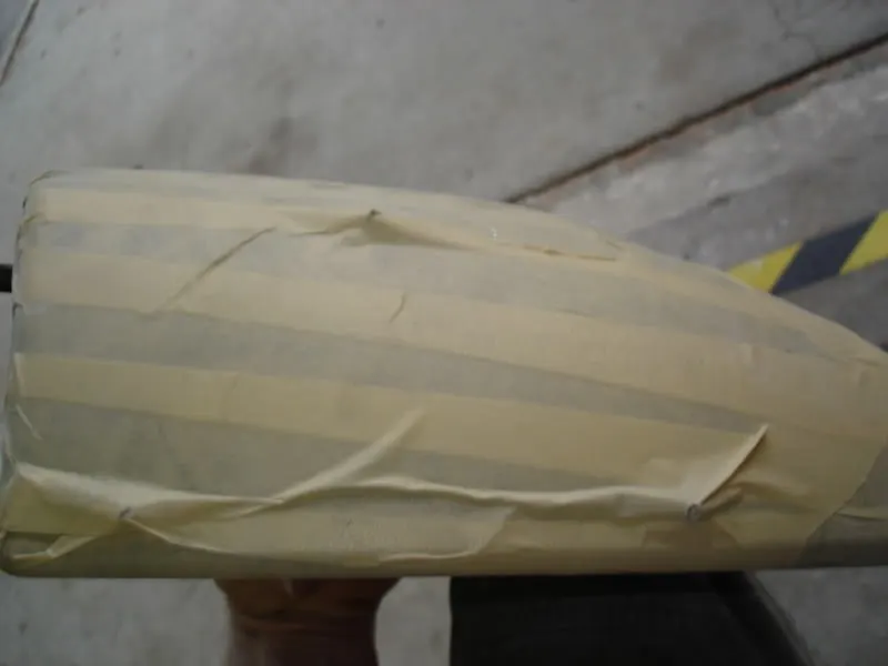

Making the housing for the the lights was difficult at first, but with time it got better. First you wrap the projector in Aluminum foil twice, Then lay some fiber glass strips not too big or else it'll leave pockets of air and hole. But once you get the first layer all the way around you can put bigger pieces on. :nice: I put like 5-6 layers since I heard that fiberglass warps with heat so more shoulb be better.:D
Then I cut all the extra fiberglass off and cleaned it up some. then pryed it off the projector littleby little, Be very careful you don't break anything. It should look like this.

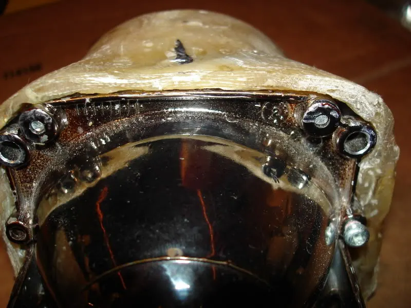

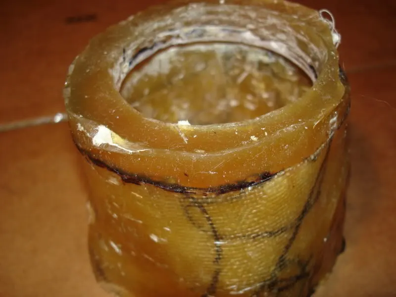

Then I neede to find a way to secure the projector to the housing and since the projector had 4 mounting holes on it I used them and poured some fiber glass into some take I layed out to make platforms( highlighted with black marker)

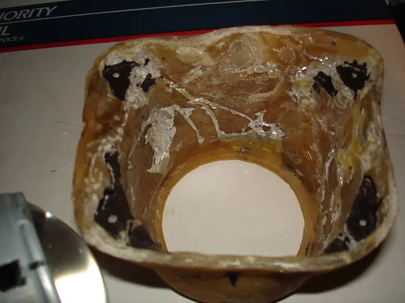

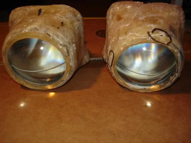

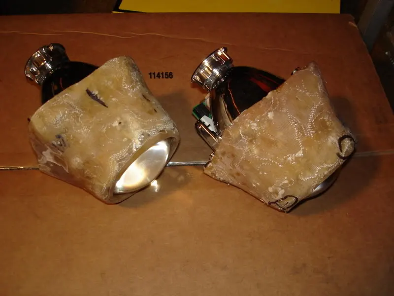

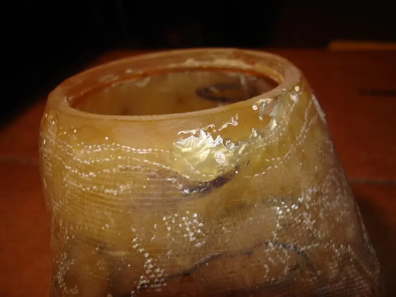

Once that was done I needed to clean up the front of the light and since I didn't use the bmw bezel that would of cost an extra $60-$90:nonono: I needed to make something so I wraped some tape around the front and put some tape over the projector lense so nothing sticks to it, I then placed a clyindrical object centered on the projector lense secured it the pured fiberglass in between the two and got this.
The black lines are from where I layed more fiberglass and filled in holes.

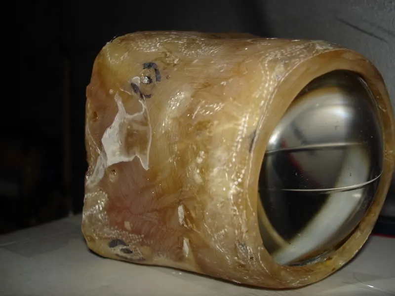

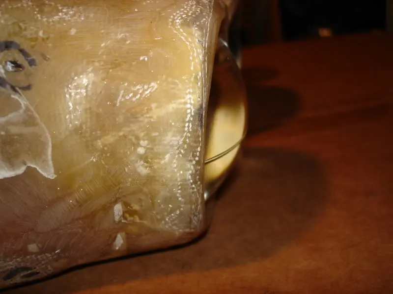

To get all the excess off I used my brothers nuematic angle grinder with a red scotchbrite and it cleaned it up nicely. Notice how I left a lip to hide the metal.
Heres where Iam right know.

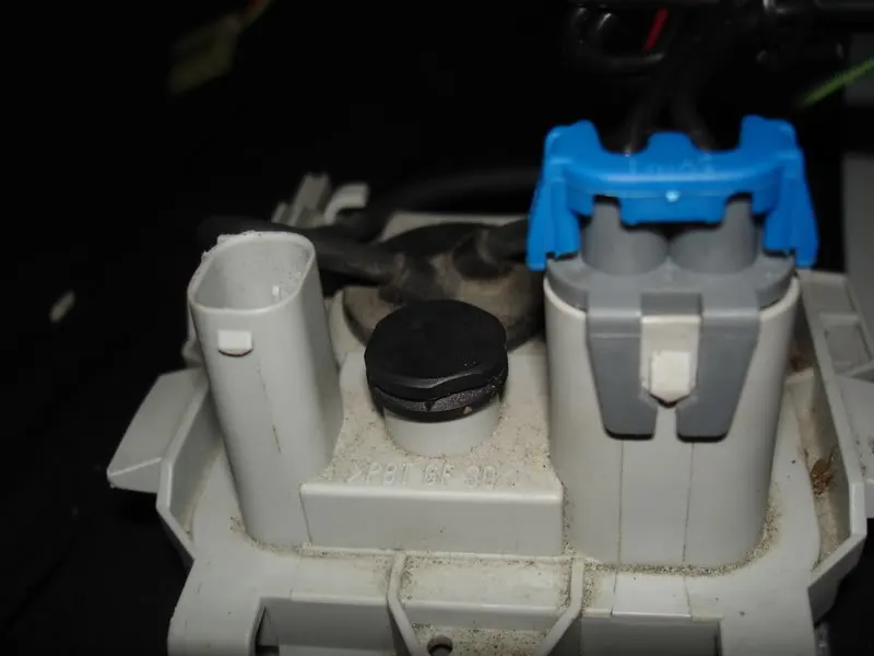

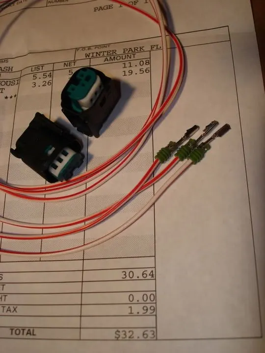

I ran in to a snag when I could not locate the connector on the left.
I asked Ben if he had any lying around at work but he didn,t, So I asked neverclear over on e46fanatics.com and he came up with 2 part numbers for me.
PART # 61-13-8-365-348 PLUG HOUSING
PART # 61-13-0-006-665 CONTACT
:flag: :nice: So Yestterday went to pick them up at the bmw dealership right next to the Highway:D a couple of miles away.:D "LETS JUST SAY I GOT THERE QUICK":D so i went in got the parts and lets just say they weren't cheap.:eek: if you don't believe me take a look at the invoice total ( those on the invoice are what I bought.).

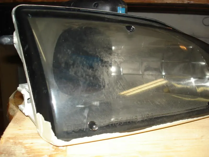

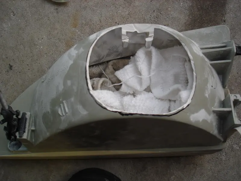

heres some pics of my $200 headlights destroyed to perfection:( .
I threw some rags in the headlight so that I don't damage the inside, with a file or debris from dremel.
Also covered the front with masking tape, since I kept putting the down lense first:mad: .
There is duston the lense.
And heres the mach up of the prorjector sitting in the housing.:)

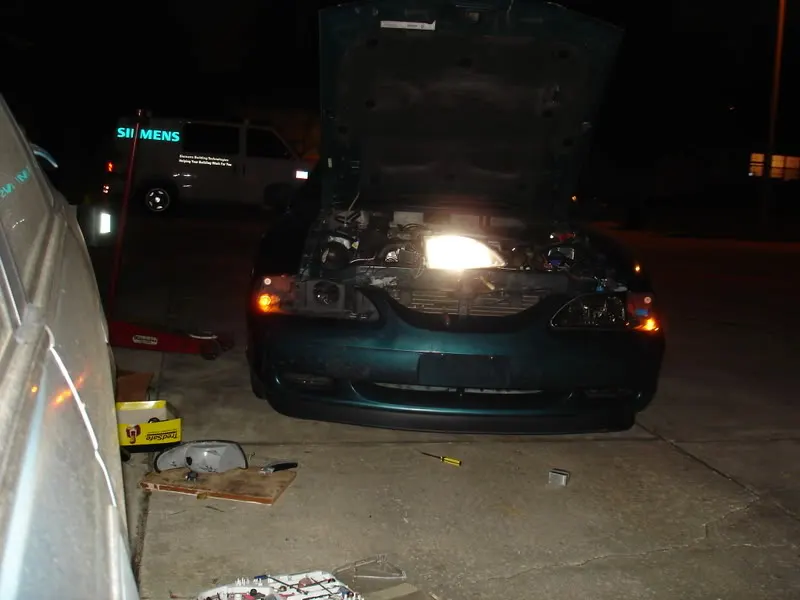

And here a one eyed stang. :rlaugh:
I will finish soldiering the wiring up to night (tomorning).:)

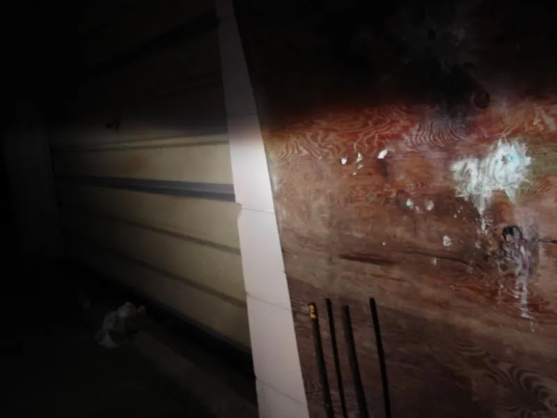

Ive good good news and bad news:nice: :notnice: .
Heres the bad news I can see 15ft infront of me now:D but not any further :( .
I rushed putting them in since it was like 60 degrees out and windy and I only had on t shirt and shorts.:nonono: , and now my projectors face down to low :bang: . SO I have to cut them out and reseal them also one is tilted.:nonono: there is also some jb weld that got into the light. and some of the reflective paint came off. :mad: . and still no brights.:nonono:
Also I forgot to bring my camera.
And for the good news I have em in and they work. :nice:
