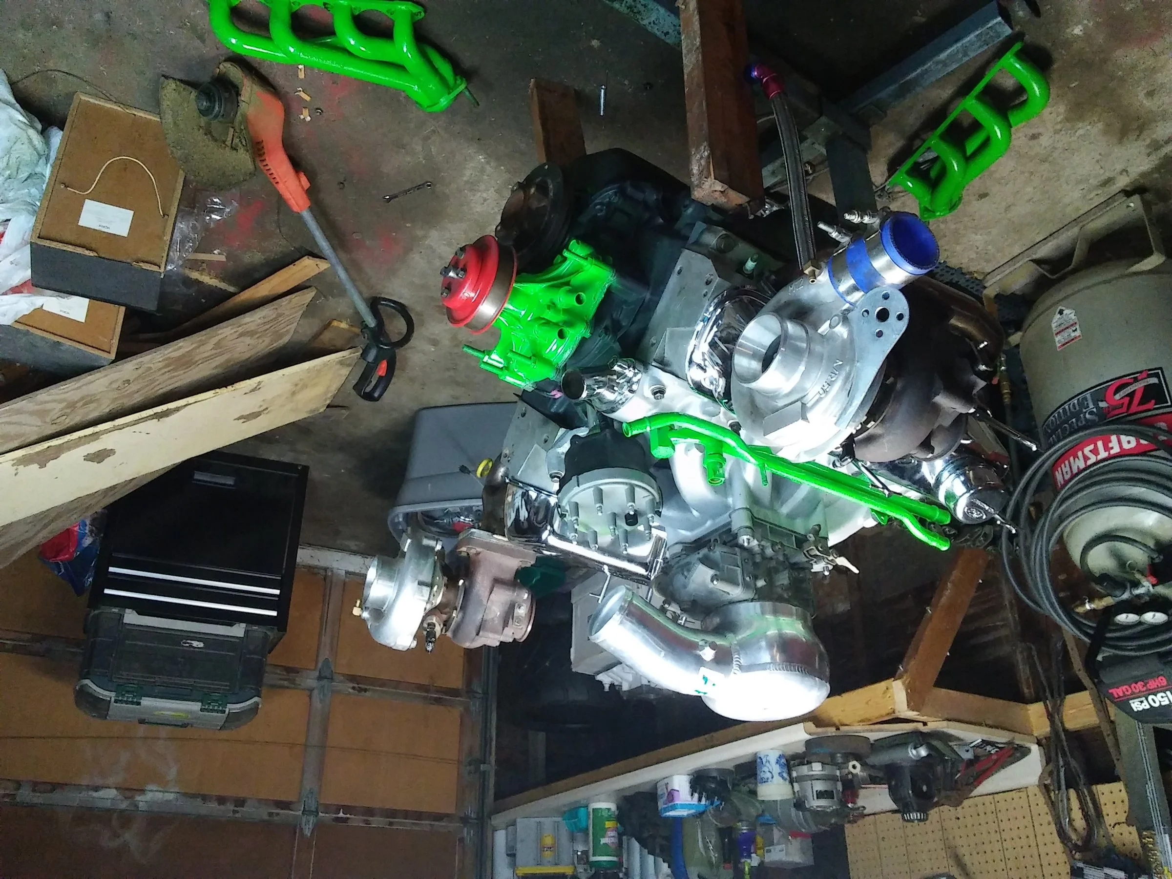

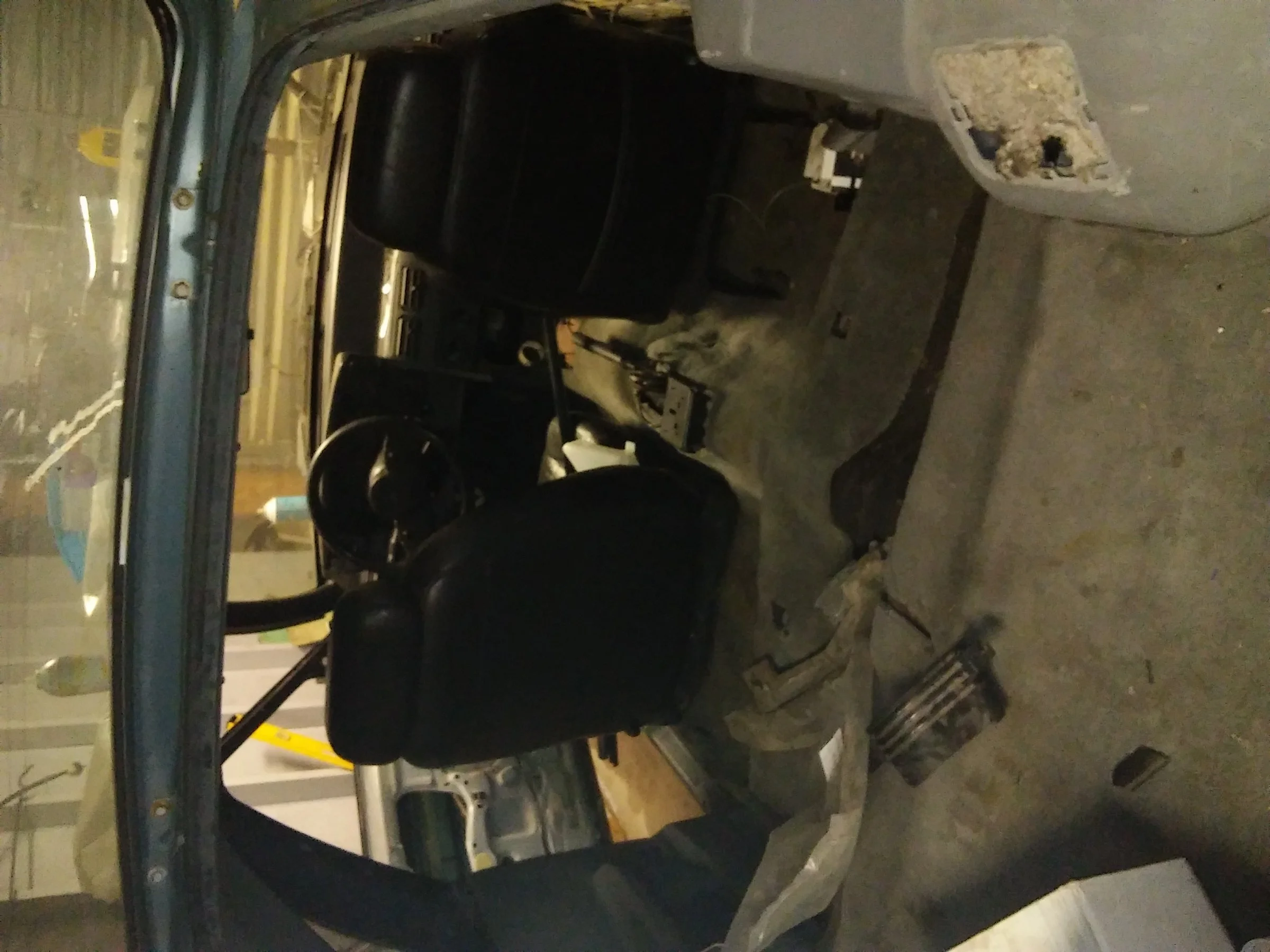

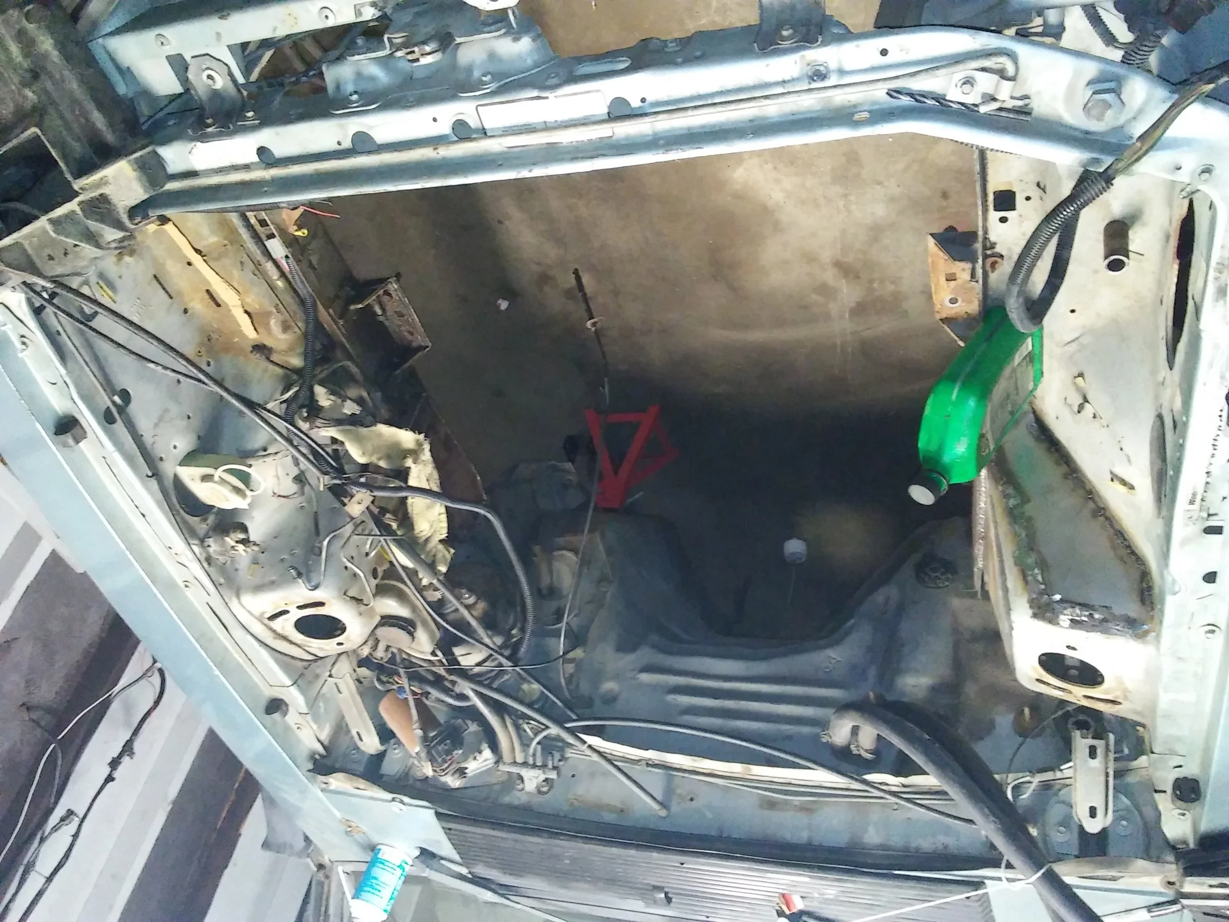

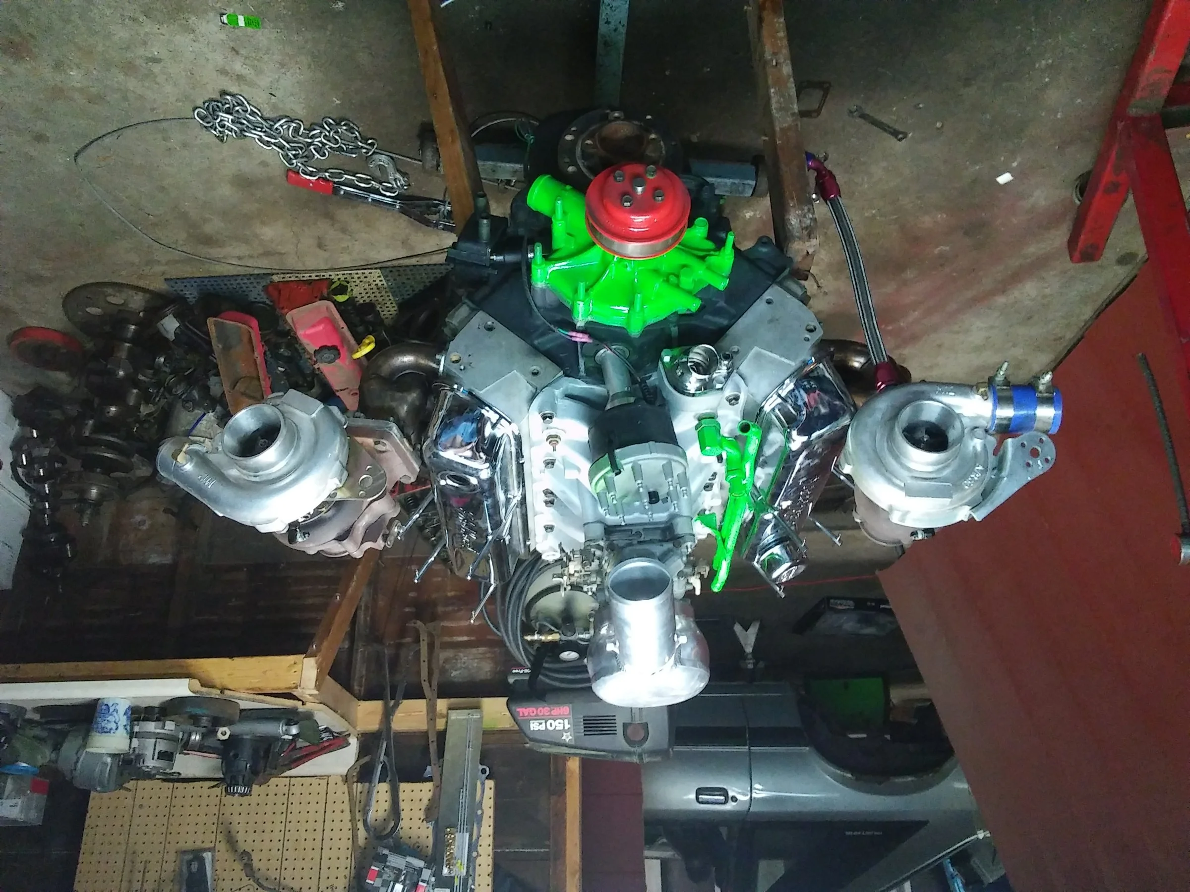

Ight been awhile since i made any post. Life got away from me. Daughter is growing up fast and trying not to miss out on it. As far as car goes. The 88gt is scrapped. And the 89lx is under way. Mods so far:
Tubular rear control arms
95 gt rear end with posi and 3.55
Aluminum drive shaft

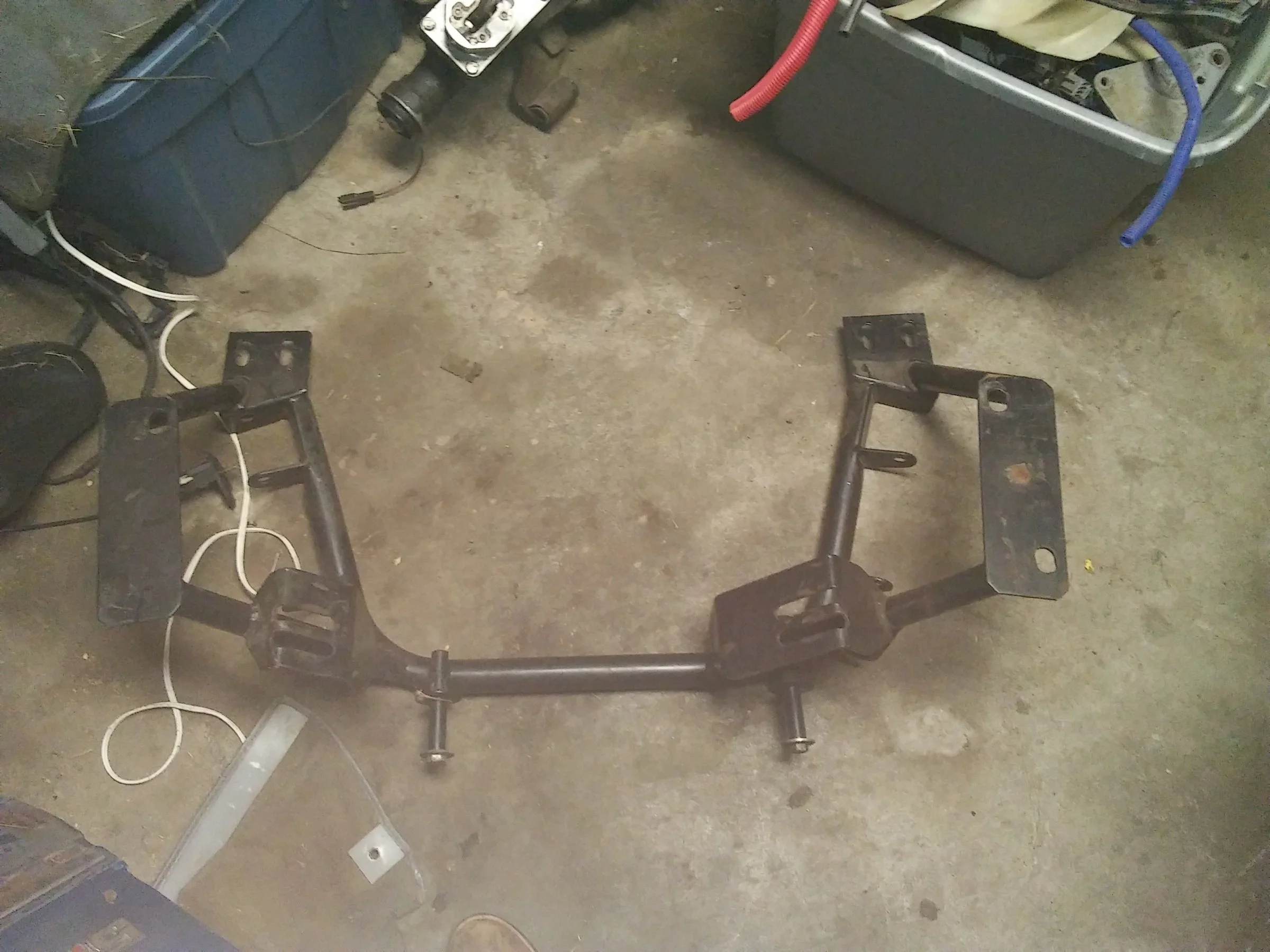

Tubular k memeber
Lowering springs

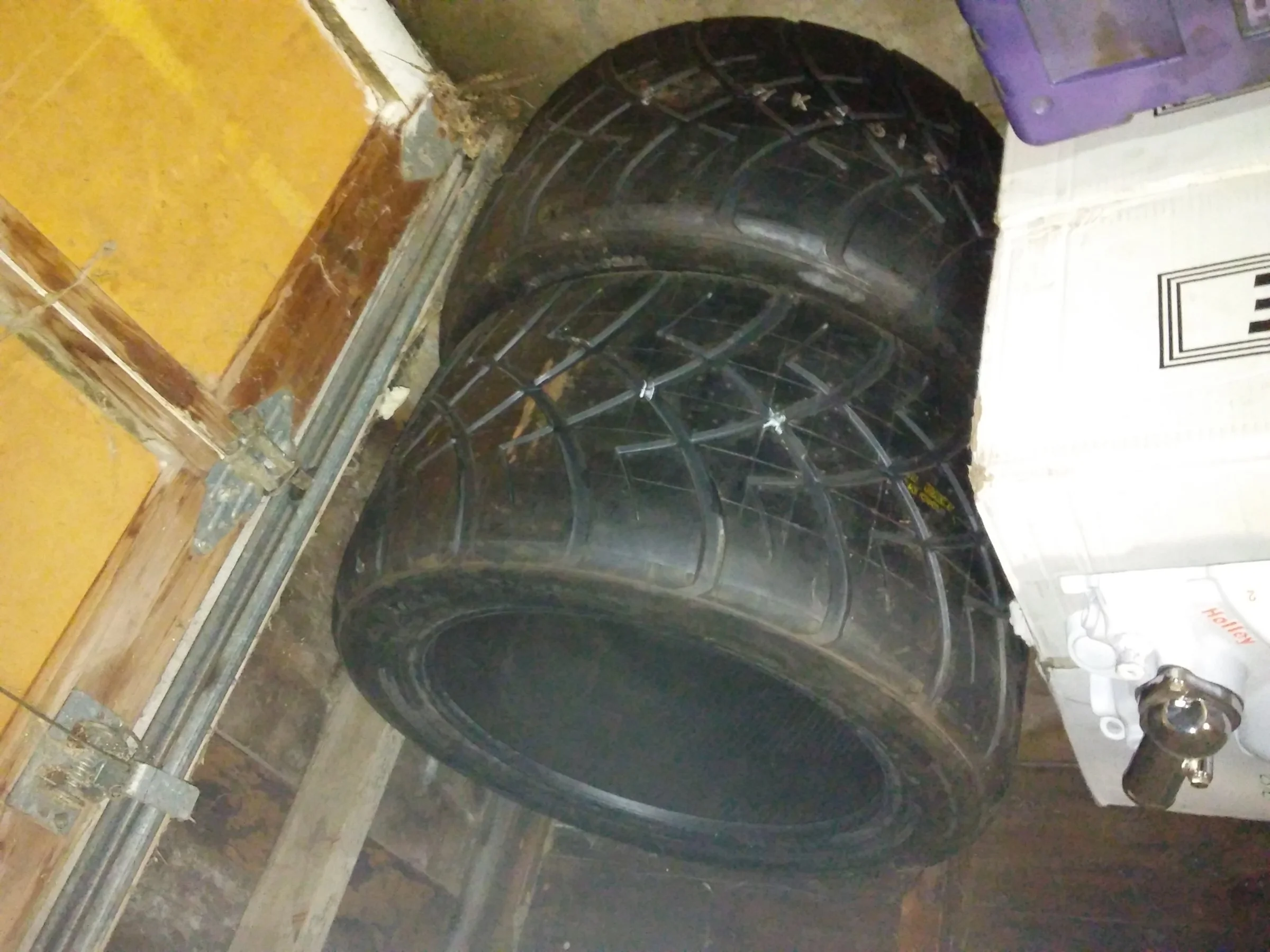

315 35 17 radials
Roll control
Aluminum radiator with twin fan

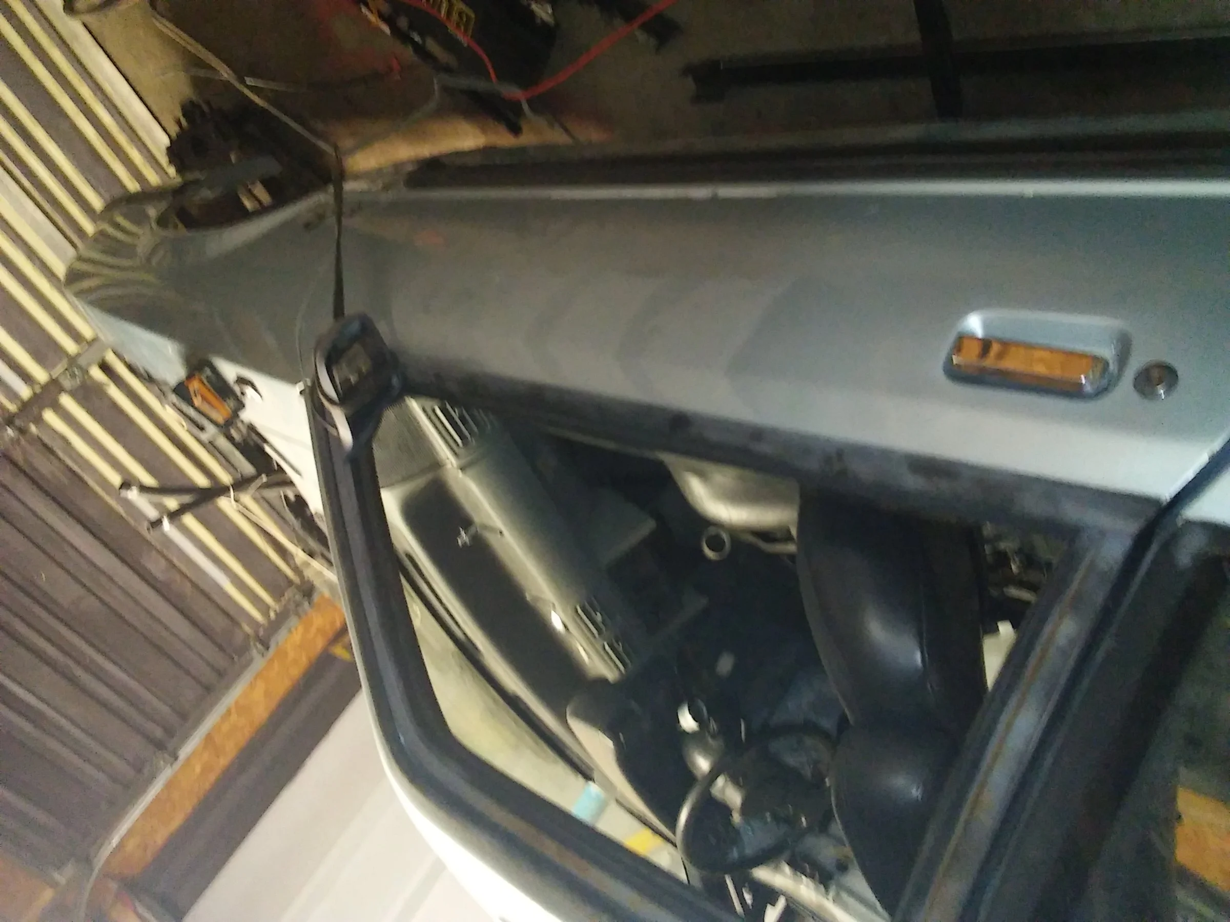

All new rubber around hatch doors and windows.

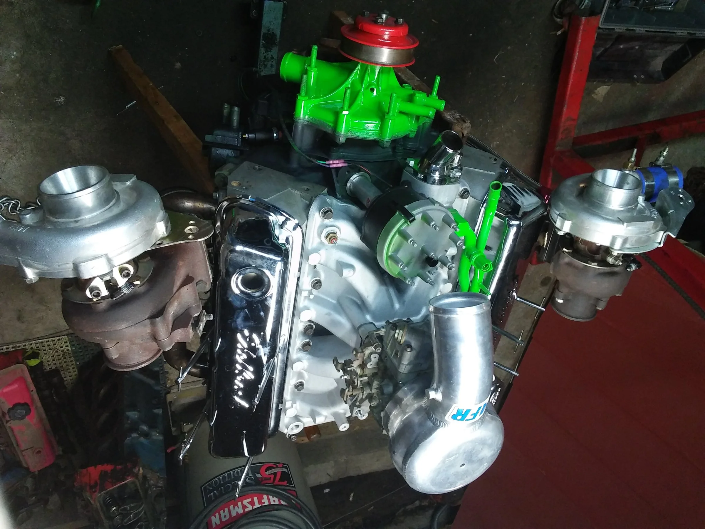

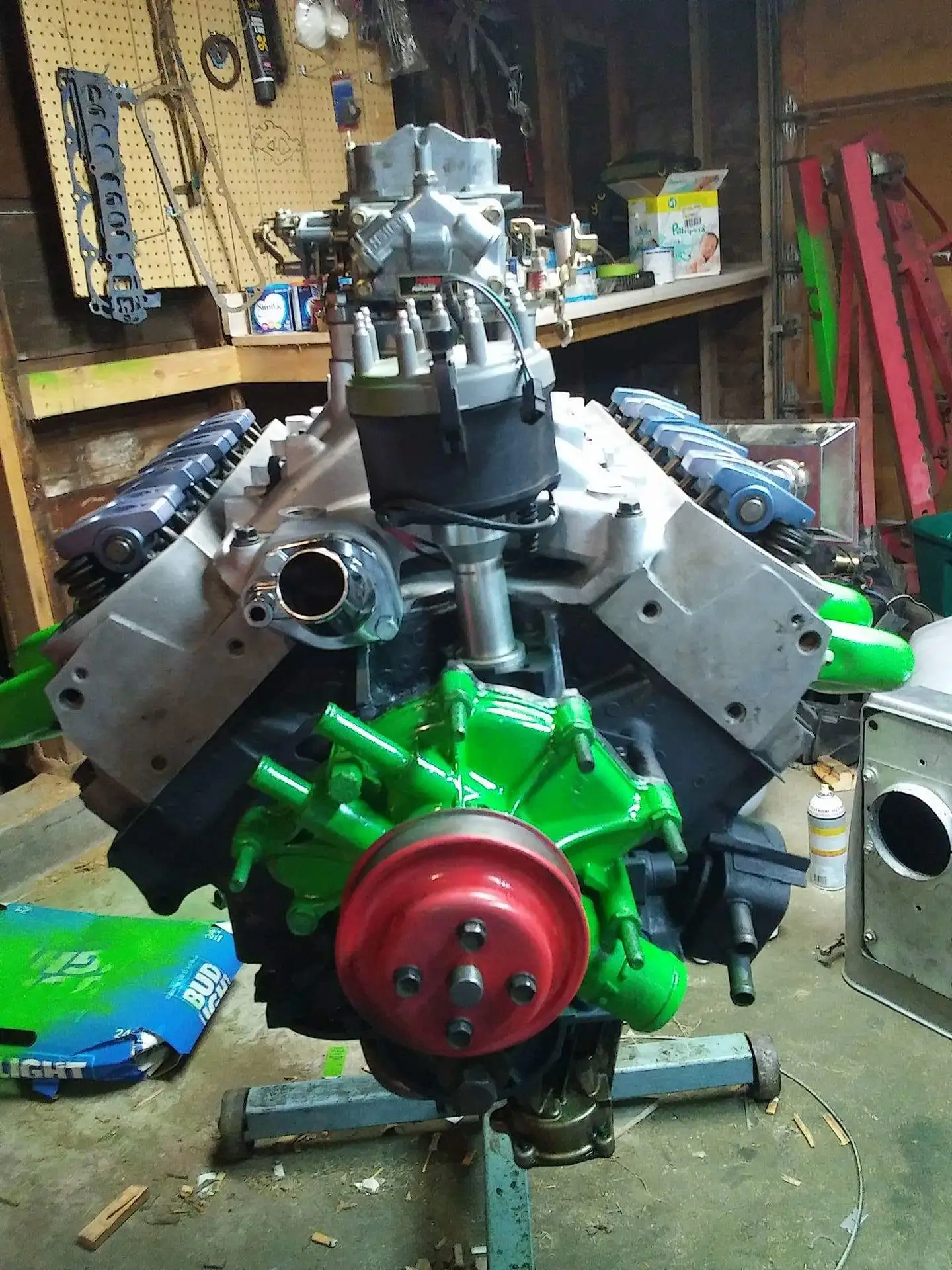

Motor im building is a 5.8l twin turbo. With twisted wedge heads. Anderson n41 cam. Blow through carb. Forged rods. The works. Running low on money hence the name blown budget. Ive got about 4000 in it so far. Which i guess isnt to bad seing as i pretty well have it all. Just gotta get it together.
