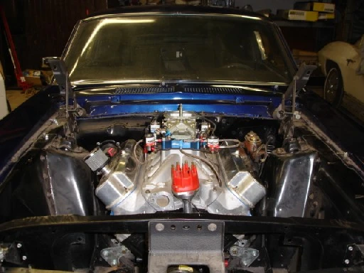

Combo is:
SVO W 351 bored and stroked to a 427. Victor Glidden Heads,Super Victor intake, billet crank,billet rods, Ross pistons, Jesel rockers. Speedtech 2 stage nitrous plate. Makes 840 hp and 800 ft/lb on 93 octane and both stages. Carb is way too small only 800 cfm. Going up to arounf 1000-1025 cfm carb. Hoping to break the 1000 hp mark. By the way it has a 7" snorkel hood looking to change to a cowl hood.
