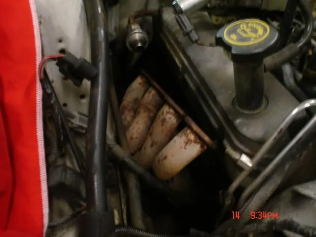

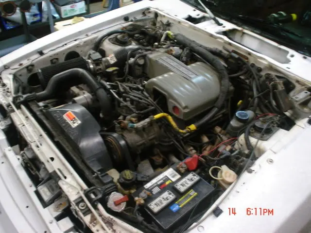

I have a 1990 Mustang GT. I've had the car for about three years now and i finally decided to rebuild it. It has always run ok...but i've had a few problems here and there like everyone.

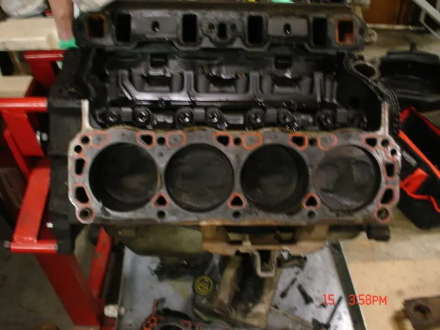

After pulling it out and taking it apart, I realized I couldn't have done this at a better time. The rings were almost gone and it had been going for so long that it had a noticeable lip that you could feel on the inside of each cylinder. Since, I have had it bored(really had to anyways) to a 306, and have been gathering parts. As of right now I have almost everything to put it back together but haven't had time yet. But I believe i'm starting the first of this week.
I'm a pic whore so expect lots of pics!
Oh yeah...im a young buck only 18..so no jokes!
Taking the hood off

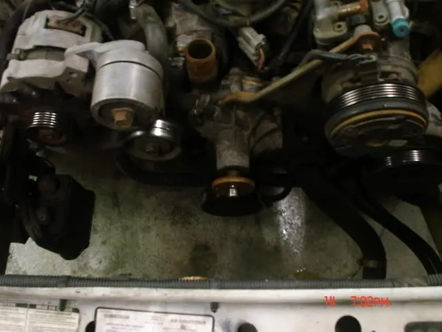

fan, radiator and belt off
Shorty headers are a B##CH
all belt driven acsessories off

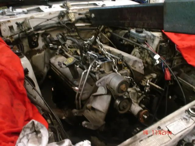

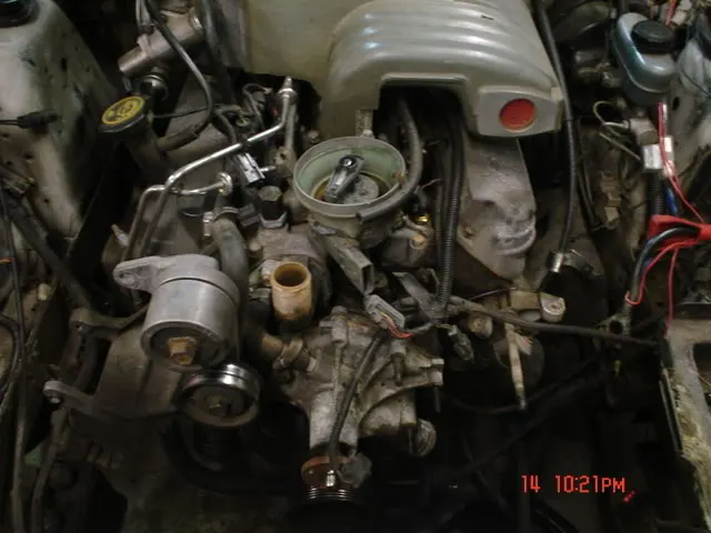

almost ready to pull

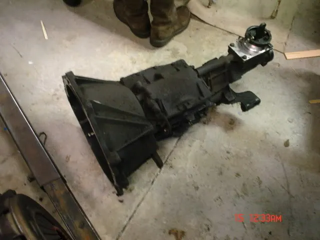

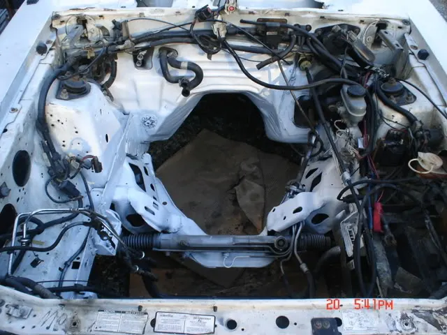

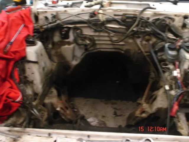

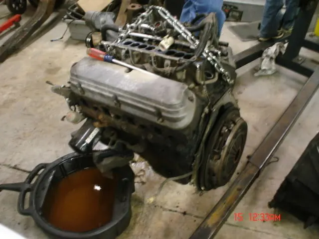

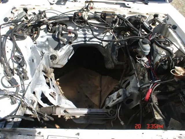

yanked and tranny removed...VERY dirty..also..look at the water that drained out of it

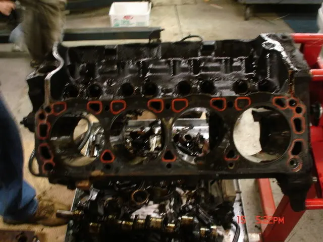

heads and lower intake removed
pistons, rods, main caps, and cam removed

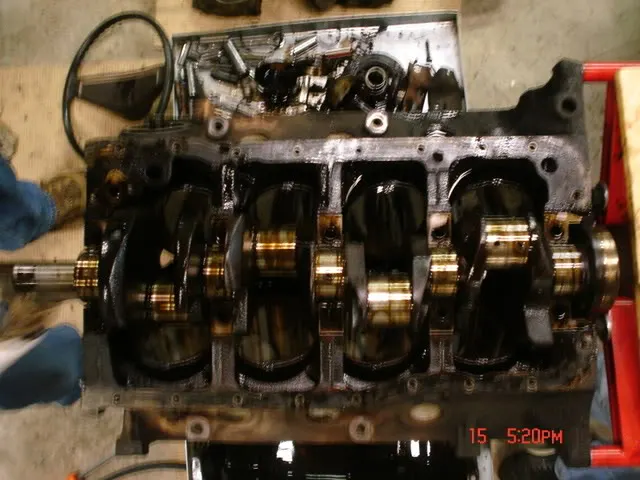

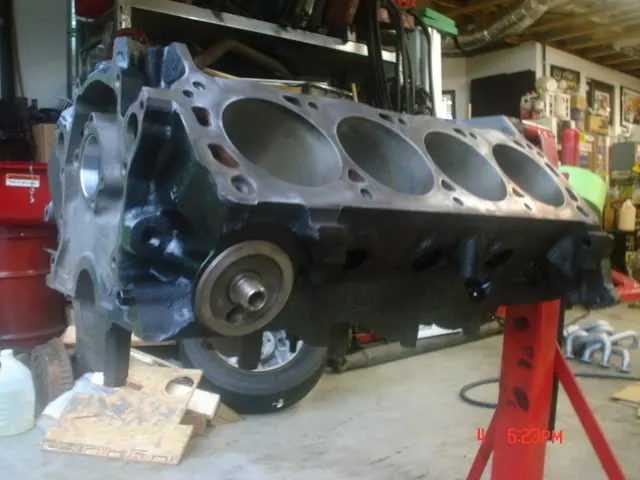

Bare Block

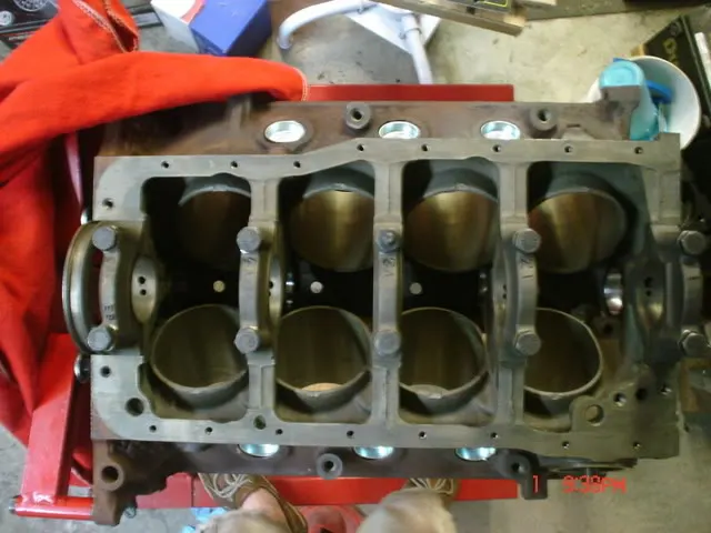

Block back from the machine shop, bored, honed, and cleaned

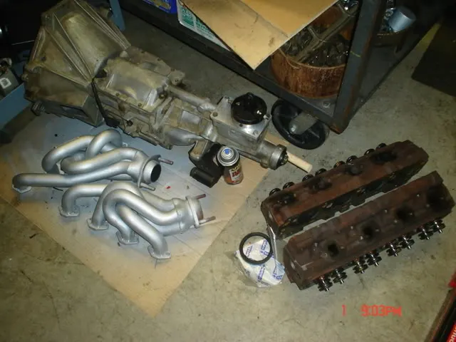

I got a newer tranny off my cousin....mine was losing the synchros in 2nd gear....but here is a pic of my old tranny and the one he gave me with my old bellhousing cleaned up..also my painted headers and my heads

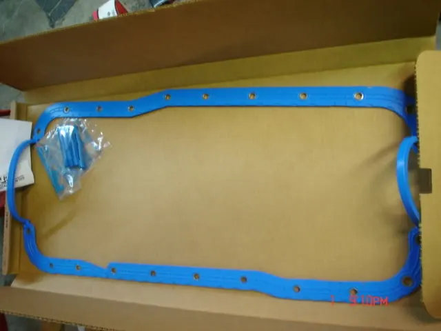

oil pan gasket

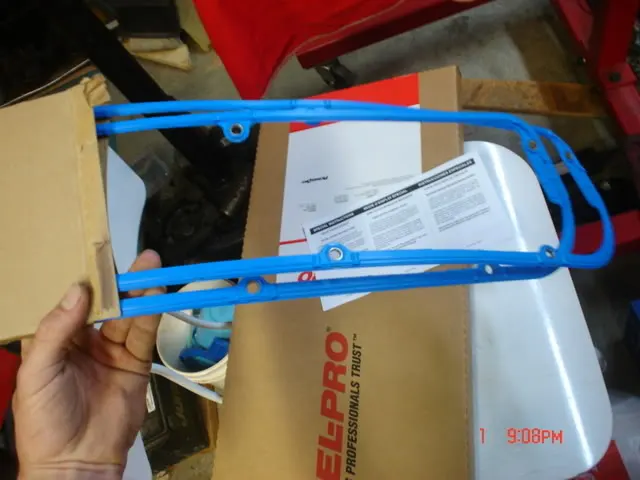

valve cover gaskets

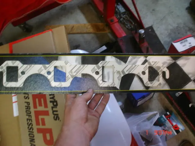

header gaskets

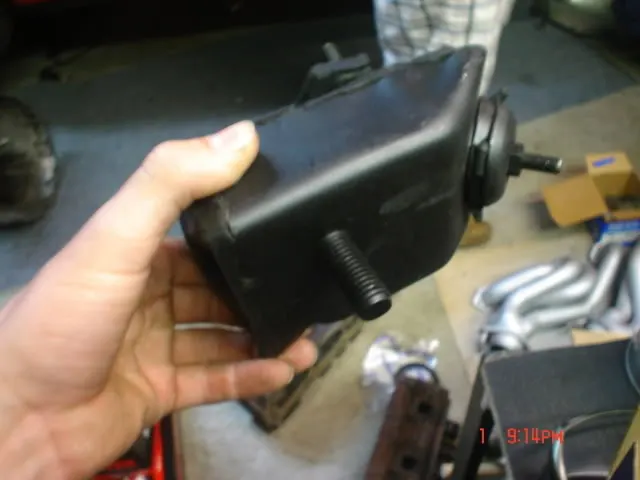

motor mounts...wanted to go with the urethane ones but i am just gunna get them down the road

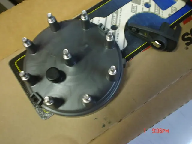

rotor cap and button...gunna get an msd distibutor later though when i have the cash

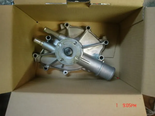

water pump
clutch

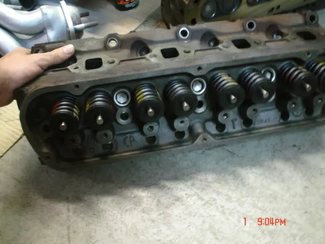

My stock heads..had them surfaced and i got bigger valve springs

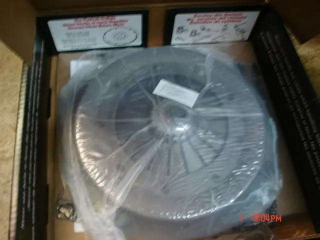

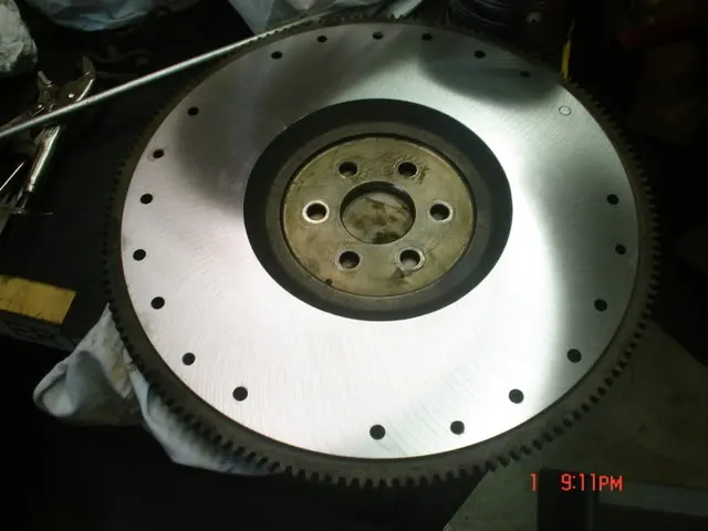

newly turned flywheel

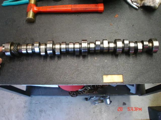

e-303 cam

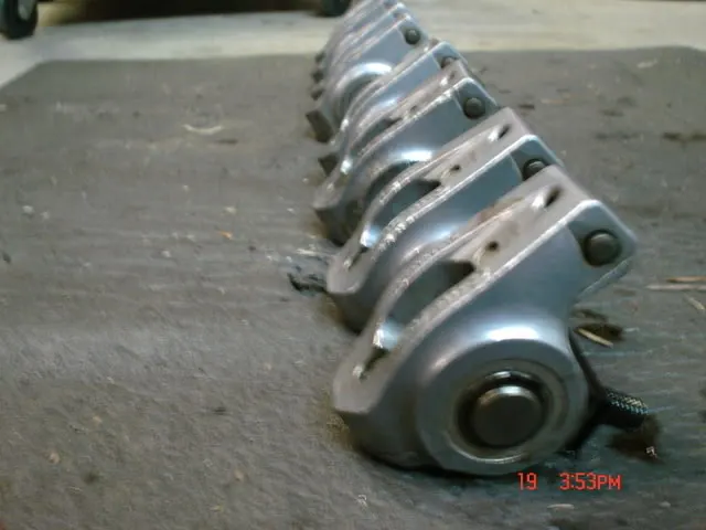

cobra 1.7 rockers

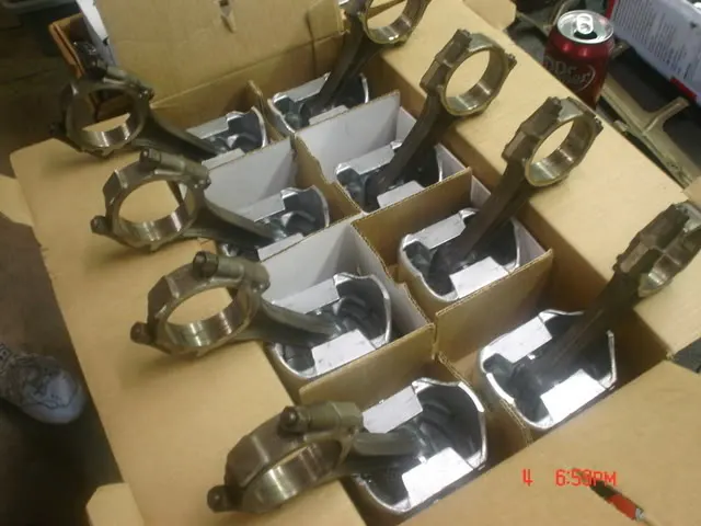

thought i had a pic of my pistons and rods but i guess i forgot....also stuff i forgot to take pics of but i have....new timing chain and gear...bearings, rings, crank......umm....valve covers(soon to be polished)...oil pan....maybe som other stuff....hope you likee teh motor

looks very nice,try and do something with all the wires under the hood.sweet project im subscribing.

looking good, now is the easiest time to hide 60% of the wires under the hood, you can run them under your front fenders, search around you will see a ton of how to's

If you got those motor mounts new at the parts store, take them back and get a set of convertible mounts. The vert mounts are smaller, stronger, and they supposedly lower the engine by 1/2" or so. They were even cheaper than the hardtop mounts when I bought mine; in 92 or 93 the hardtop foxes got vert mounts from the factory.
good to know ill check into it!

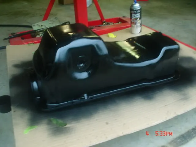

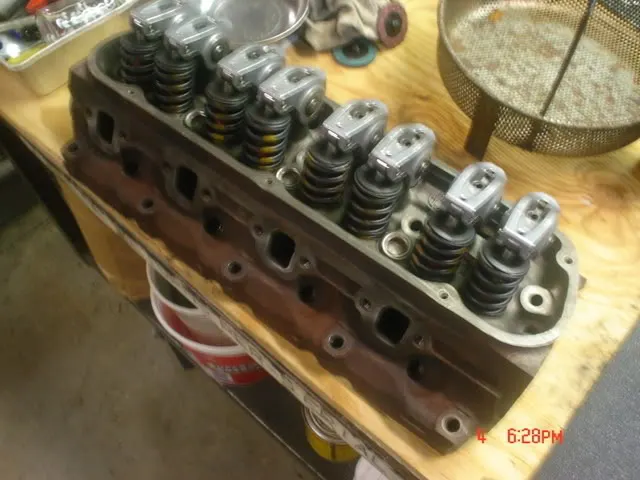

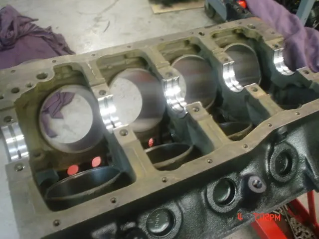

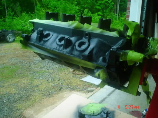

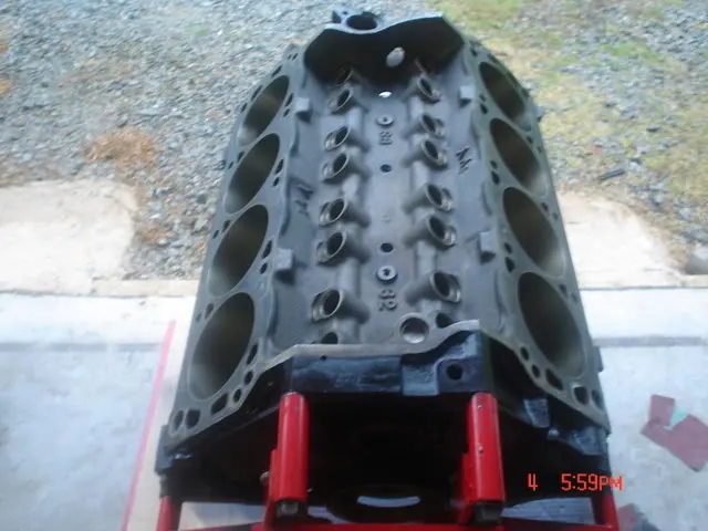

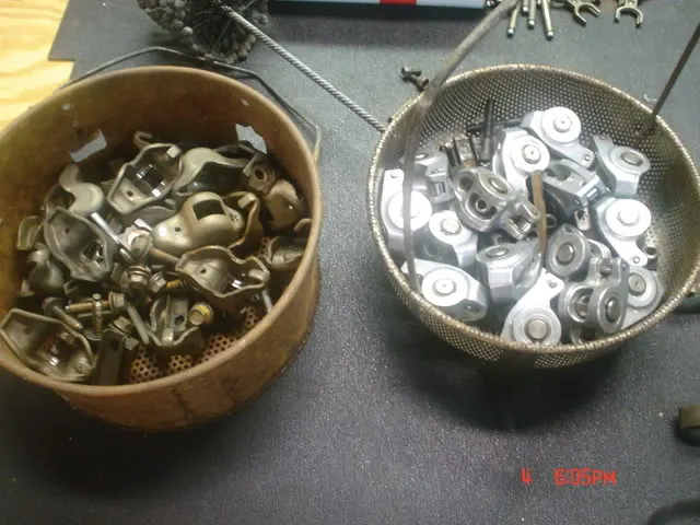

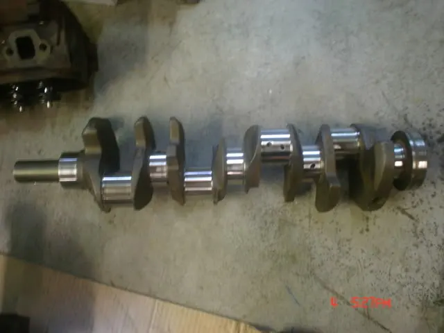

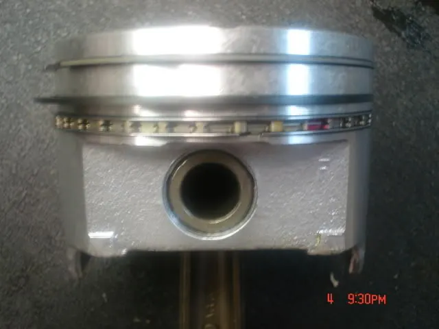

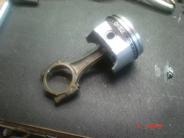

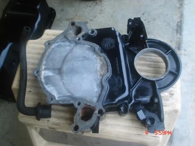

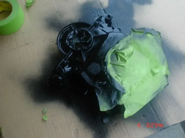

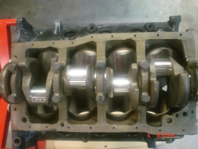

Took some new pics of some parts and what i got done today. Painted and cleaned the block, oil pan, and front plate. Then installed the main bearings, crank, and main caps...then torqued them down. After that, I put all the rings on the pistons. Also put the rockers on the heads...
AND put the new pilot bearing in the crank..which was a complete PITA!!...the old bearing wouldnt come out..i tried everything...even a slide hammer...finally i broke out the air chisel and chiseled that B**CH in two and pulled it out....then the new one i just tapped right in
Pilot bearing =
Crank
Old stock and new cobra rockers
Pistons and rods
Work done today:
Painting the block
Block fully painted
Front Plate
Oil Pan
Installed rockers on heads
Installed main bearings, crank, and main caps
