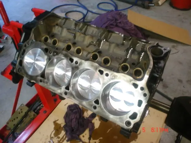

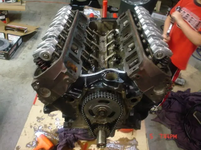

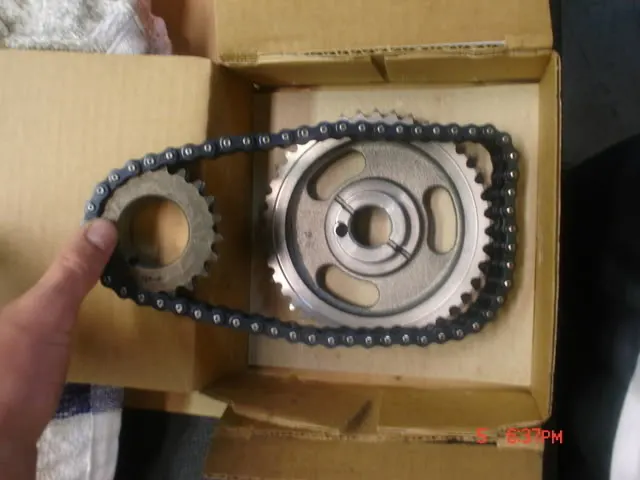

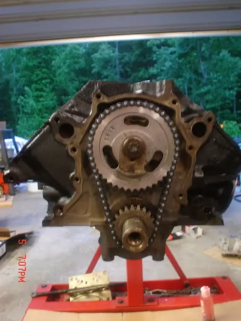

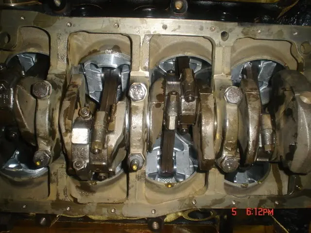

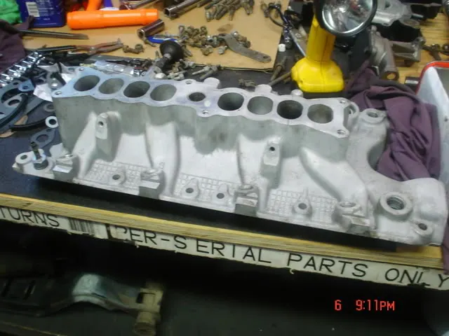

Ok....the past three days ive been working on it but have been to tired to get on and post pics..but im ready now.....

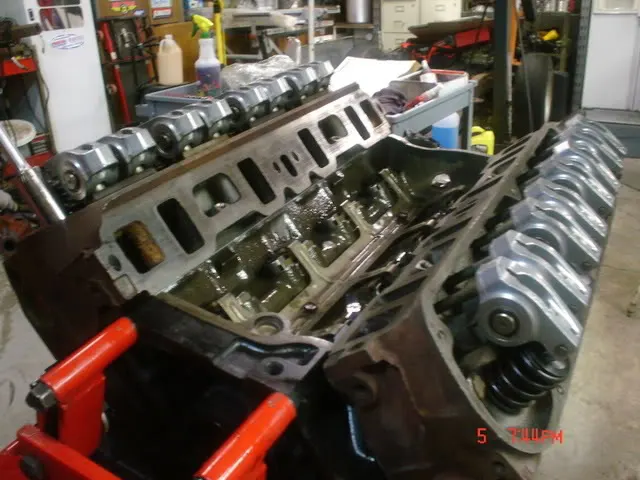

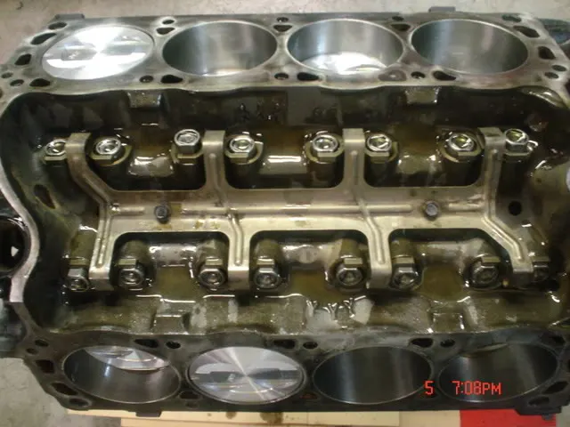

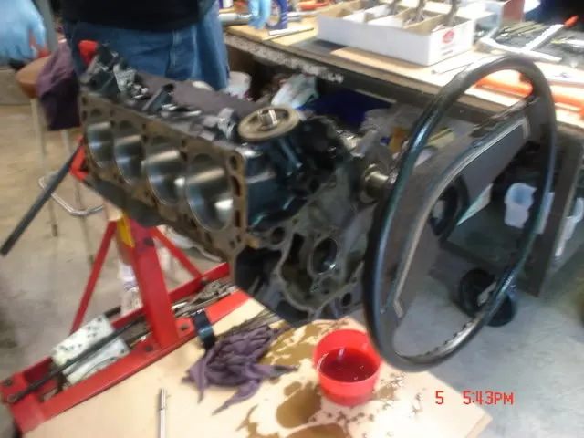

Tuesday: Pistons installed and torqued down. CamShaft, Timing Chain and gears, and Lifters installed. Then the heads, pushrods and rockers......then i called it a night

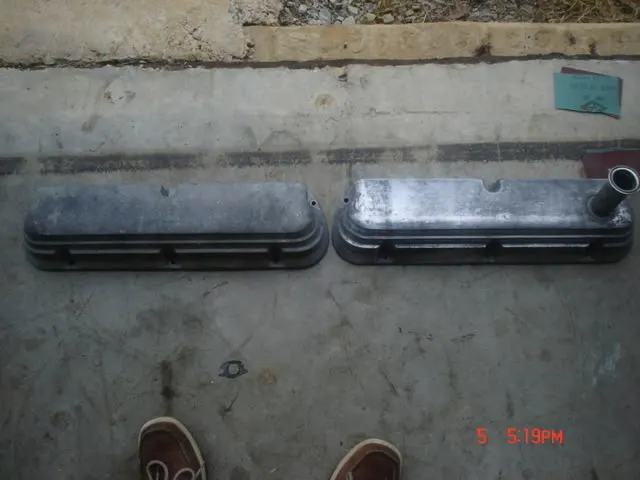

Wednesday: Sanded and painted my valve covers. Sandblasted lower intake.
Today: Not S**T...haha
Anybody see my declining work effort?...
But anyways......PICS!
Installing Pistons....note the chevy steering wheel....haha
Pistons in!
Cam in and lifters tightened down
Timing Chain
Heads, Pushrods, and rockers
Valve Covers...Left nothing..Right sanded down
Top painted, bottom nothing
Sandblasting the lower intake...
Left blasted, right side untouched....
Fully sandblasted and cleaned
