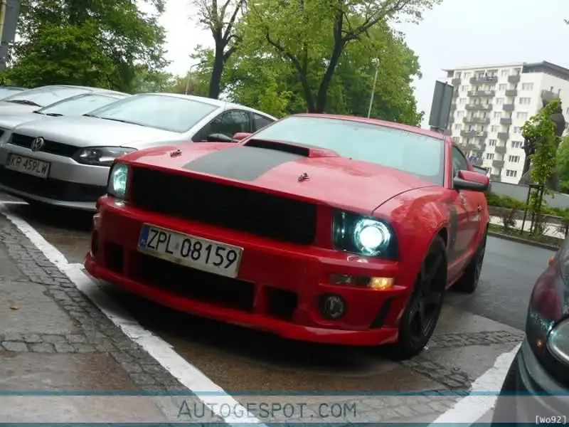

- I've never actually seen anyone with real projector HID's installed on his Mustang, except for this one:

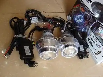

Another and easier solution, without cutting in the headlights would be a drop in, plug and play projector that fits into the original bulb fitting. (They are available for the Mustangs H13)
The idea is that you would only need to take off the lens (by heating it up, so requires some skill) of your headlight to plug this projector in.

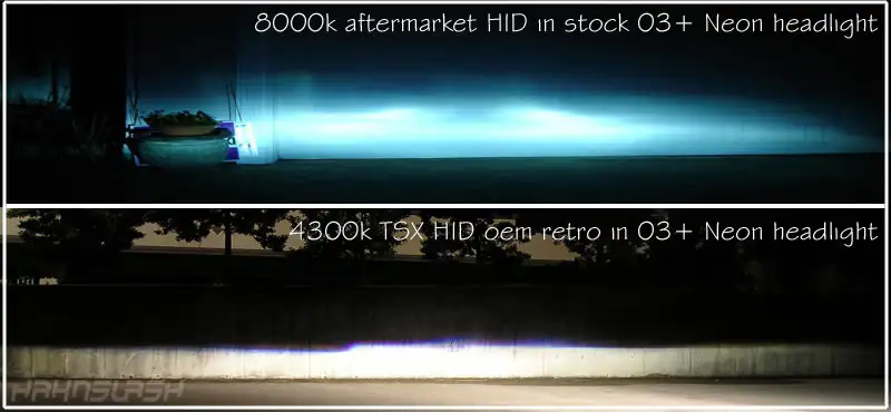

Glare is the main problem of PnP HID kits in stock halogen headlights. Example:
A very clear confirmation and explanation for this can be found here (also Mustang oriented)

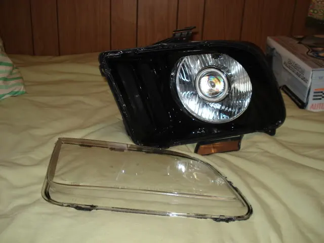

Retrofitting a projector would provide the best possible light output + light pattern. An OEM projector needs cutting the headlight, but if it's worth it, I'll be willing to do that. A PnP projector would be cheaper and easier to install. Thus, that could also be an option.

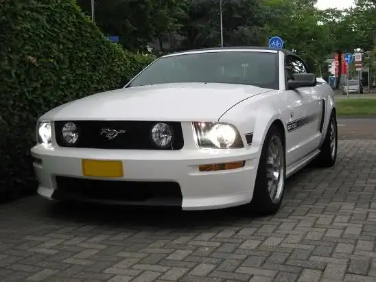

Well, an experienced mechanic did the install and here's the result:
Only the DIY guide I found earlier, didn't work for my '07 Mustang.
So the mechanic had to come up with some of his own solutions to make it work.
