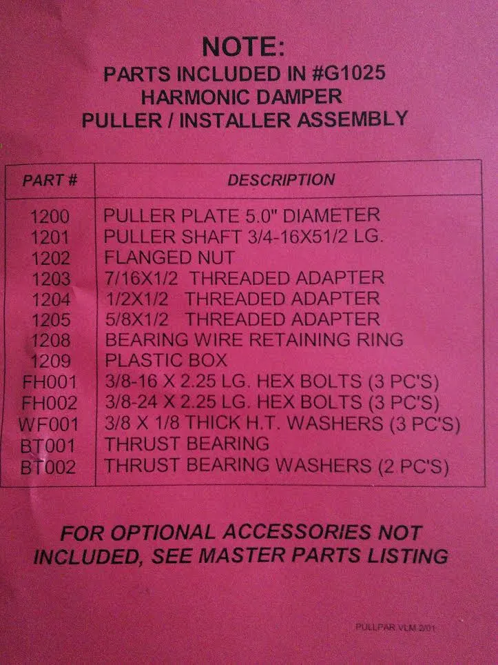

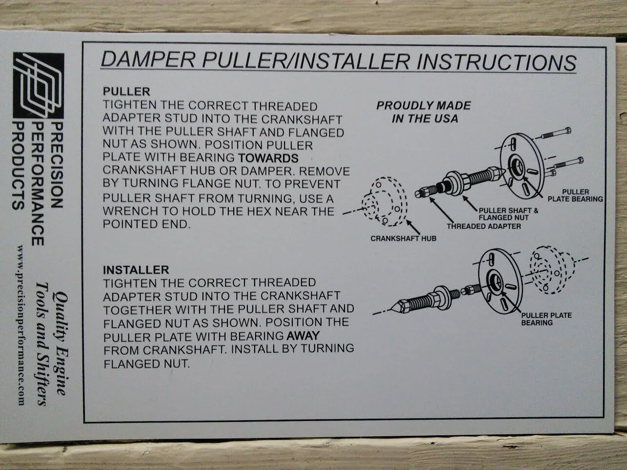

I bought this one in 2015...quality piece and made in the US.
I've only used it once since but it was worth every penny...besides I'm a bit of a tool junkie.
Mine is the Precision Performance Harmonic Dampener/Installer #G1205
not sure its the same one now, or that it's made in US, but here's what's on their website:
