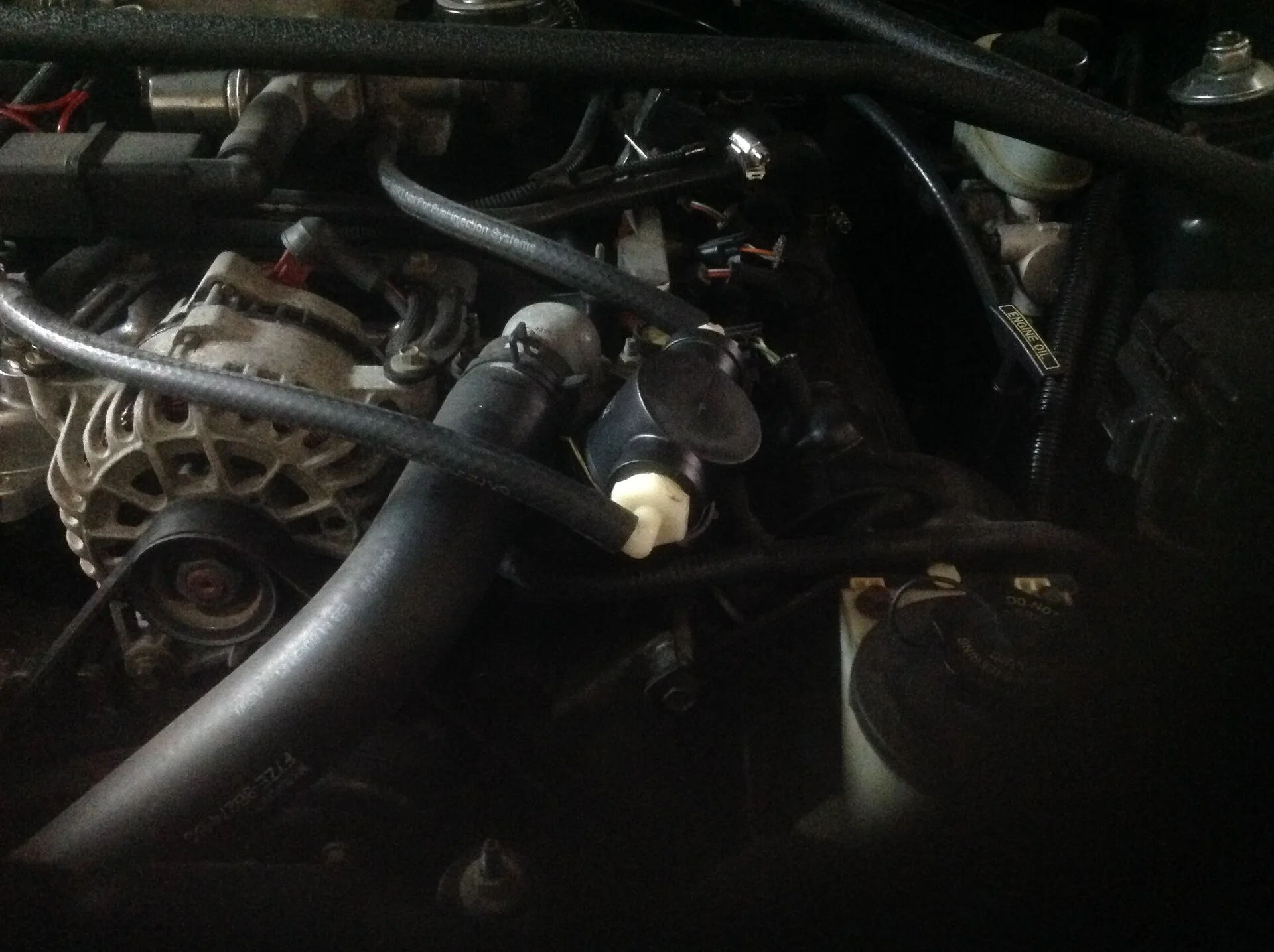

I retained the factory setup, but did place a catch can in the hose between the PCV and the intake. I spent ~$25 at Tractor Supply for a 3/4" Polypropolene Line Strainer w/80 mesh stainless steel screen and hose barbs. I stuffed a Chore Boy copper scrubbing pad into the mesh screen cage for some extra air scrubbing. Works great...collects abt a tablespoon of oil every 500 miles or so (throttle abuse dependent).
Thank you for the reply, I have a much better understanding of how the system works now. I am running a V3 supercharger and get oil in both locations. In the plenum and it pools right before the blower inlet in the coupling. I know with boost it’s a benefit to run a catch can. I figured with the stock V3 intake pipe and the driver side valve cover coming in before the blower I just assumed that it was pulling out of the valve cover. I wasn’t sure of the location or style for my set up. With mocking up a power pipe I wanted to make sure I didn’t leave anything out or put anything back not needed. By the way good design, saving money is always nice.
