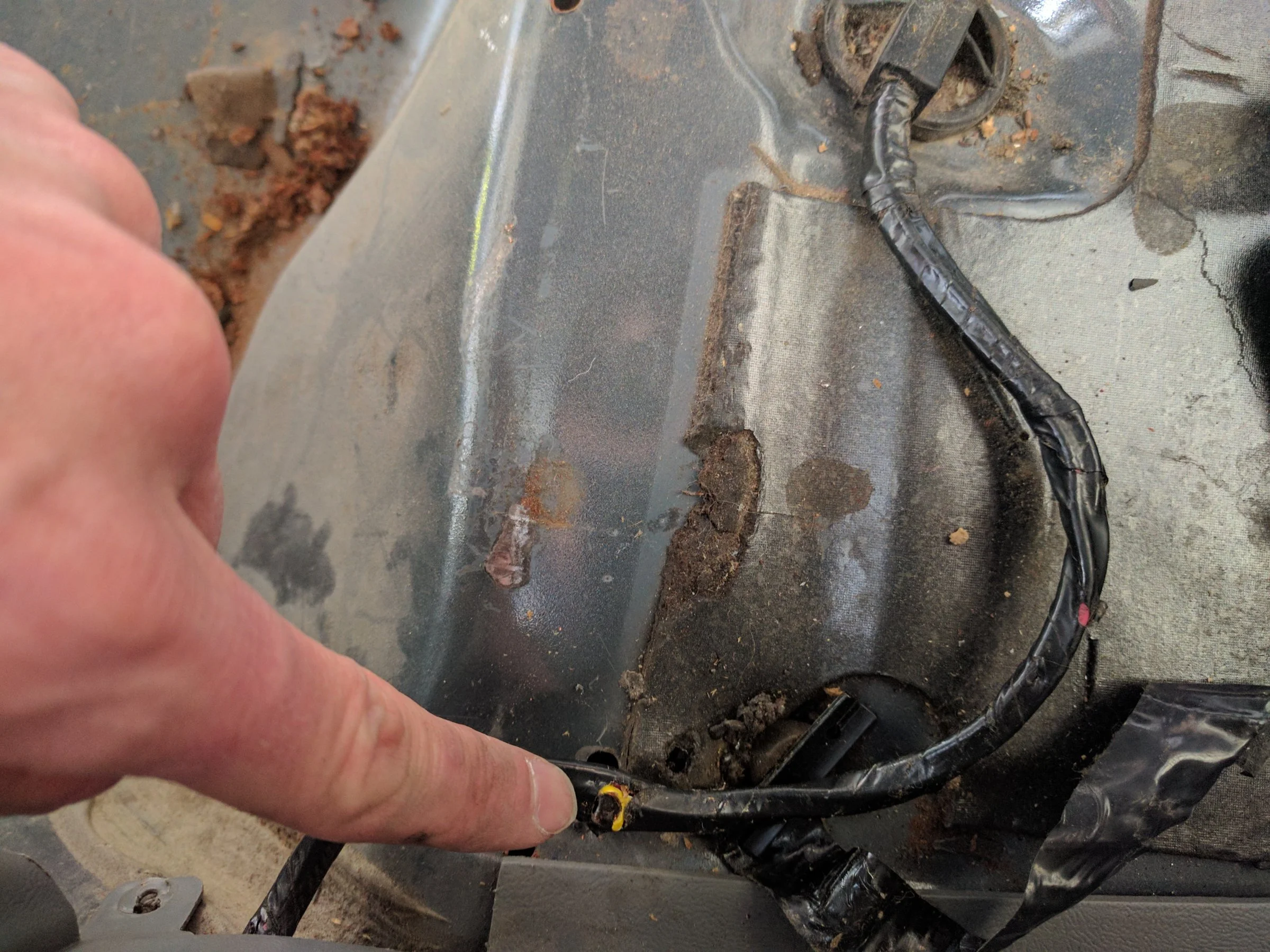

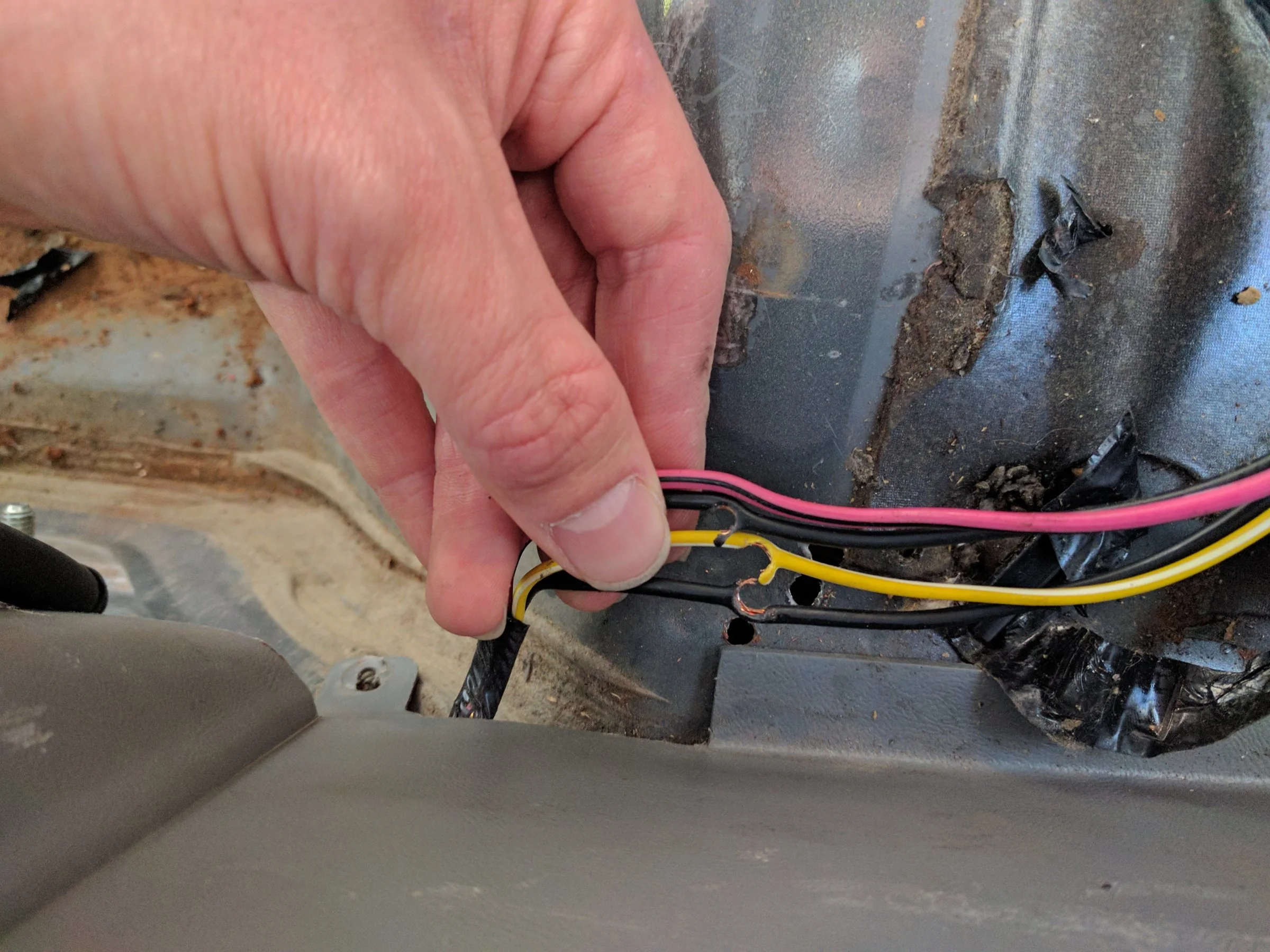

Most resent example; the car has had ground issues with the battery relocation to the back of the car. I ended up pulling out the battery and the jankity battery bracket in order to trace down the wiring job for the ground. Once I pulled the carpet back, I quickly noticed that the PO drilled right through the fuel pump/fuel sending unit wire harness.... The dude just drill the holes straight to the carpet without even looking at what was underneath it! Odd thing as well...the fuel gauge has never worked since I have owned the car. Fortunately I found the issue and was able to fix the wiring as well as fixed his inaccurate ground wiring job for the battery. Pictures below for your enjoyment.
