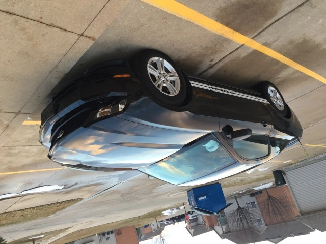

I just picked up a 2012 Mustand and I love it! Pull the trigger, man!
