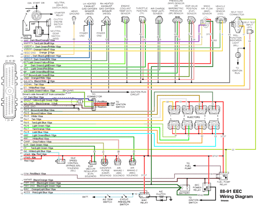

67 Aint nothing. My check engine keep turning on and of while driving so I pulled these codes. What are some symptons of these codes?

Wiring diagrams for the proper model years are next…
For 86 models see http://www.autozone.com/images/cds/gif/large/0900823d80167158.gif
For 87 models see http://www.autozone.com/images/cds/gif/large/0900823d8016715e.gif
For 88 models see http://www.autozone.com/images/cds/gif/large/0900823d80167162.gif
For 89-90 models see http://www.autozone.com/images/cds/gif/large/0900823d8019595f.gif
For 91-93 models see http://www.autozone.com/images/cds/gif/large/0900823d80195960.gif

Code 85 - CANP solenoid - The Carbon Canister solenoid is inoperative or missing. Check vacuum lines for leaks and cracks. Check electrical wiring for loose connections, damaged wiring and insulation. Check solenoid valve operation by grounding the gray/yellow wire to the solenoid and blowing through it.
The computer provides the ground for the solenoid. The red wire to the solenoid is always energized any time the ignition switch is in the run position.
