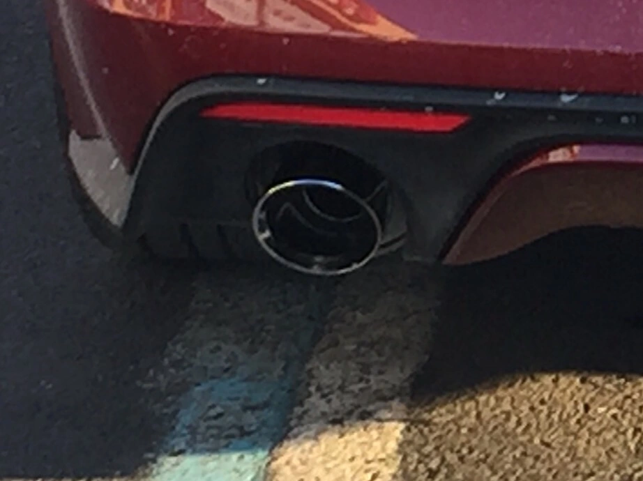

Installed the Roush Axle Back this morning. I'm very impressed. First I ordered from CJ Pony. They shipped the same day and I got it as scheduled. The packing was great and the item arrived perfect. The quality was outstanding. The tips must have weighed 4 pounds each and the chrome was exceptional.
I was not prepared for what I heard. This exhaust woke up the beast. The tone was deep and powerful. When getting on the throttle I thought I was in a finely tuned street race car (Which I am). Their was no drone at any RPM. Its louder than I thought but vey livable for a daily driver. The car is very well insulated so its not overbearing when the windows are up. But let me tell you I was driving around in 15 degree weather this morning just listening to that sweet, sweet sound that is Roush Mustang.
I highly recommend this system, and if you want more, just add the ford X pipe...

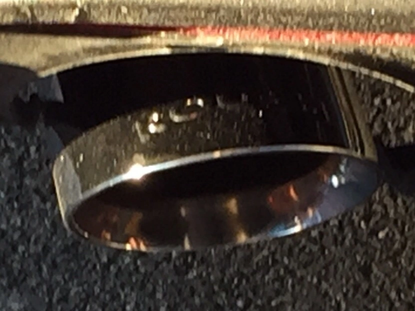

Sorry I only have a tail pipe pick for now. When I get a chance I'll take more pics and around video (it will be from my iPhone as I have no other equipment)
also people should be very careful with the cut. If you do too much the tips will be at an angle.
