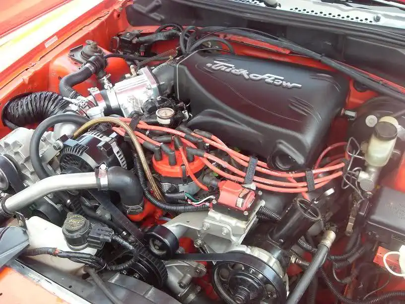

The car now starts and idles better than it ever has since the 331. I drove it to our track rental, but didn't get to run the car. Once I start hitting boost the elbow starts leaking air and leans the car out. I finally broke down and ordered the Vortech elbow and picked up new couplers and T-bolt clamps from work.
Here's what it looked this past w/e:

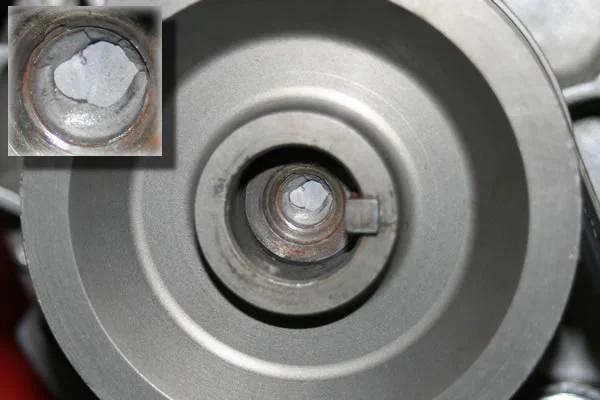

i've had my bracket pivot bottle strip out on me but never actually break the pulley bolt. are they going to do anything for you?
They are sending me a new retaining bolt kit. I had just bought the kit from them a week or two ago. I'm guessing the metal in the bolt was bad. It has different colors in it and it kinda chunked as I drilled it.
I had the bolt out in 20 minutes or so. I couldn't get an easy out to start, so I kept binding up a reversed drill bit to get it to spin out. I did eventually break the end of the bit off, but the bolt came out. LOL
Because of the holiday w/e.... I won't get the new retainer kit for a week. We are in the middle of trying to move too. Ugh. I may have to drive the car the 25 minutes without the blower belt on... or try and make a retainer. I have the specs on the bolt, but not the retainer. If I have time, I might try to make one and guess on it's thickness.
I drove the car 2 hours without the bolt in it. I noticed there was a new vibration, enough of one I thought the bearings were going out in the supercharger. So I guess this is BETTER news than that would have been.
