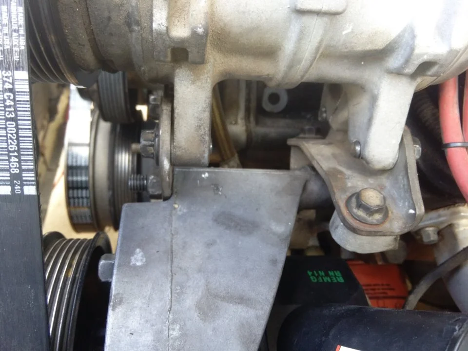

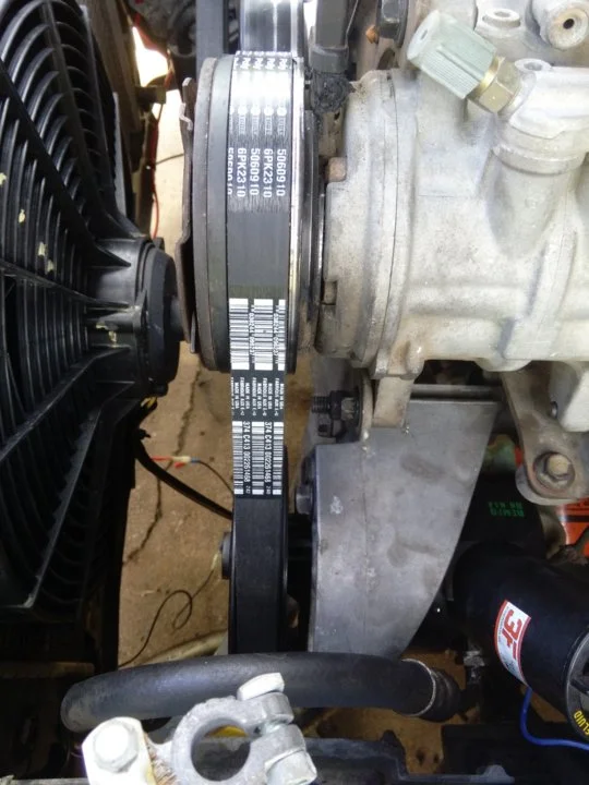

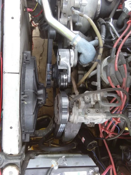

I don't know how well these will show anything. The belt will walk back on the a.c. pulley within 30 seconds of starting.

Take a straight edge, place it on the crank then move it to each pulley, that will tell you which one is out of whack from the crank.

You can use either a laser pointer, straight edge or Gates sells a kit with a magnetic laser eye and another alignment piece. Could be the person did not install the PS pulley correct.
