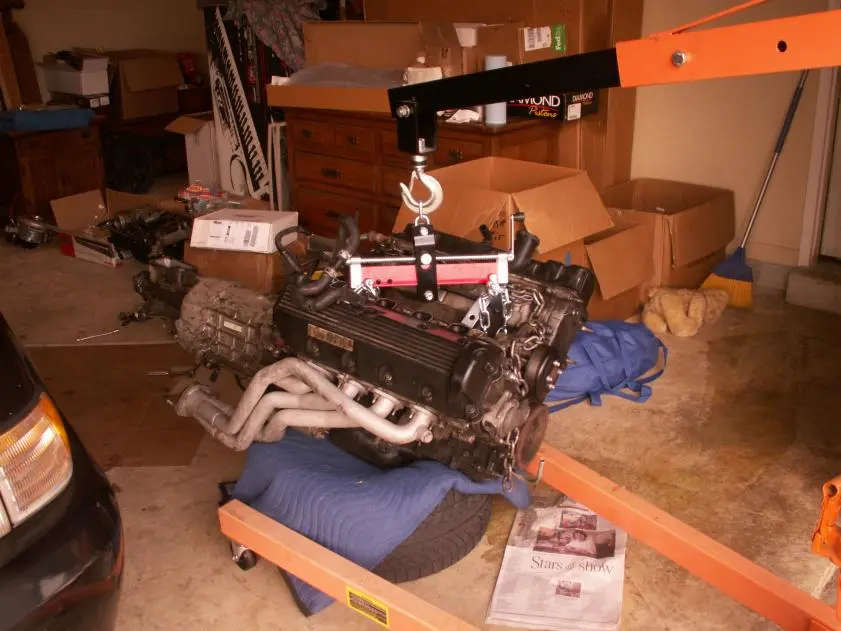

Yeah its possible, I've done it a few times. You have to make sure that your AC lines are out of the way or they will get caught on the primaries.

Yes its possible, my buddy and I did it last night.
