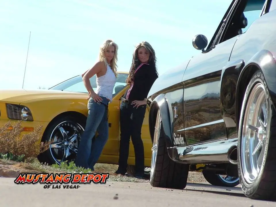

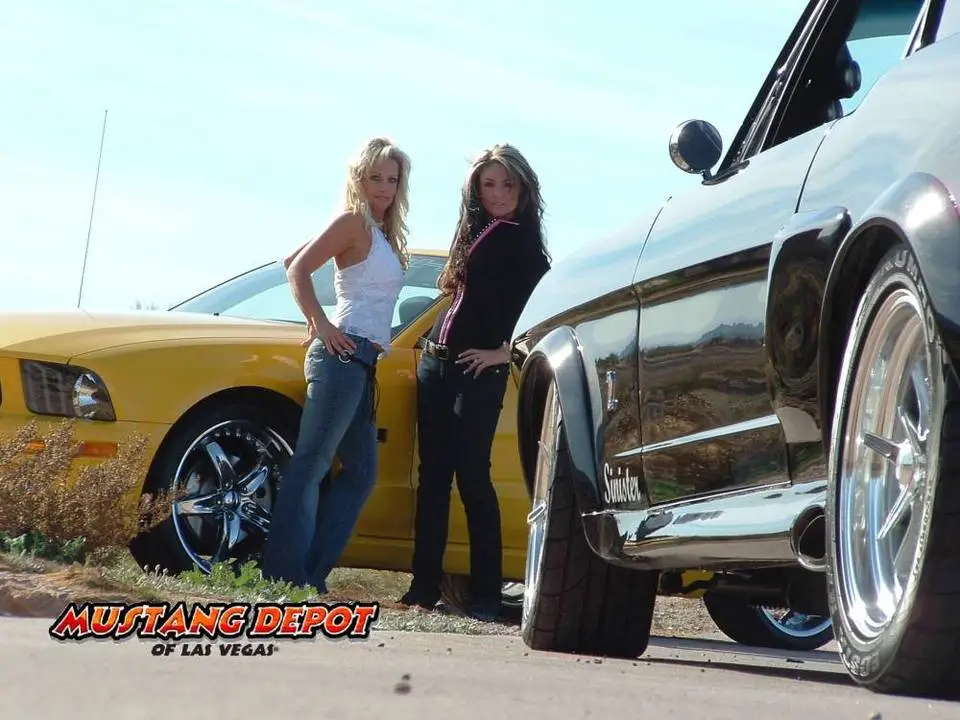

I actually did a little wheelhouse work on the inside. Currently I have 17x9 with a 5" backspace. But since the wheelhouse massaging, I could use a 17x9.5 and easily put that on the inside ie 5.5 bs.
This is with the 275 on a 9"

did you ummm ranch those.....ummmm bunnies lol. J/K.
The problem I have is not really the width of my tire but how tall it is. If mine was 1/2 inch shorter I would like it better. I'm hoping with mickey supposedly comeing out with 255/60/15s that it will bring it in just enough to clear my outter fender lip. And I know I could roll it but I'm thinking the bondo would crack! :notnice:
