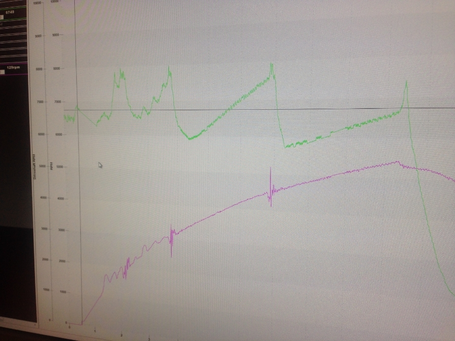

Log Graph

the "waa waa waa" in 1st in 2nd... at first when looking at the data I thought maybe tire slip, but hearing the video made me thing of axle wrap/bushing deflection... since it's all solid, my next question would be regarding motor/transmission mounts.

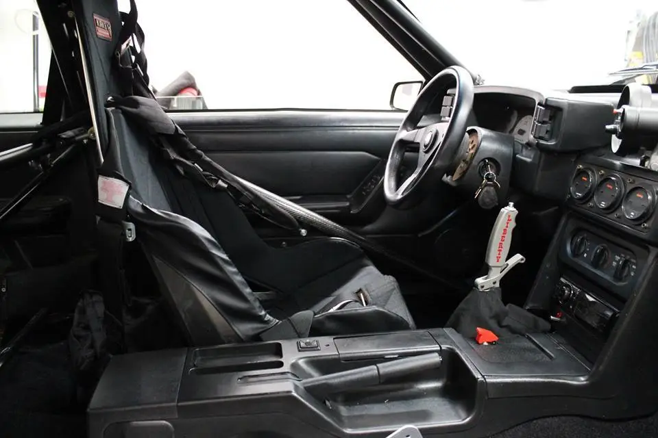

shifter moves from first to second straight back, when you go to third it is straight ahead again, but the shift mechanism is set so that it drops on its way to third, then straight back again to fourth... think of it as a H on its side... to get back to second you physically release a mechanism and pull the shifter back up to the first/second gate.
pretty slick.
The transmission is clutch assisted, i could shift it clutchless if i interupted the rpm(hit the 2step button) on the gear change but that would cause a bunch of wear on the transmission.
A v-gate shifter is a vertical shift pattern, basically just go forward and backwards with the lever for each gear.

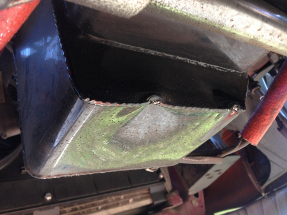

Day 2, this would be the most “interesting” day of dragweek for us… We get to the track, and as usual, indy is off the hook, track is killer. We unload quick and hit the staging lanes early, I get the car up on the 2step and let the clutch go, before I know it I am on the limiter, shift second, straight to the limiter, shift 3rd, holds for a second, then right to the limiter. By this point I realize the run is junk and abort it. We head back to the pits, and decide to add a lever. As we are jacking the car up, I see the car move quick and codriver Tim is using some colorful language… :leghump:, I already knew what happened, dropped the car on the oil pan! I grab a second jack without even looking at it and get the weight off of the pan, put a jackstand under the car and take a peek at the pan, and see it isn’t leaking oil. Phew, dodged a bullet there. I called up my engine builder to see if we were screwed or not, he tells me that by the looks of the pictures it is nowhere near the oil pump, we dodged a major bullet with that one.

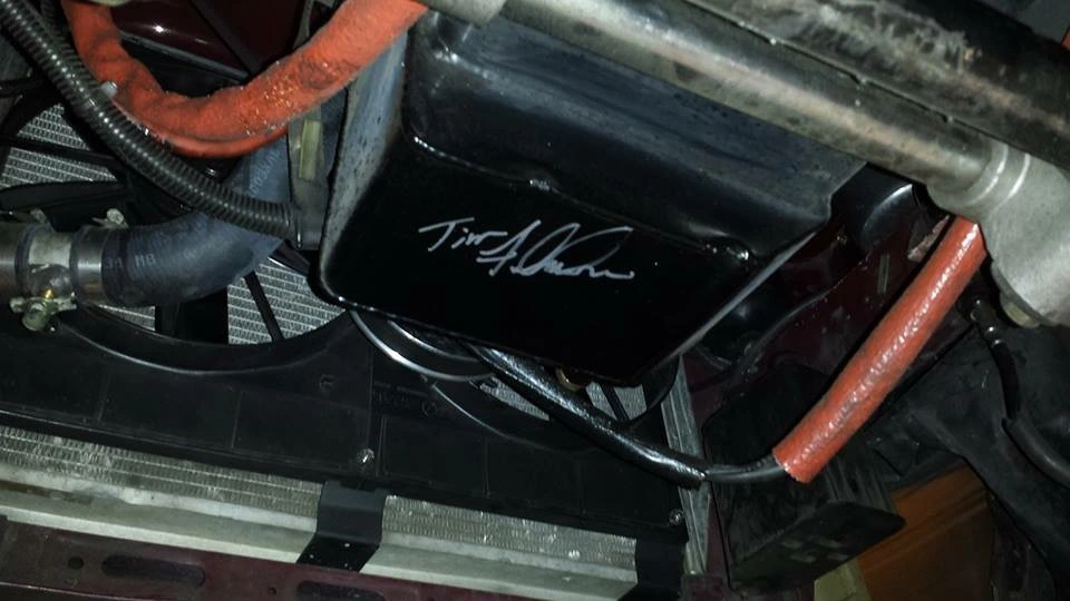

Tim was nice enough to sign the pan for me later in the week when he was doing a oil change, haha.
So after I talk Tim off of the ledge we put the levers on it and go back out for another pass. 9.903 at 136mph, the track at indy was so tight im sure it would have run better with a 3rd lever on it, but after the morning we had we packed it up and hit the road.

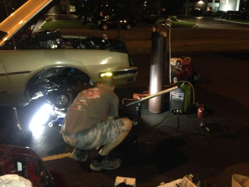

We left GLD and headed to the next hotel, the drive was pretty uneventful, the hotel that night was insane though, there were guys mini tubbing cars in the parking lot, welding suspension parts, doing maintenance, testing two steps, it was pretty wild.

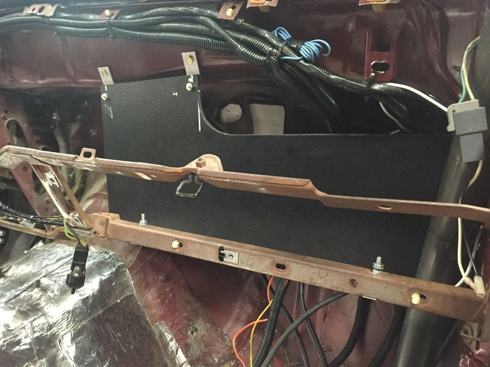

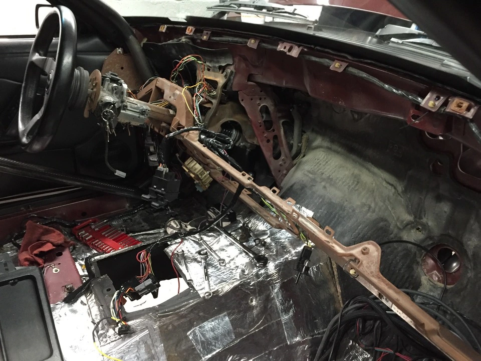

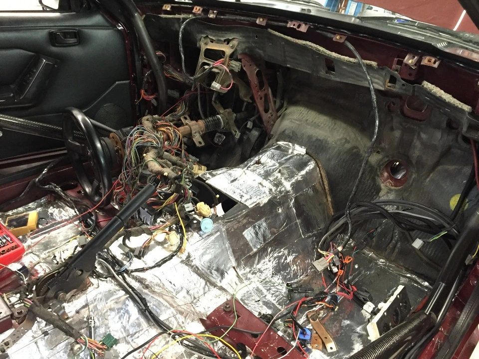

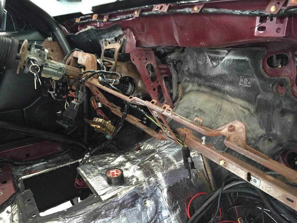

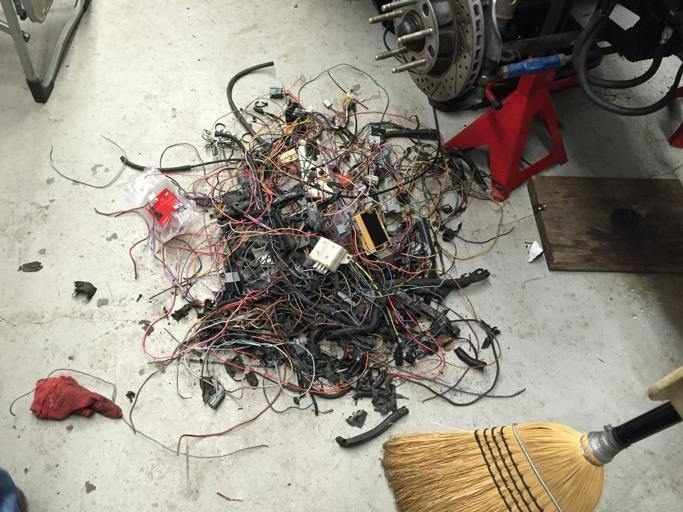

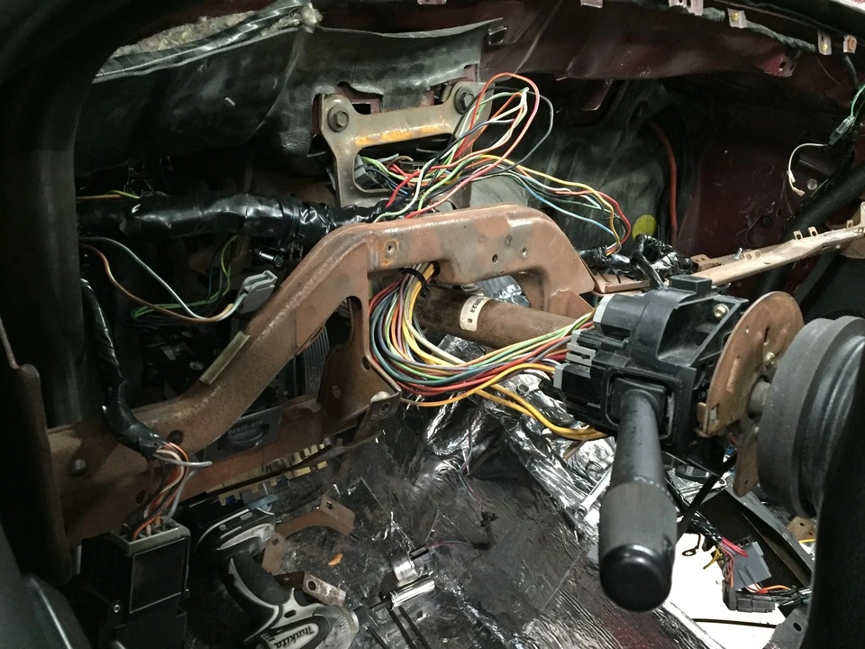

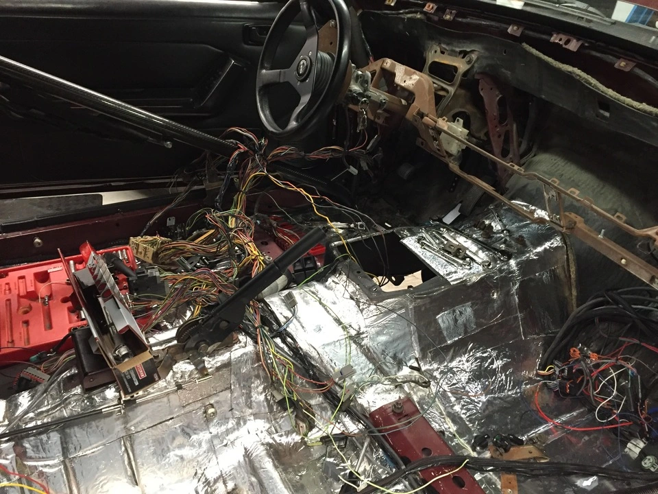

I have been working on rewiring the car and getting some weight out of it. Goal was 150 pounds but its looking like its more like 100 that will actually come out. Took the factory heater box out, replaced that with an aftermarket electric unit that will be used just for defrost and the footwell area.

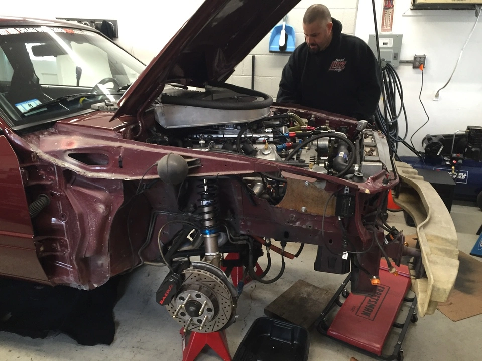

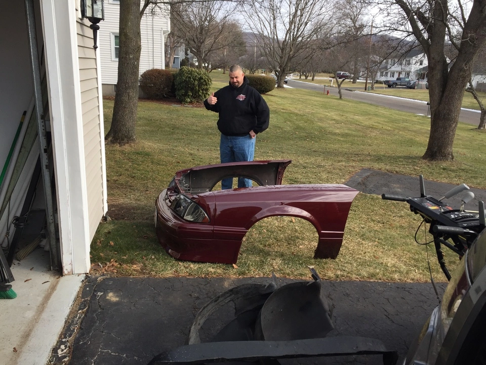

Started by taking the front end off to make some room.
This is my buddy mark from jerzey in the pics. He pretty much made all this happen, he is very good at figuring all this stuff out then turning it into a clean finished product.
This is the mess we started with.
One of the piles we made, this wasnt all of it, about 15-20 lbs of wiring was removed from the factory harness.
Making progress on the factory harness.

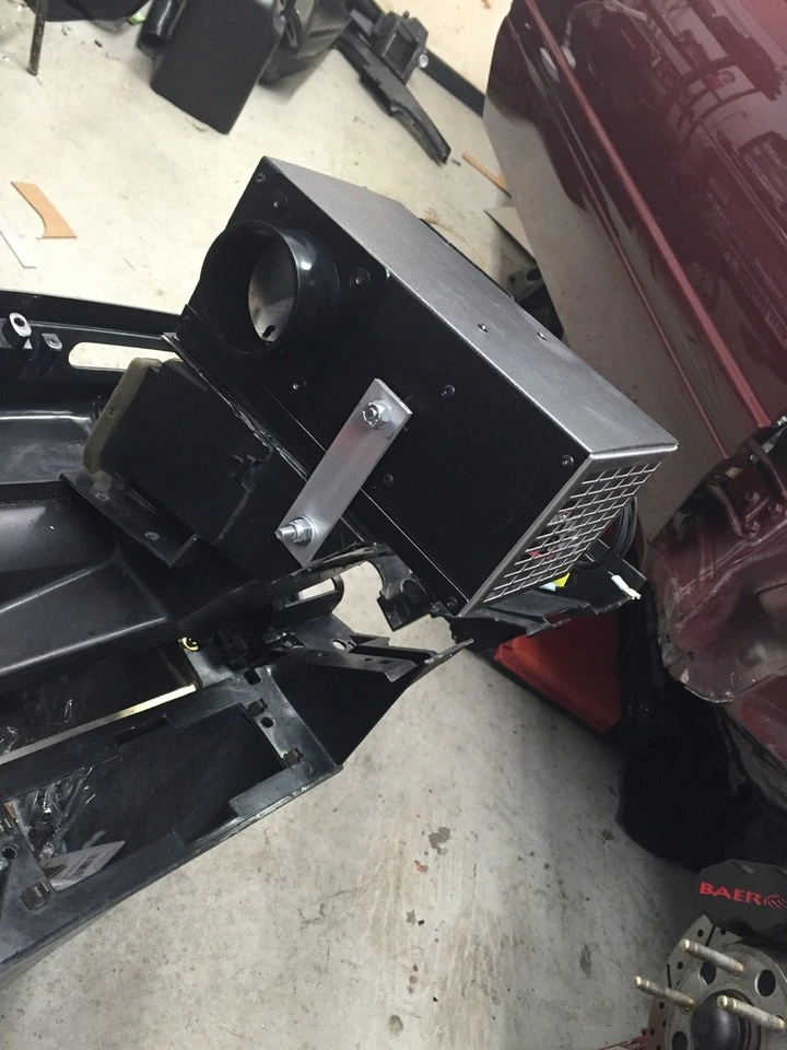

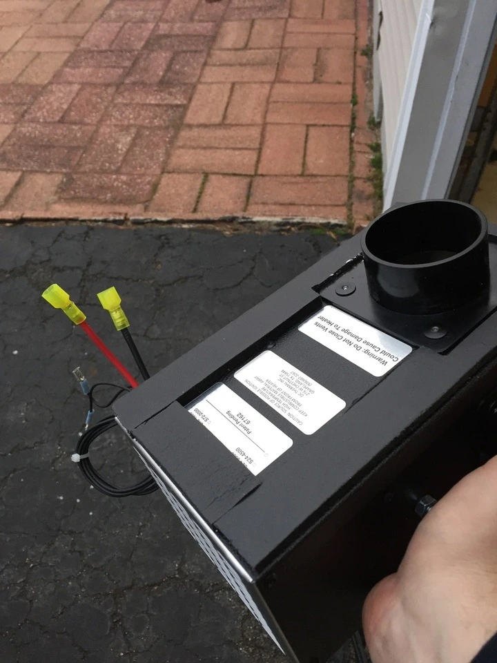

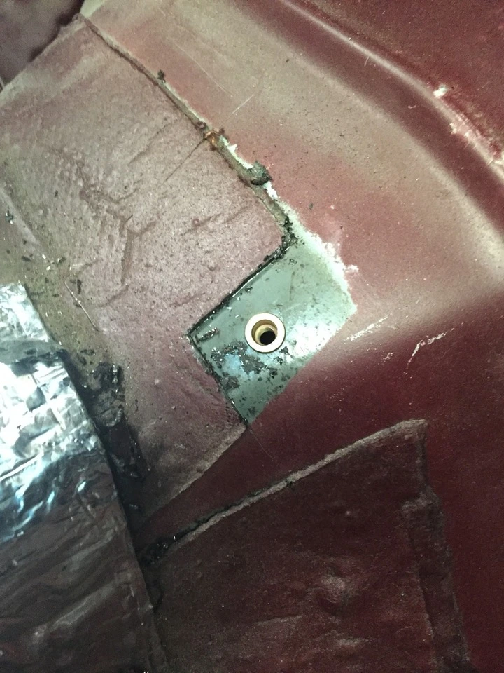

Onto the heater, i bought this from sports imports LTD, had to cut it up a little bit to make it work but i am happy with the final product and it tucks right up under the dash nicely.
Made a plate and riveted it to the factory ductwork where it meets the factory heater box, then siliconed everything together before the rivets.

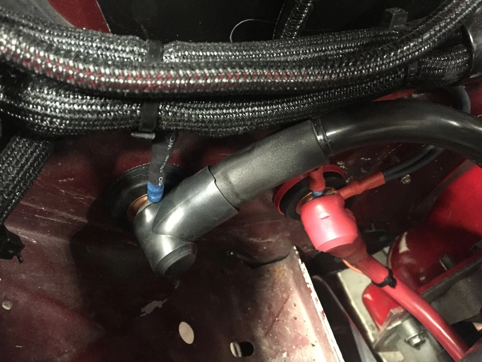

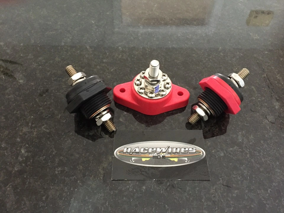

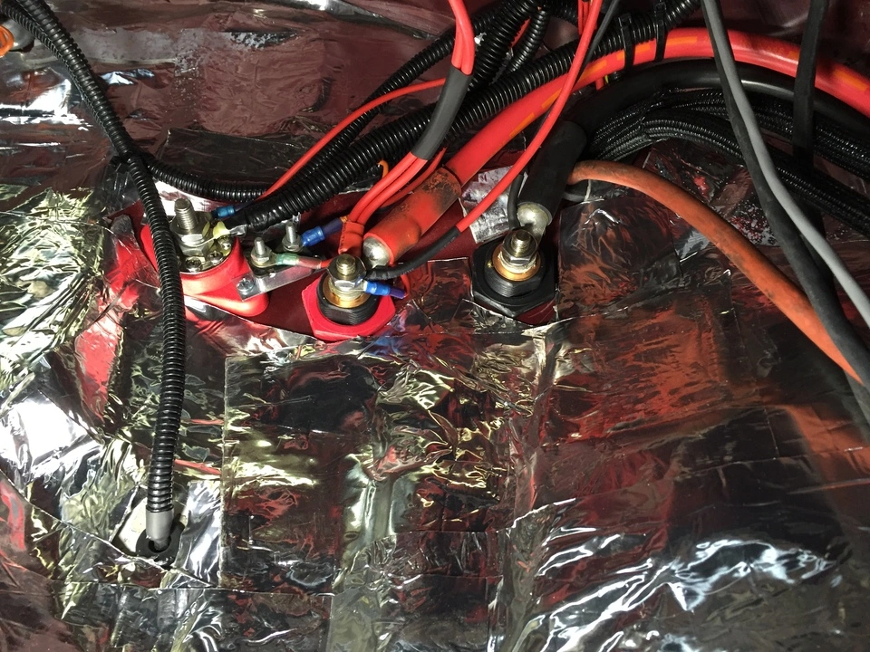

Now onto the new stuff. Got these bulkheads from racewires.

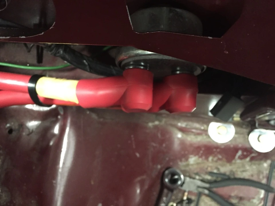

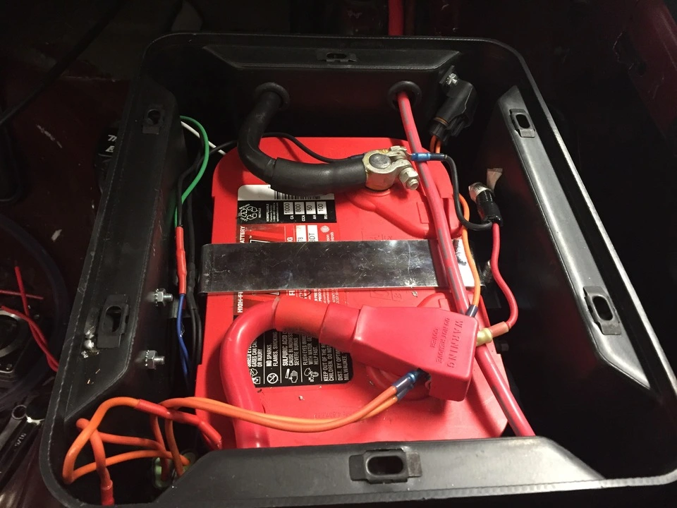

Also ran all new cables and added a moroso battery box.

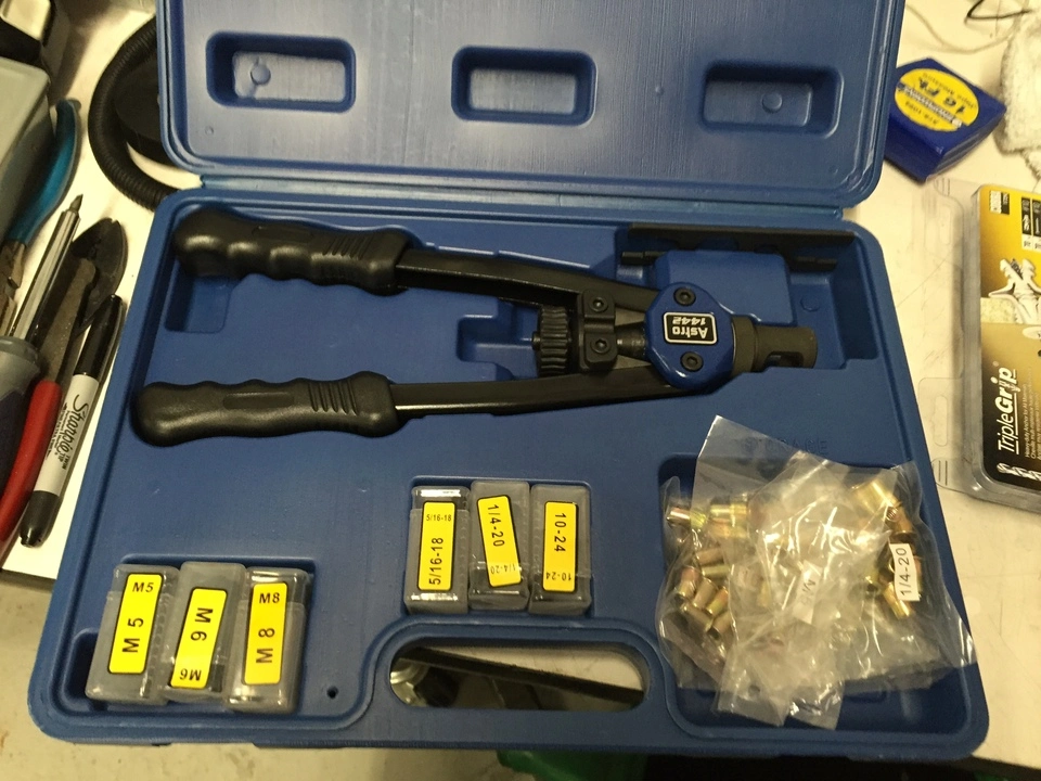

This tool was also a lifesaver, allowed me to mount a bunch of stuff without having one person under the car holding onto a bolt so it wouldn't spin on me.

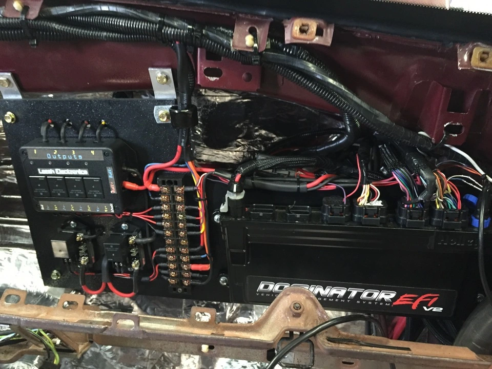

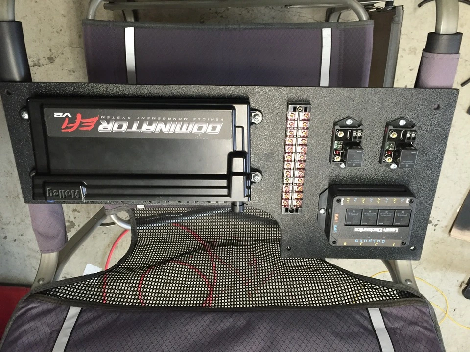

Here is the panel that controls the starter, horn, fuel pumps, electric fans and the EFI. The relay boards are from Leash electronics and they are pretty badass
All wired up, again, Mark does some amazingly clean work.

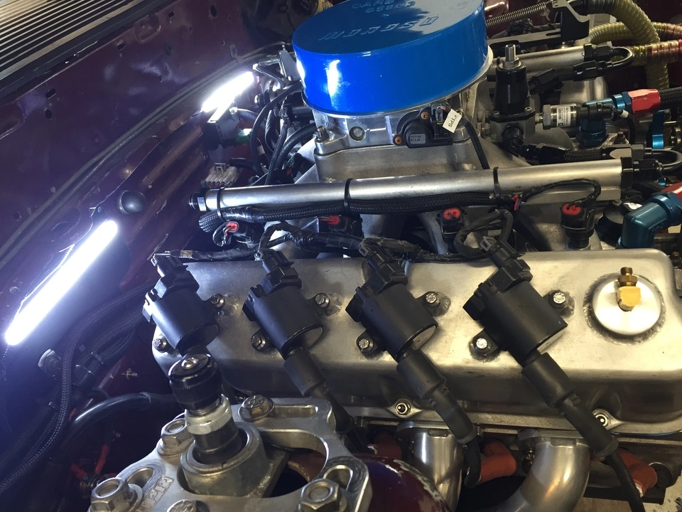

Also added some underhood lights and a starter bump button to make the late night, hotel parking lot vavletrain maintenence easier.

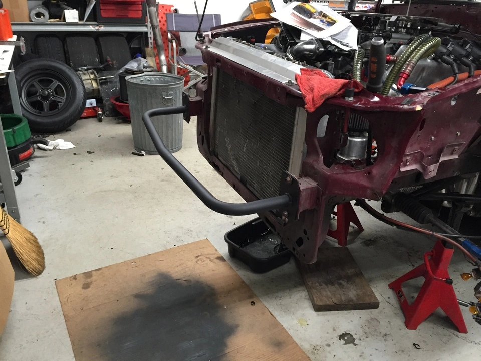

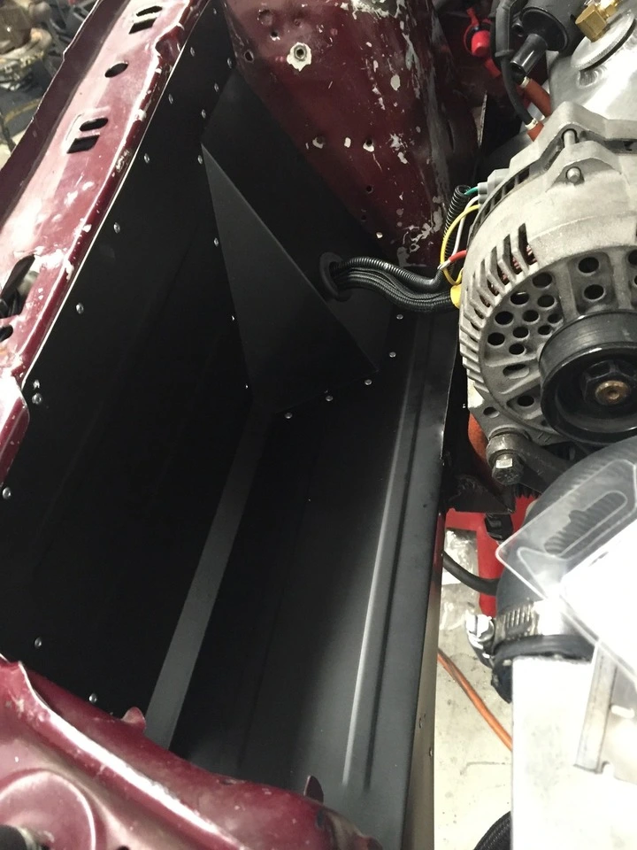

After all the wiring was done there is little to nothing left in the engine bay, this magnified how crappy my innder fenders looked so i ordered a set of scottrod aluminum panels to put in until i can get the engine bay fixed right.
Here is the front bumper support from Donathen racing. Tim does some great work and this thing was at my doorstep like 3 days after i paid for it.

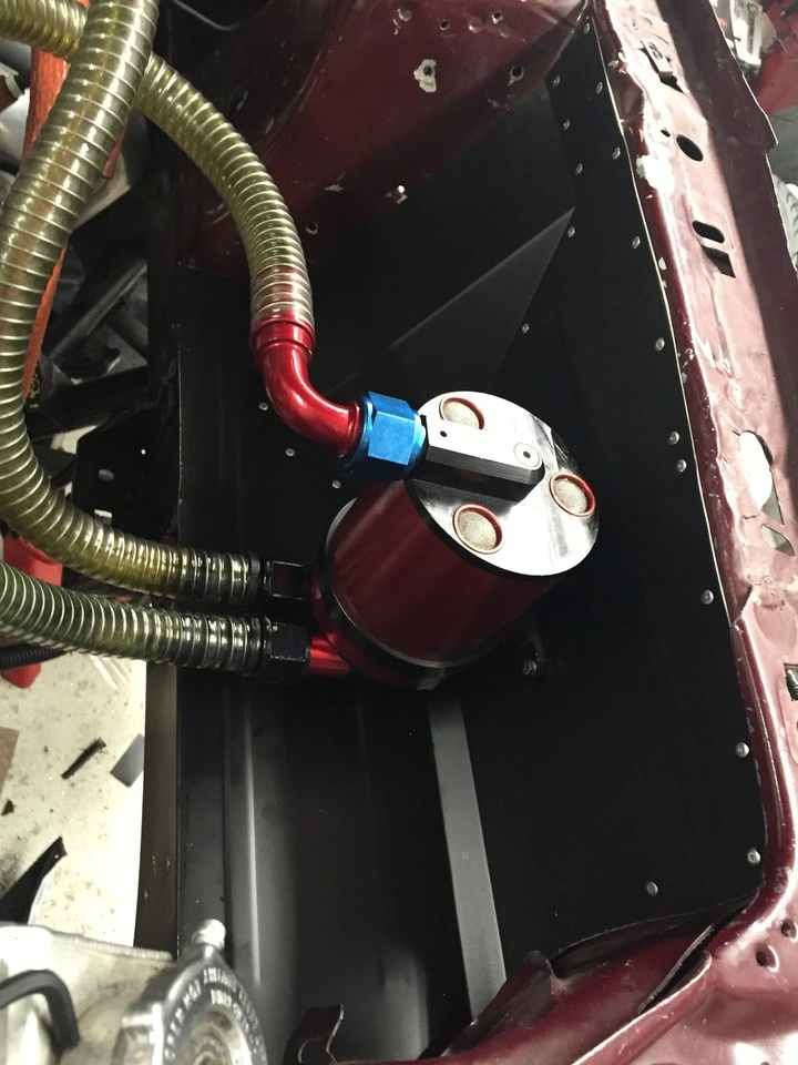

Next order of buisness is the fuel system. I am waiting on the lines and fittings i ordered , here is the tank, from Chris at Behind Bars Race cars. Cant say enough good things about Chris, his fab work is amazing and he has the best baffling system in a sumped tank on the market. Sent him my holley pump, filters, and brackets and this is what i got about a week later.
