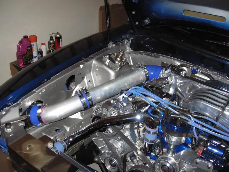

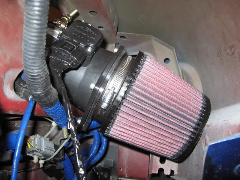

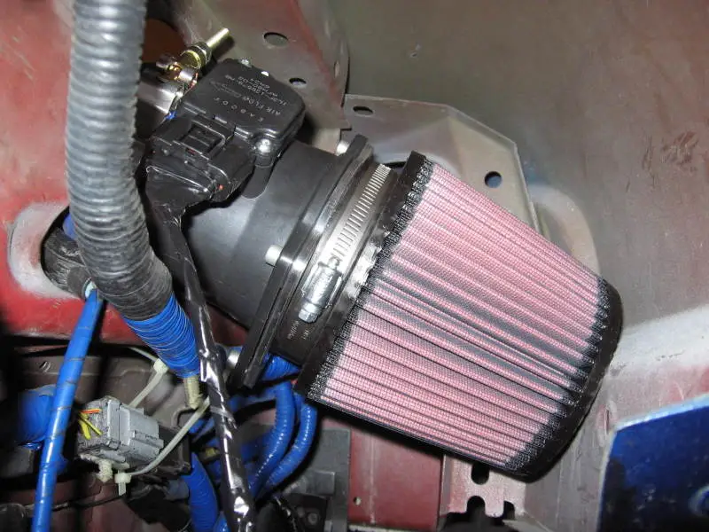

Just wondering if it would mess up my LMAF if I drill a hole in it for the IAT. I decided on where I'm going to mount the meter and filter....
Inside the fender...
If it's alright to put it in the MAF, I won't have to run the IAT wiring into the engine compartment.
Thoughts?

My gut tells me not to do it, but if you can drill into the housing without it cracking or such I don't necessarily see a problem either.
I'm not sure how the housing is built, where the sample tube ends, if there are layers etc, so drilling might ruin the housing, I honestly don't know.
But like I said, I wouldn't, maybe someone knows more about the housing designs?
The only problem is
#1 the housing is not very thick, so tapping the threads will not be easy. You will be lucky to get maybe one or 2 threads.
#2 the maf works by using a simple ratio. the air that passes through the sample tube is x percent of the entire housing. With the sensor installed, it will change the entire housing's flow. Essentially, making the maf think it's getting more air than it is, and thusly a rich condition will occur.
#3 Since the computer doesn't calculate a/f at WOT and/or open loop, it will be affected. How much? I don't have a clue.
#4 You would really have to make a standoff of sorts, since the sensor has 1/2" of threads and most of the body of the threads would be inside the maf, creating a lot more turbulence.
All is possible when you set your mind to it. If you were serious about it, you need to make a standoff and tap threads onto it, and glue it to the maf; Only the "V" and the element need be in the airflow path. They make glue specifically for plastic, one that actually eats away at the plastic very slightly, making a very strong bond.
After it's installed, you need to get hooked up to a wideband and test to see how much it has affected your a/f. I can only guess, but if you put the sensor at the back of the maf, behind the sample tube but across from it, I would guess it would have the least effect there. Then the wake left over from the sensor would not affect the sample tube (so I think anyway).
Another idea would be to extend the pipe that the filter attaches to, so you have some area of pipe (non-visible) that you can attach the sensor to instead. I think that idea is a little better.

From my research on MAFs it wouldn't be a very good idea. They are very sensitive to intake bends and such, so I won't want to run a risk of the IAT sensor affecting the MAF in any way. As you probably know the MAF is one of the most important sensors in the way the car runs and performs, althought they all work together, the MAF is one sensor that you don't want distorted readings. I wouldn't do it.
Scott
I wish I had more room in the fender, but if you look at the second picture, you'll see the filter is right up against the fender.
I guess I'll just drill into the pipe and try to keep it as non-visible as possible.
Thanks guys.
